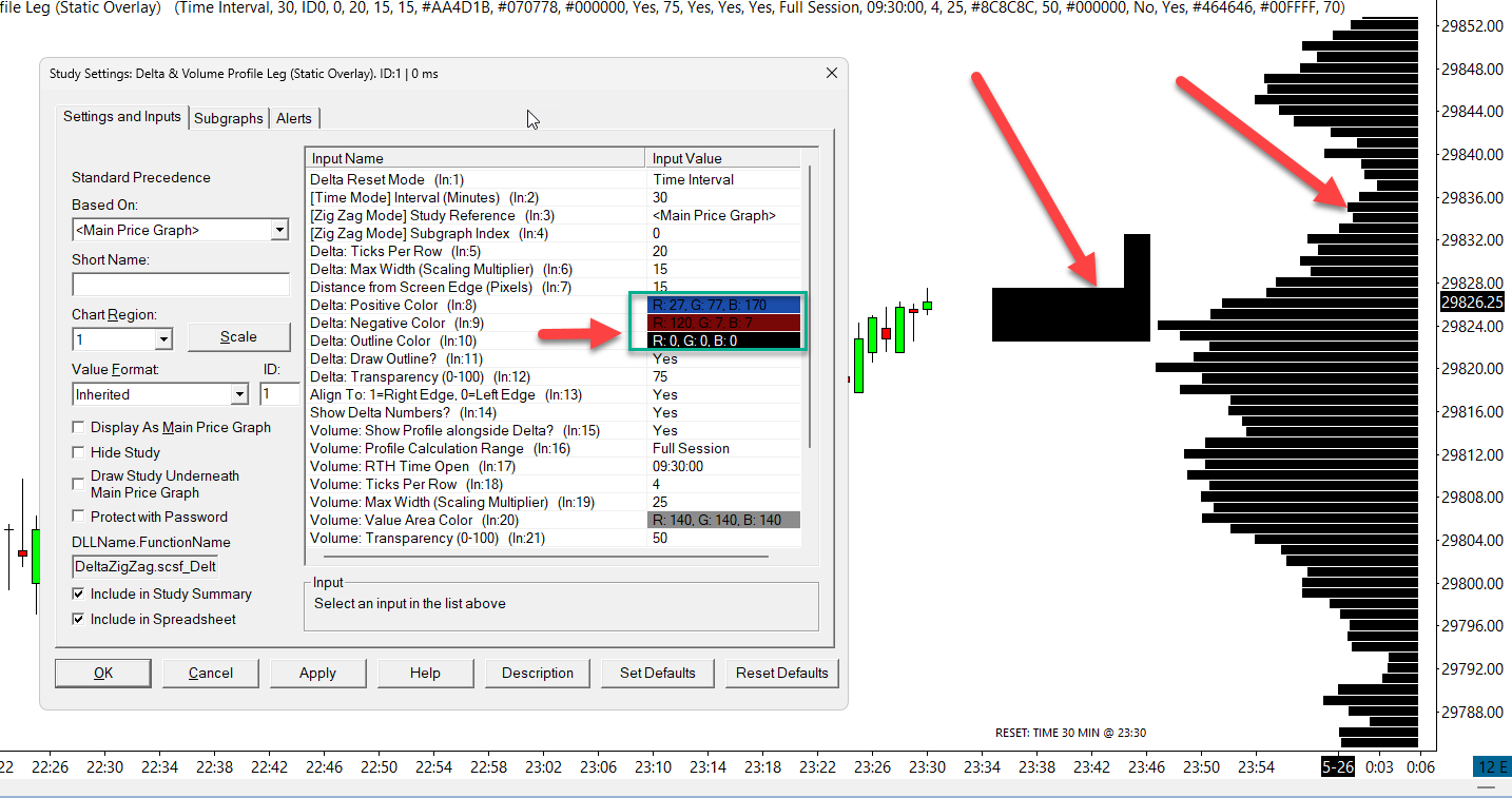

Hello Support,
I have a third-party custom study which is not reflecting the change or modification of any colors from subgraphs or input parameters on the chart. I am able to modify the colors and any other values from the input parameters or study subgraphs, and they look correct and valid on the settings. However, they are not reflecting on the chart and all colors on the chart for this study are black (please see attached screen shot).
I have tested this thoroughly and even added this study as an only study to a brand-new chart to eliminate any possible conflict or chart corruption. Same problem - I am able to modify colors on the settings and they look correct, but on the chart all colors are still black.
I have tested this with Global colors turned ON and OFF - same problem.
I am running Sierra v2908
I strongly suspect this issue is local to my installation of Sierra because same chartbook opens without any issues and works correctly on 2 other separate machines for two different users.
Could it possibly be a setting on Sierra that affects this?
Date Time Of Last Edit: 2026-05-26 04:32:28
image2026-05-25_23-31-04.png / V - Attached On 2026-05-26 03:54:28 UTC - Size: 118.68 KB - 125 views

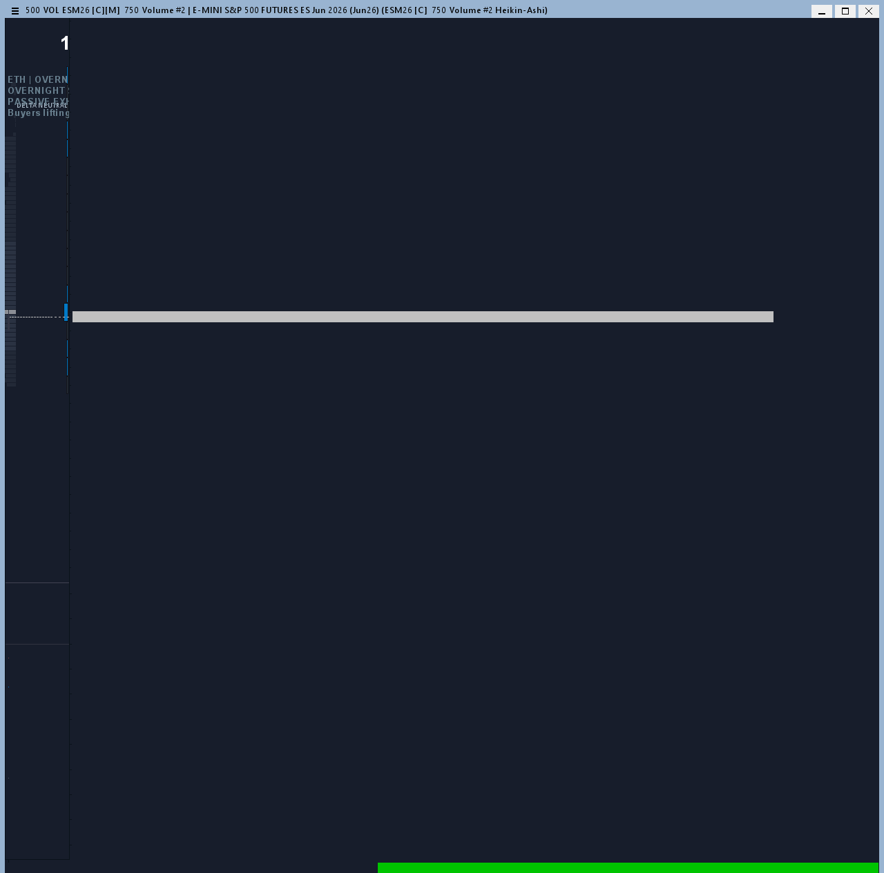

However, after your recommendation I have turned it ON and the chart that was experiencing a problem described above started to work correctly. However, all other charts in the same chartbook that worked correctly before became completely misaligned and even the vertical scale on the right has disappeared. It looks like the entire chart area has been moved to the left and there is a huge empty area added to the right side where the price scale should be. I cannot adjust the chart to bring the main subgraph to the right (see attached screen shot).
Now I have the chart that was not working correctly before functioning properly, but all other charts that were good before turning OpenGL ON are messed up.
Enabling "Use Compatible OpenGL Profile" did not help either.
This can't be a normal behavior.
Can you please advise a solution?
Date Time Of Last Edit: 2026-05-26 05:37:55
image2026-05-26_01-21-42.png / V - Attached On 2026-05-26 05:24:54 UTC - Size: 21.9 KB - 115 views

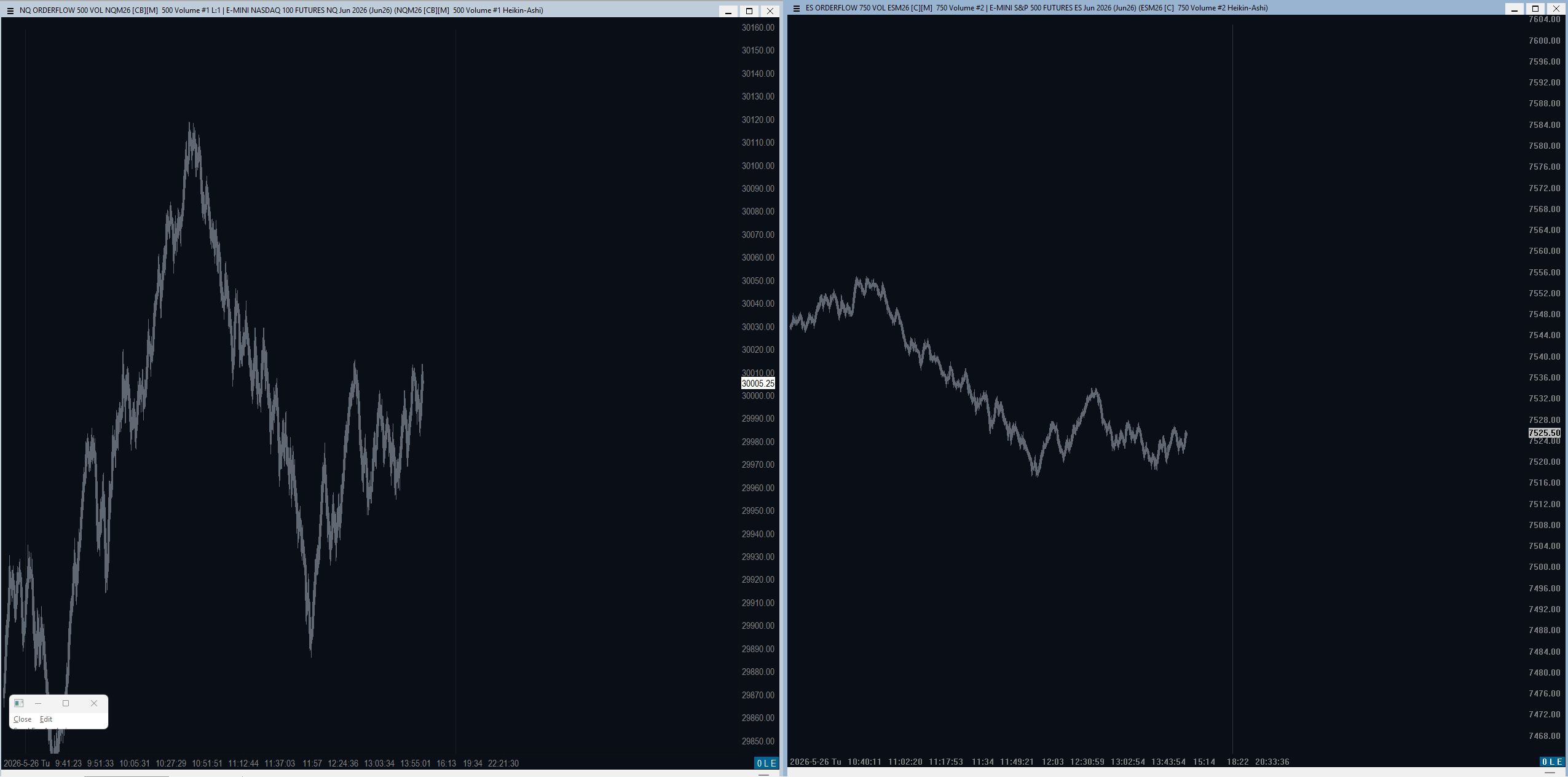

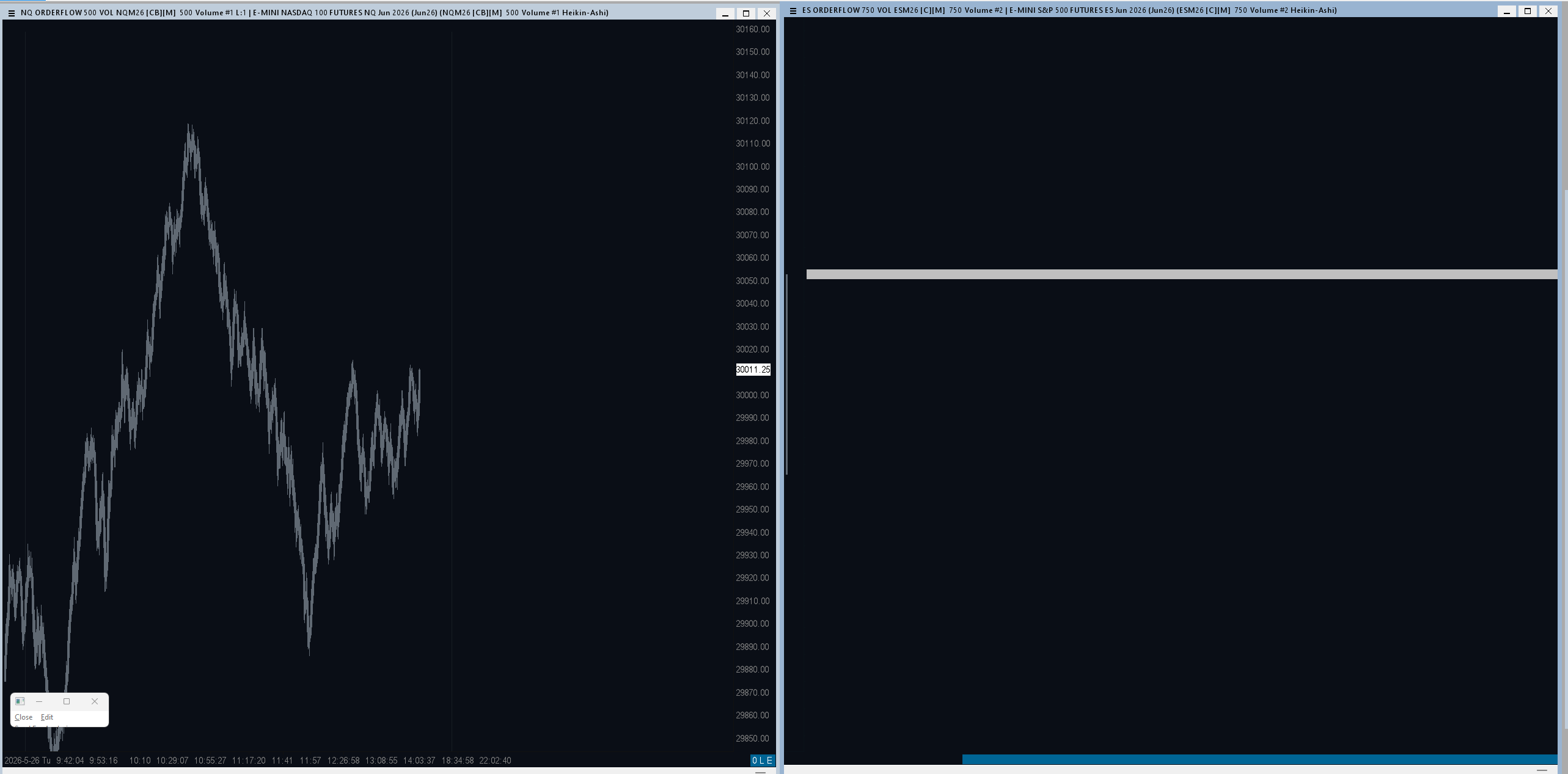

I have uploaded the chartbook. There are 2 main charts there - NQ and ES. I have also removed ALL studies from the charts so there is no conflict or any other side effects. When you open the chartbook you will be able to see that when OpenGL are OFF both charts displayed and behave normally. However, when OpenGL is turned ON, the ES chart (on the right) is completely messed up.
I am also attaching the screenshots to illustrate this.
Thank you so much for looking into this!
Date Time Of Last Edit: 2026-05-29 14:58:59
imageOpenGL OFF.png / V - Attached On 2026-05-26 18:11:37 UTC - Size: 70.76 KB - 163 views
imageOpenGL ON.png / V - Attached On 2026-05-26 18:11:42 UTC - Size: 57.33 KB - 121 views

This issue may be related to fonts. We want you to update to the current version of Sierra Chart instructions:
Go to the chart where there is a problem when using OpenGL. Set Chart >> Graphics Settings >> Graphics Settings for Chart-Colors >> Settings >> Use Global Graphics Settings Instead of These Settings : No
Press OK.
Go to Chart >> Graphics Settings >> Graphics Settings for Chart-Fonts
Near the bottom press the Reset >> Reset All Fonts To Their Own Default button.
Press OK.
Save the Chartbook. Restart Sierra Chart. See if the problem is then resolved in the chart.
[2026-06-02 22:51:26]
Meklon - Posts: 273
Hello support, you have (once again) nailed it!
I have followed your recommendation (resetting the fonts on the problem chart to their default) and it has fixed the problem. Now when OpenGL is activated the charts are plotted perfectly normal and all studies (including the custom studies) are working as expected and without any issues.
