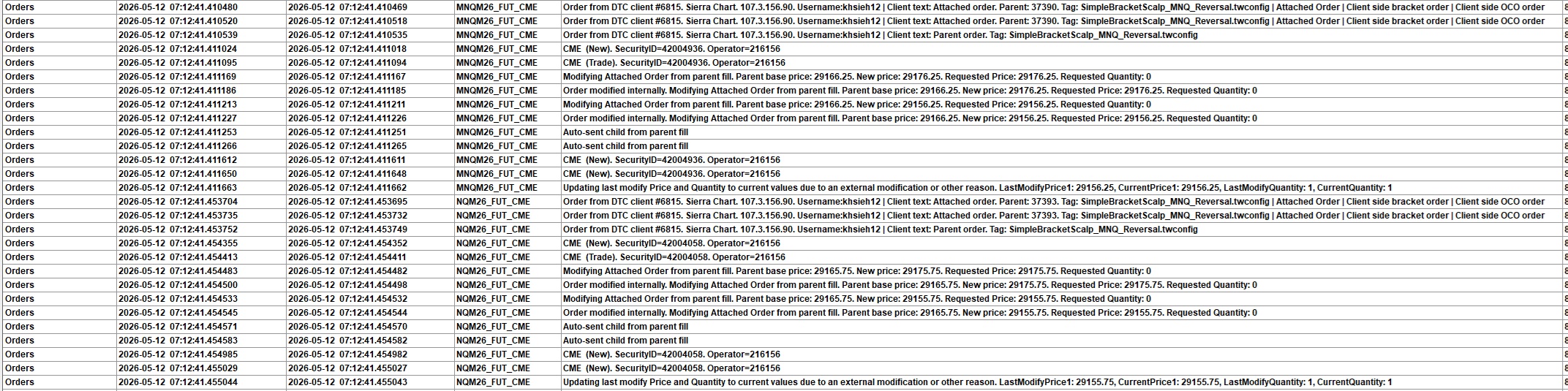

I am running an automated study on an MNQ chart, but it also unexpectedly triggered an NQ order at the same time. I haven't had this issue previously, it seems like it just happened today. Is there a way in the trade activity log to track what chart or where this order is being placed from? All my MNQ charts have MNQ as the Symbol with nothing in the "Trade and current Quote Symbol".

I have attached a screenshot of a section of my "All Activity" of my trade activity. I have an automated study that was on an MNQ chart, but as you can see in the screenshot, it triggered both an NQ and MNQ order. However, in the OrderActionSource column, I don't think i get enough detail as to what chart it's coming from.
I do have another chartbook that has this automation on an NQ chart, but i did not have it open at this time. Is it possible for unopened chartbooks to trigger automation?
imageOrder Activity.jpg / V - Attached On 2026-05-12 15:24:21 UTC - Size: 663 KB - 118 views
[2026-05-12 15:36:01]
On the far right of the Trade Activity Log is a column for "IsAutomated". Is there a "Y" in that column for the NQ orders?
If so, then this order would be coming from your trading study. You would need to look at your study and see if it may open a position for both MNQ and NQ.
On the other hand, if it shows "N", then this would mean that the order was entered manually.
Absolutely not.
[2026-05-12 15:40:01]
User528458 - Posts: 5
Yes, the ISAutomated Column is a "Y".
If i have an NQ trading window open and an MNQ trading window open, would a study trigger a buy/sell for both? Or is it supposed to only trigger on the chart it's on?

[2026-05-12 16:12:56]
You can't see the chart for a specific order, but if you go to the "Chart Stats" tab, you will see the symbols associated with the charts that generated the trades. Refer to the following:
Trade Activity Log: Trade Statistics for Charts (Chart Stats) Tab
So if a chart generated an order for a symbol, then it will show that chart in there.
You could always limit the data that is displayed in the Trade Activity Log to the one trade for NQ so you can see the specific chart for that order.
[2026-05-13 00:37:25]
Thank you for this response! Looking at the trade stats and which charts had stats, I realized I had a minimized chart with this study on NQ that executed. I appreciate the help!
