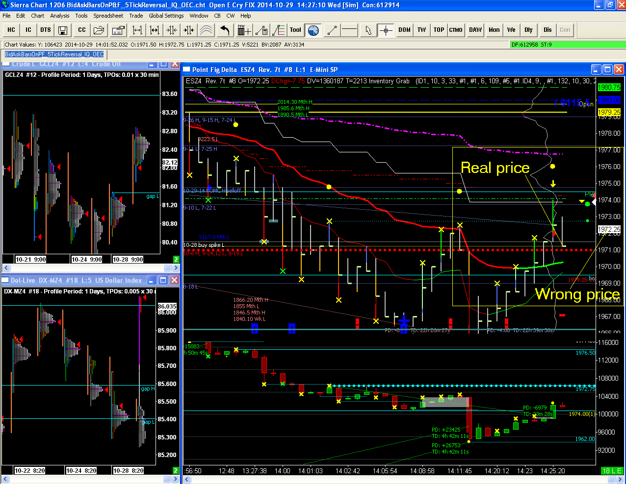

As the volatility on the Es contract increased after the FOMC announcement (2 PM Eastern) today the price highlight on the right of chart started jumping2,3 points away from the market price. I just upgraded to 1206 so I could connect to OEC Fix feed. This has never happened before.
As volatility got back to normal things got back to normal. Or at least you could not notice the discrepancy.
This is effecting some of the custom studies that I use.

imagePriceHighlightError1.PNG / V - Attached On 2014-10-29 19:29:57 UTC - Size: 91.91 KB - 487 views
[2014-10-29 19:50:47]
This is an OEC data feed problem. This is nothing new. We have had numerous reports of this over at least the last six months. This is a characteristic of the OEC data feed that some users may have when the market becomes very active.

The problem is on the OEC side and what has changed is that Sierra Chart uses a FIX/FAST connection and it is that Service on the OEC side which does not function properly with high market data rates.
Also, you can use the same version you were previously running before and you will be able to connect to OEC. The connection problem relates to the FIX connection. Not to older versions which use the old API component.

We saw evidence on our server of the same OEC data feed problem :
Last trade price is higher than 10 ticks above Ask. ESZ4 | 2014-10-29 14:17:08
Last trade price is higher than 10 ticks above Ask. RLM-MZ4 | 2014-10-29 14:17:08
Last trade price is higher than 10 ticks above Ask. EMDZ4 | 2014-10-29 14:17:08
Last trade price is higher than 10 ticks above Ask. FDAXZ4 | 2014-10-29 14:17:09
Last trade price is higher than 10 ticks above Ask. RLM-MZ4 | 2014-10-29 14:17:09
Last trade price is higher than 10 ticks above Ask. NQZ4 | 2014-10-29 14:17:09
Last trade price is higher than 10 ticks above Ask. ESZ4 | 2014-10-29 14:17:09
Last trade price is higher than 10 ticks above Ask. GCLZ4 | 2014-10-29 14:17:09
The timestamps at the end are in US Eastern time. This problem occurred before and after this time.
