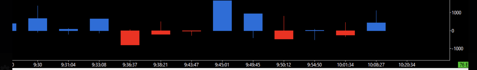

What study or settings are required to display a cumulative volume/delta reading that oscillates above and below zero, similar to what’s shown in the attached screenshot?
I’ve tried adding all of the Cumulative Volume Delta (CVD) studies available to a footprint (Numbers Bars) chart, but none of them produce a centered, zero-based reading.
None of the studies I added anchor around zero as expected.
Instead, they showed CVD bars that trend.
What specific study or configuration of a study allows for this kind of zero-centered cumulative reading of CVD that I can use at the bottom of a footprint chart?

What you are wanting is NOT a Cumulative study. By definition, a "Cumulative" study is going to accumulate as time progresses.
Refer to the following study that should be what you are looking for:
Ask/Bid Volume Difference Bars
