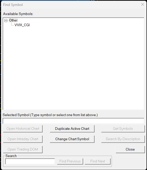

This morning, I am not receiving the live data feed and last night's data is missing some areas. I rebooted Sierra, I looked to change the symbol to another to see if that was the issue. I don't have any symbol in the Find Symbol window. See picture.
imageScreenshot 2026-04-28 102925.png / V - Attached On 2026-04-28 18:37:05 UTC - Size: 17.83 KB - 108 views

When you have an issue like what is showing in your Find Symbol window, where items are not being displayed, then you need to reboot your computer. This typically means that your computer is out of resources to be able to properly draw that window.
After you reboot, only start Sierra Chart - do not start other applications you do not need.

The first thing is to make sure that windows are being drawn properly, as nothing else will matter if you are not able to work in the system properly.
What is "Global Settings >> Data/Trade Service Settings >> Main Settings >> Current Selected Service" set to?
And please get us an image of your "File >> Find Symbol" window after you rebooted your system.
