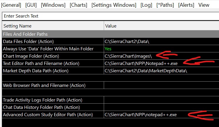

Hello Sierra Chart Team,
I've just installed a second copy of SC on my computer.
As I launched it for the first time all the folders in Global Settings/General Settings/Paths were pointed to my SierraChart2 directory.
After I've copy-pasted various files from the "Original copy" to the second one as described in "Transferring Sierra Chart Settings and Data From Existing Installation to New Installation" Transferring Sierra Chart Settings and Data From Existing Installation to New Installation
I've noticed that some paths have changed and are pointing now to the Original copy directory (see attachment).
Is this normal or shall I revert them back to "SierraChart2".
Thank you

Yes you should do this:
But those particular Folder Paths, are probably fine the way they are but it is good to put them back to their default. The easiest way to do that is to clear those Folder Paths, and press Apply.
