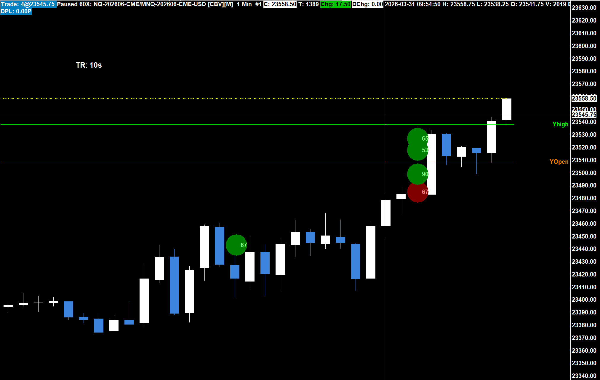

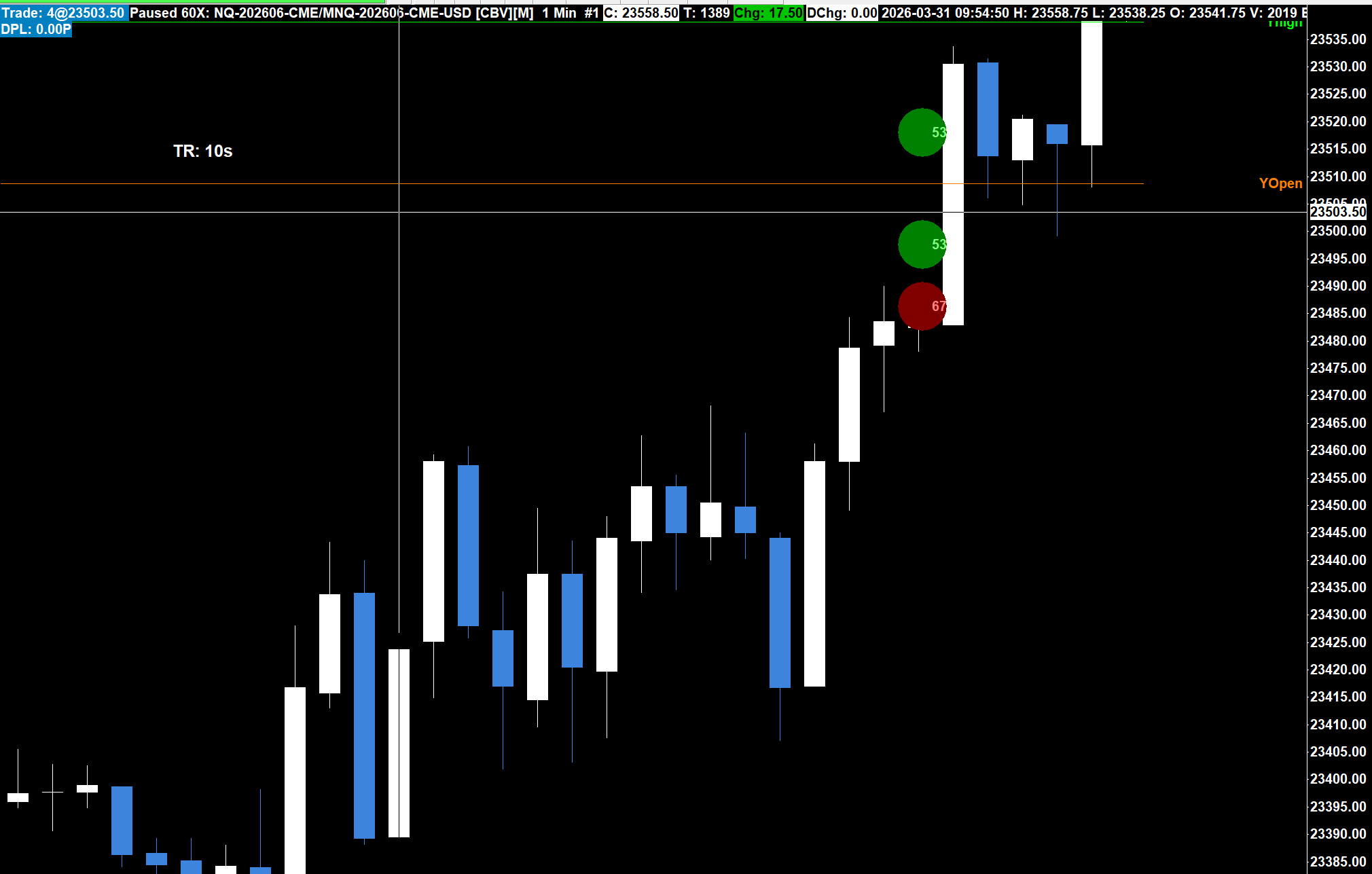

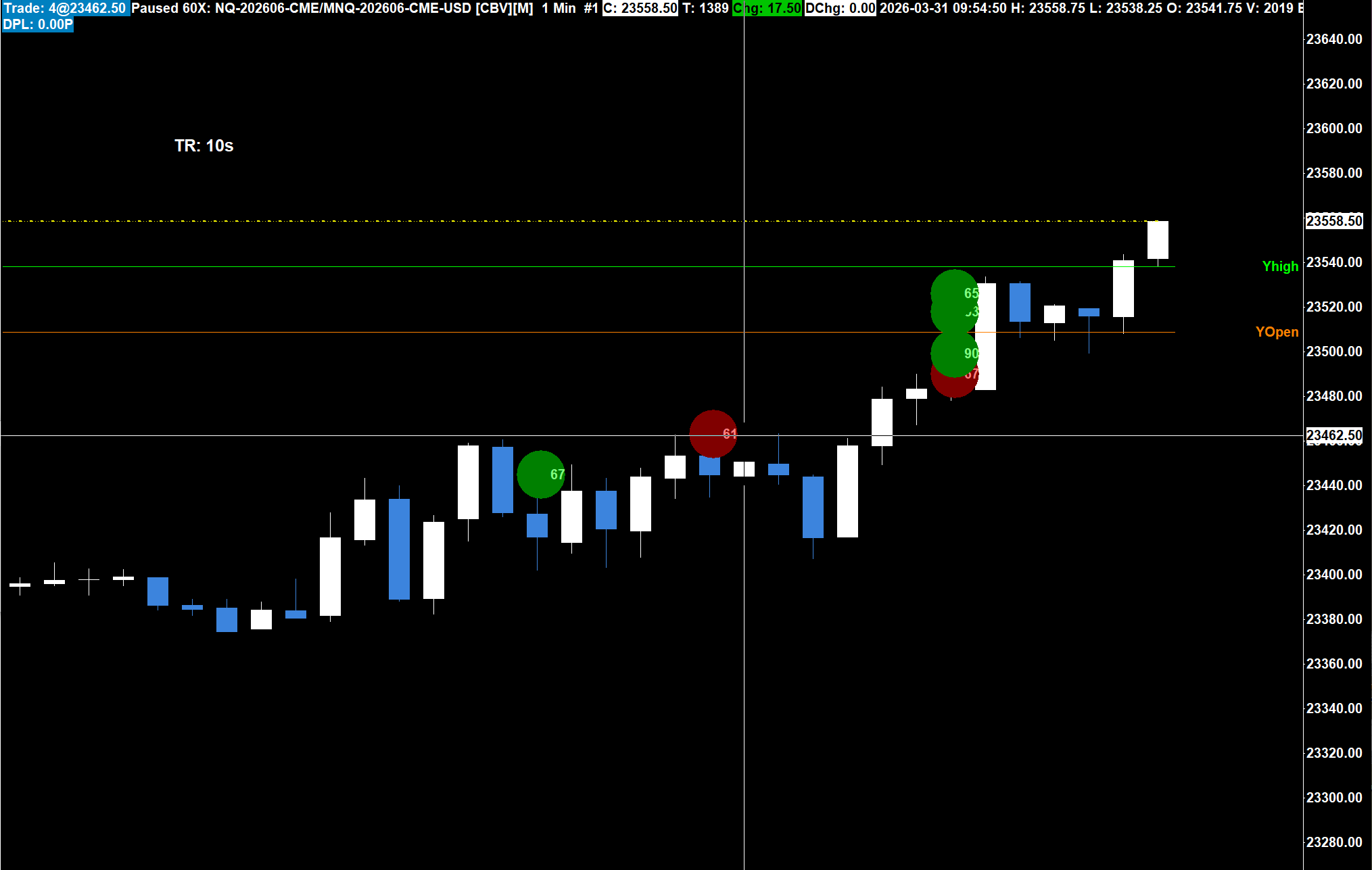

Hello!
I've got a problem with this indicator because when i zoom in or zoom out in the chart some bubbles appears and some disappear.
Do you know how can i fix that?
Look at the pictures attached to see the difference

[2026-04-26 21:10:27]
Sierra_Chart Engineering - Posts: 25489
Regarding the Large Volume Trade Indicator, It is necessary and mandatory, to update to the current version due to recent changes. Instructions to update:
This should resolve any problems that you have like that.

[2026-04-28 16:20:40]
You have the option for "Automatic Combining of Price Levels for Markers" set to "Yes". This will cause changes to the markers as you Zoom In/Zoom Out. Refer to the information for this Input in the following section:

[2026-04-29 06:32:20]
User751630 - Posts: 29
Yes it's works.
