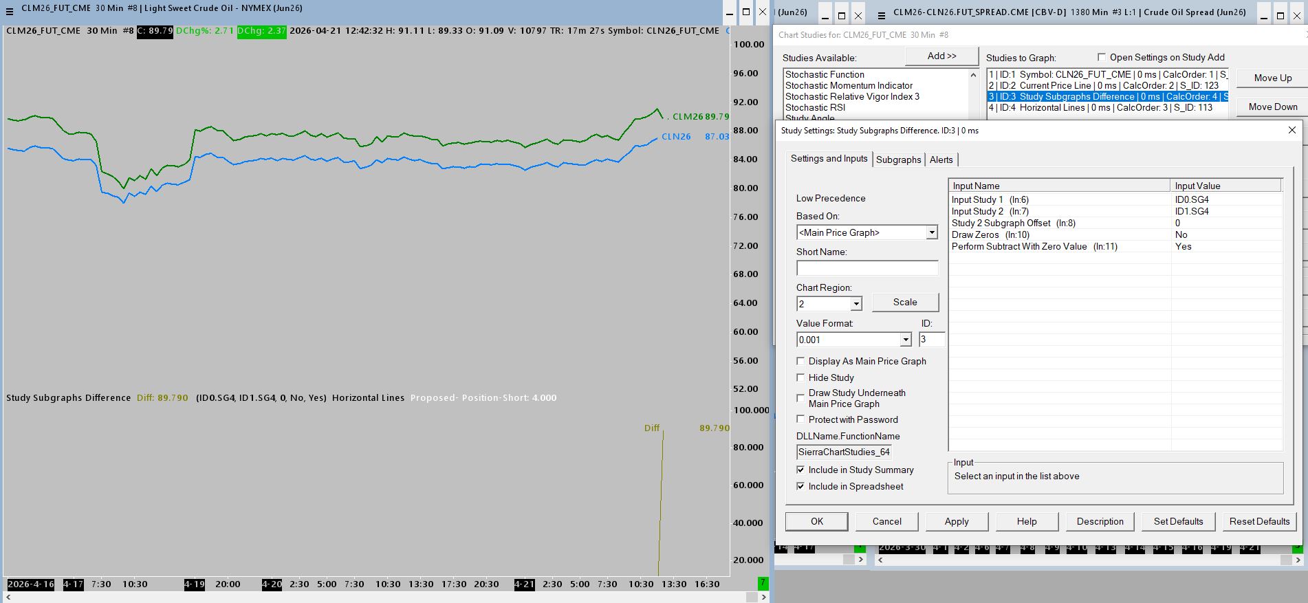

I am using Add Additional Symbol study to my chart. Is the price given not live. It seems to be behind the live chart. Also when using it with Difference Study it was originally correct now just giving value of Main Price Graph- not the difference in Price between the Main Price Graph and the Additional Symbol Study.
image4-21-26.JPG / V - Attached On 2026-04-21 17:49:12 UTC - Size: 193.16 KB - 205 views
[2026-04-21 19:24:15]
Sierra_Chart Engineering - Posts: 25489
It will update, in real time, but the symbol itself may not be a updating that frequently.

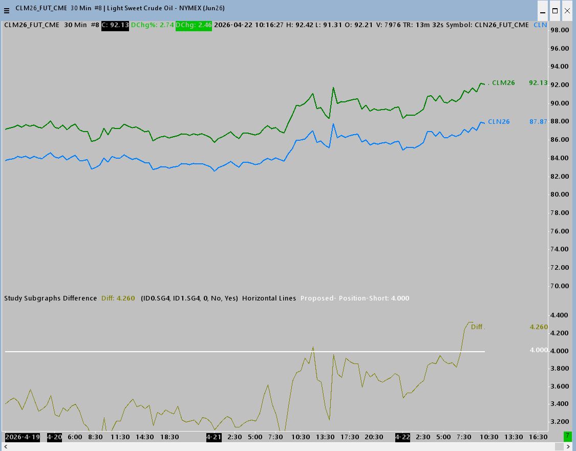

User841161 - Posts: 357
Weird, I am not sure why the 2nd month symbol wouldn't be updating frequently? Right now, it seems working how I would expect. We'll keep watching...
