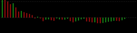

I need to setup two charts that show like histogram, but I can't find a way to do it with this instruments (NISS-SP and NISS-NQ).

[2026-04-17 15:26:46]
Rui S - Posts: 258
Are you wanting bars - like what you would see with the "Volume" study, such that each bar goes to the "Last"
Yes, something like horizontal volume bars, except as NISS sometimes has negative values, it would work above and below "0", very much like a Histogram chart.

[2026-04-17 18:28:08]
To get this, you would need to add the "Study Subgraph Reference" study to the chart and set the following items for it:
- Settings and Inputs Tab:
-- Display as Main Price Graph: Enabled (has a checkmark by it)
-- Study Subgraph to Reference: "<Main Price Graph>" and whichever item you want to reference such as "Last (SG4)"
- Subgraphs Tab:
-- Draw Style: Bar
Set other items as you want them.

[2026-04-17 19:59:54]
Rui S - Posts: 258
Hi John,
That's it!
Thanks!
