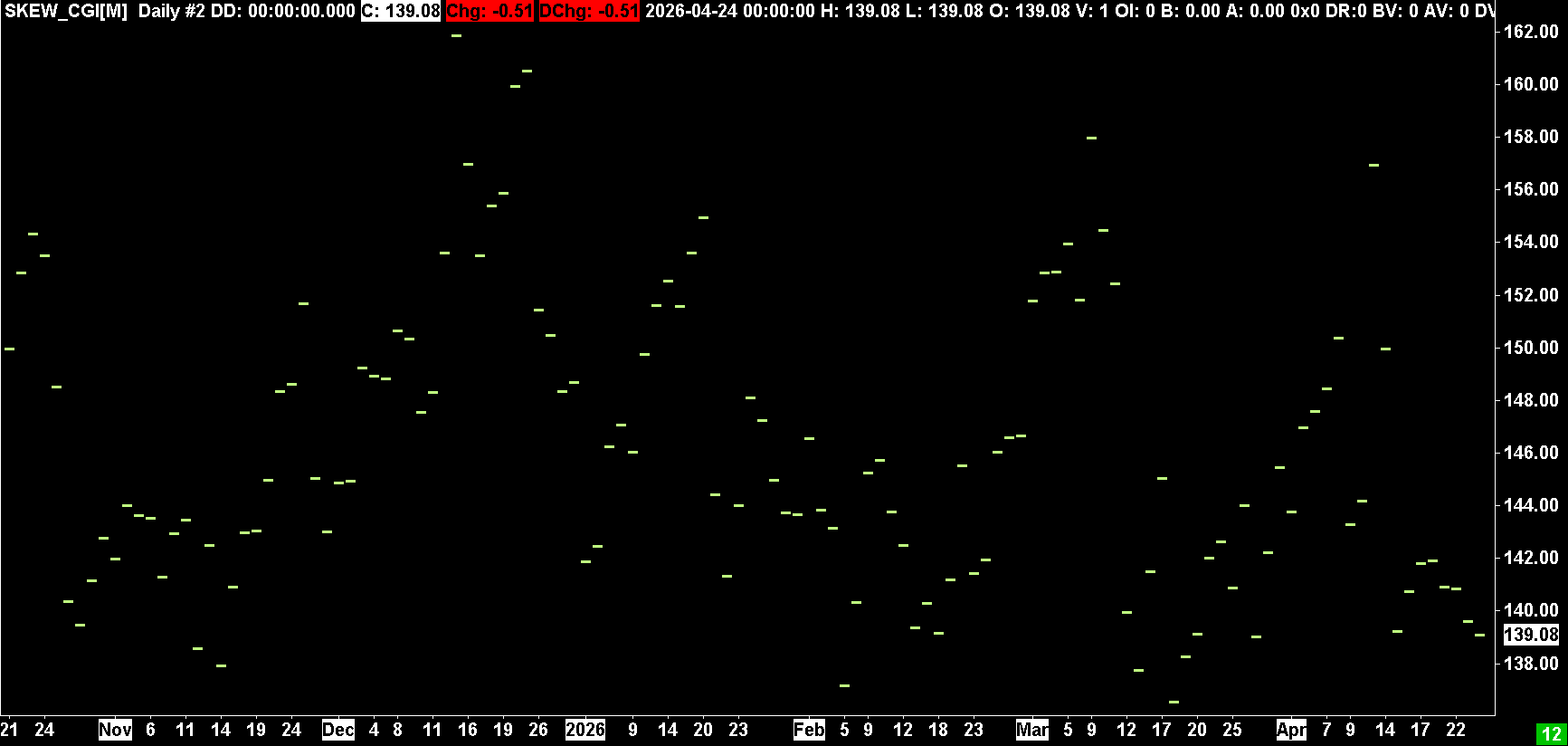

[2026-04-27 14:53:00]
Sierra_Chart Engineering - Posts: 25489
We now realize what the problem is. This is only an end of day value. So you need to use a historical daily chart:
https://www.sierrachart.com/image.php?Image=1777301534693.png
[2026-05-04 21:01:54]
felixcorrales - Posts: 10
Thank you for investigating and resolving the SKEW_CGI issue. Confirmed it works on a Historical Daily chart.

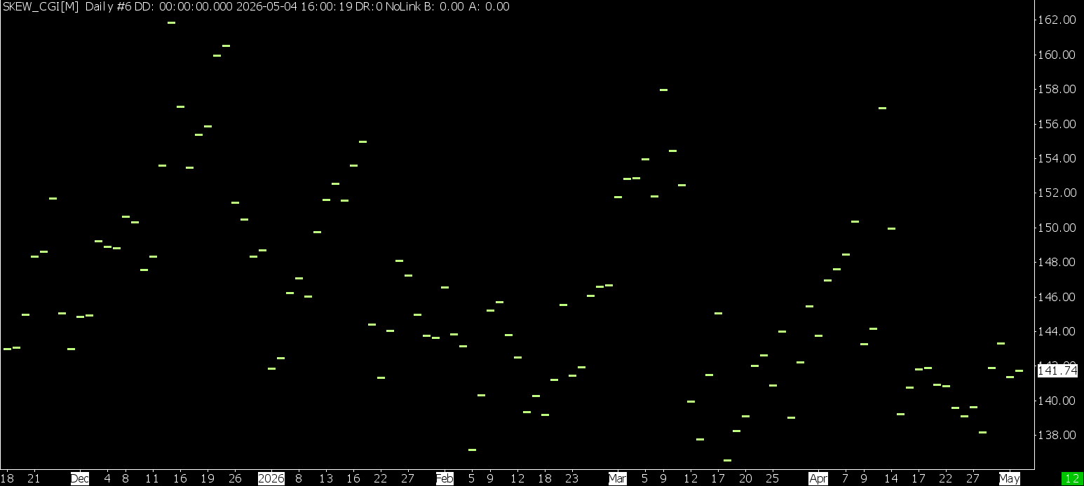

[2026-05-04 21:49:22]
We are not seeing any issue with the scaling for the SKEW_CGI symbol. See the attached image of what we see.
Please be sure to reset the scale to ensure that it is finding the data correctly. Refer to the following:
Chart Scale and Scale Adjusting: Resetting the Scale
Please get us an image of what you are seeing.
And please tell us what "Global Settings >> Data/Trade Service Settings >> Main Settings >> Current Selected Service" is set to.
Date Time Of Last Edit: 2026-05-04 21:50:14

[2026-05-05 00:23:07]
Thank you. Resetting the scale via Chart >> Reset Scale resolved the issue. SKEW_CGI is now displaying correctly.
