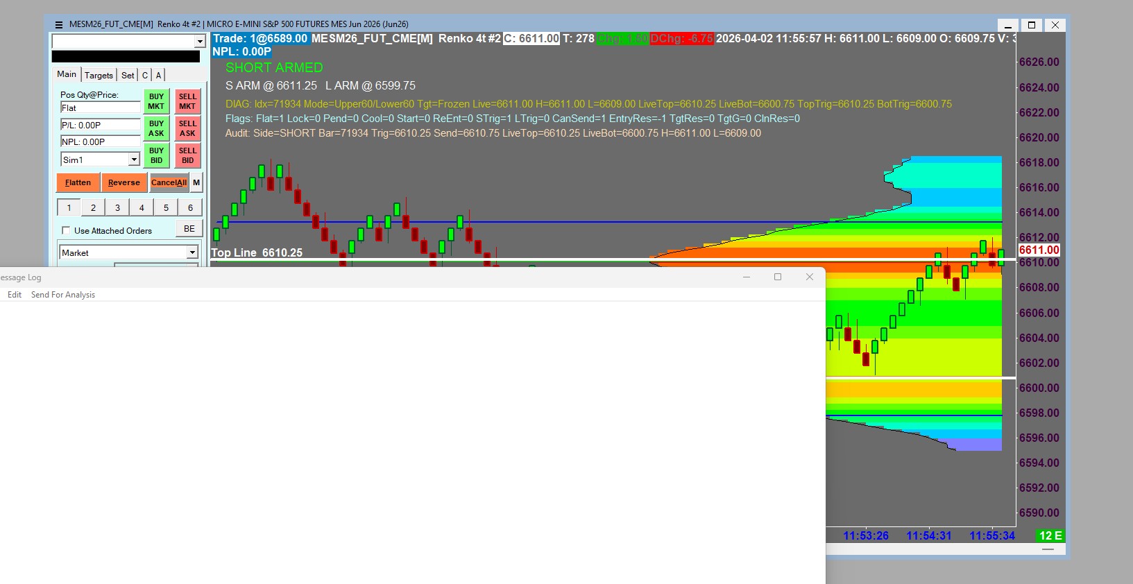

STrig=1 CanSend=1 EntryRes=-1 with empty message log despite sc.AddMessageToLog(msg,1) in the rejection handler. I have tried to attached 2 files. Don't seem to be there.

User587676 - Posts: 11
i am sorry I am new to this strategy.
imageScreenshot 2026-04-02 120004.jpg / V - Attached On 2026-04-02 16:47:24 UTC - Size: 185.73 KB - 128 views
attachmentBasic2LineCopilot.cpp - Attached On 2026-04-02 16:47:43 UTC - Size: 40.56 KB - 222 views
[2026-04-02 16:51:53]
the basic premise is it has to cross the top anchor to arm at 4 ticks right now then on return it enters a trade at that anchor reentry but it goes either from arm to ready or stays armed depending on which one of the studies i am using and then the vice versa for the lower anchor. Also if it is stopped out it can reload as long as it is past the 4 ticks set to arm
