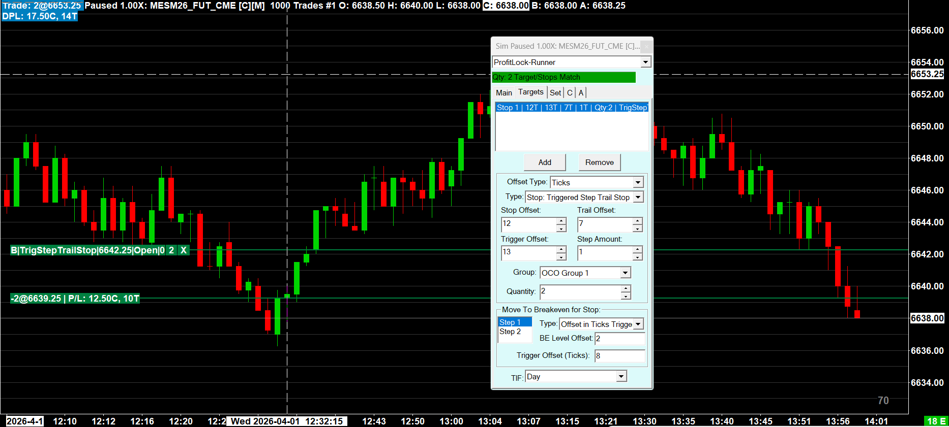

Below is my attempt to attach an image of the chart and my trade window to this message:
https://www.sierrachart.com/image.php?Image=1775076463455.png
If I did it correctly, the image should show a short where I am in profit by 10 ticks, but my stop has not moved to 2 ticks in profit as configured in the trade window, which should have happened after being 8 ticks in profit.
[2026-04-01 21:54:32]
We tested this setup and it is working just fine in Simulatin Mode for us.
One thing we note in your image is that the price has NOT gotten to the point where the Move to Breakeven would occur. The Position Average Price is 6639.25, and with a Move to Breakeven Trigger Offset of 8, the price would need to get to 6637.25. The current price is 6638.00, and the low of the most recent bar appears to line up perfectly with the grid at that same price (6638.00).
[2026-04-02 00:08:23]
em - Posts: 3
Ahh, ok I see it now. I was looking at the 10T in the trade line, thinking it was telling me how many ticks price has moved.
Thanks again!
