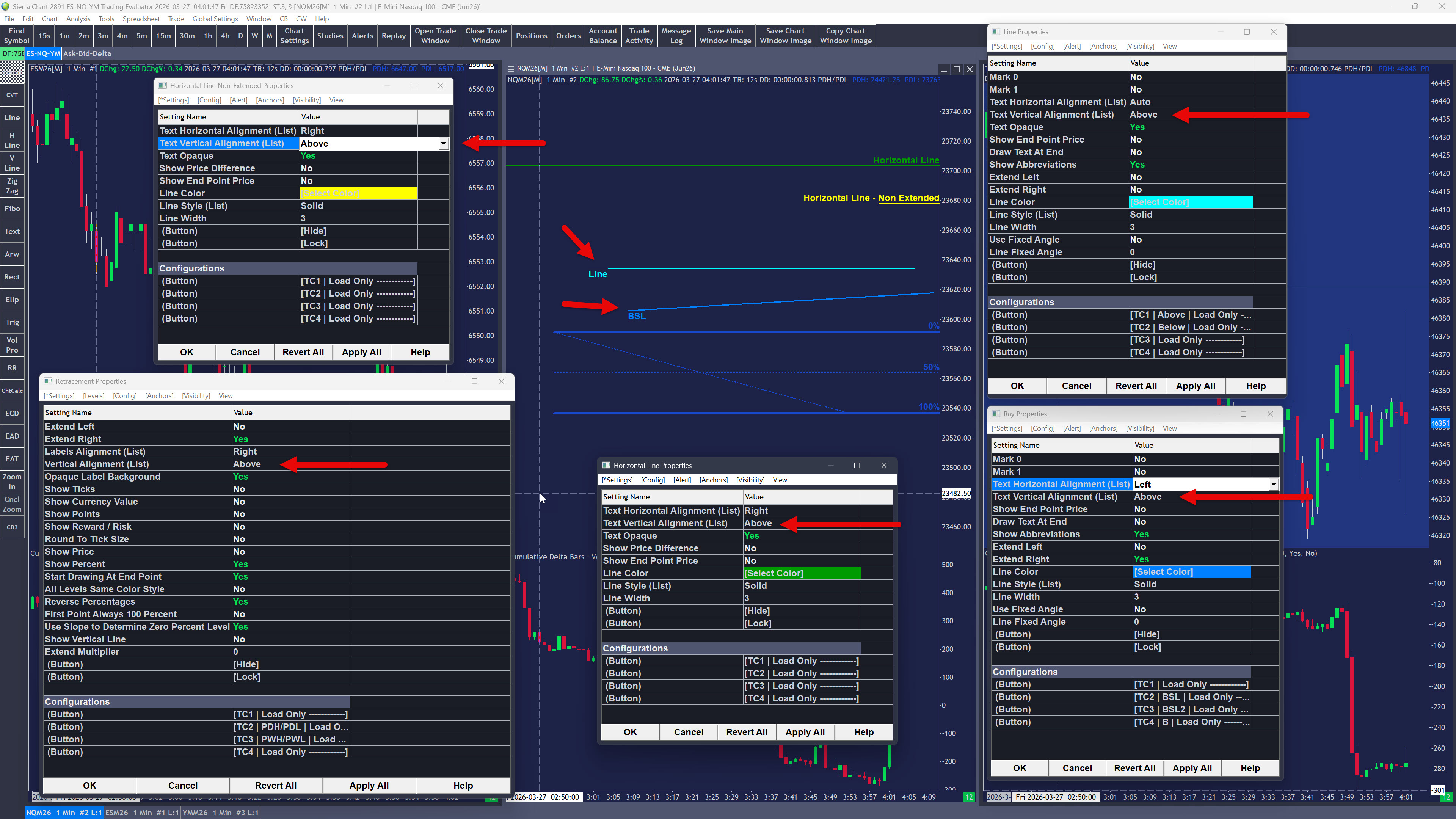

Regarding the alignment issue, I have one more comment.
I would understand if the rectangular thing applied to all tools in the platform. It’s a bit odd, but I could get used to it.
However, as shown in the screenshot below, the Text Vertical Alignment setting works correctly for other tools (such as the Horizontal Line or Retracement Tool).
If I select "Above," the text appears above the horizontal line. If I select "Below," it appears below. The same setting produces a different (and inconsistent) result with lines or rays.
Since I’ve been developing software for some time, I wanted to point out that this goes against how the feature should behave. It should always deliver the result the user expects, regardless of the tool. That’s why I believe it’s worth fixing for consistency across the platform — even if it risks a few complaints.
Please consider this. Thank you.
