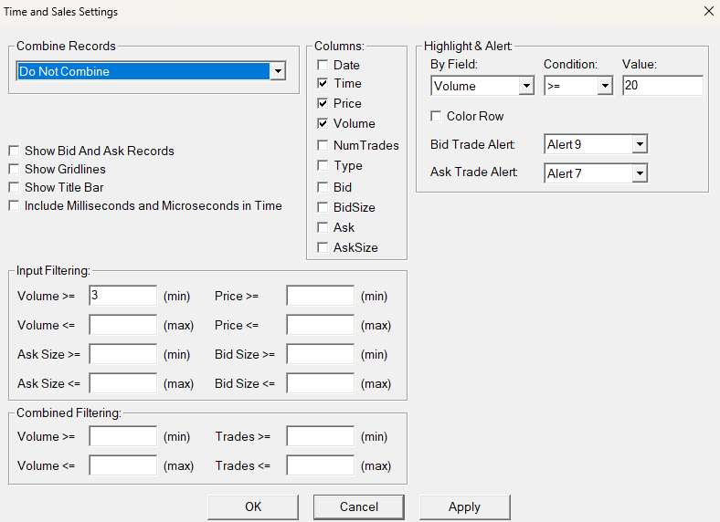

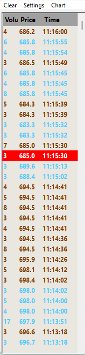

Hi, please can you explain why highlights are appearing on TOS when the setting "colour row" has been disabled?
Please find screenshots attached,
imagetos1.png / V - Attached On 2026-03-19 11:22:30 UTC - Size: 17.22 KB - 205 views
imagetos2.png / V - Attached On 2026-03-19 11:22:40 UTC - Size: 34.67 KB - 186 views
[2026-03-19 15:30:41]
We can not explain what you are seeing in that case.

The Time and Sales highlighting is coming from a trade that occurred either below the Bid or above the Ask. There are color controls for these as the following items:
- Time and Sales: Below Bid Trades Background
- Time and Sales: Below Bid Trades Text
- Time and Sales: Above Ask Trades Background
- Time and Sales: Above Ask Trades Text
There is not a way to remove those highlights.
