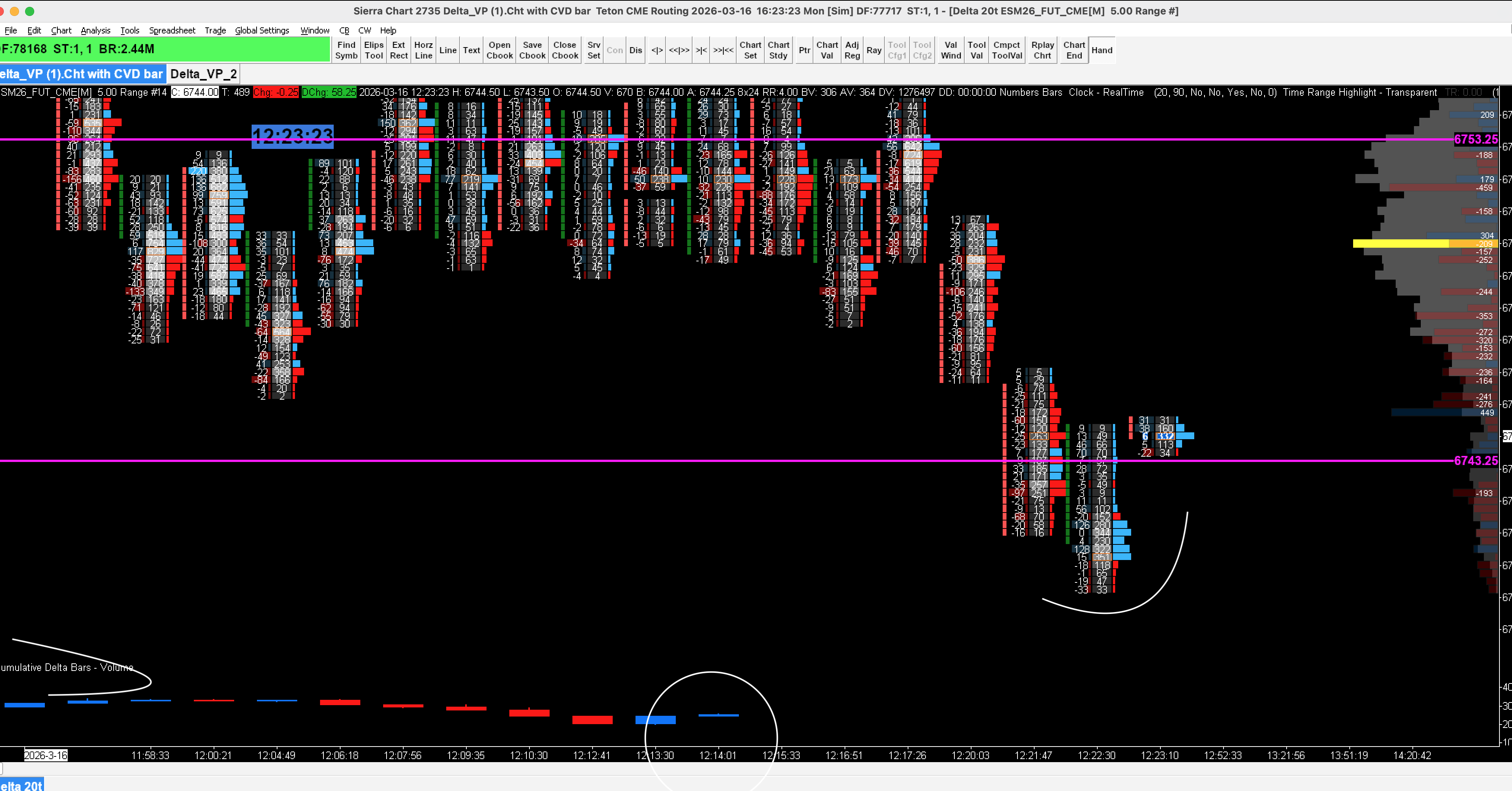

please see attached pic. suddenly today my cumulative delta bar study cuts off several minutes before my current delta print. see pic. 12:23 print shows but last cvd bar 12:14. why ? how can i fix this?
imageScreenshot 2026-03-16 at 10.23.24 AM.png / V - Attached On 2026-03-16 19:25:04 UTC - Size: 334.97 KB - 235 views
[2026-03-16 19:34:14]
We can not think of any specific reason why this would occur.
First, try selecting "Chart >> Reload and Recalculate" and see if this gets the Cumulative Delta to update properly.
If the above does not fix it, then try using the "Delete and Download Data" from the right-click options. Right click just before where the CVD stops to redownload the data from that point. Follow these instructions for this:
