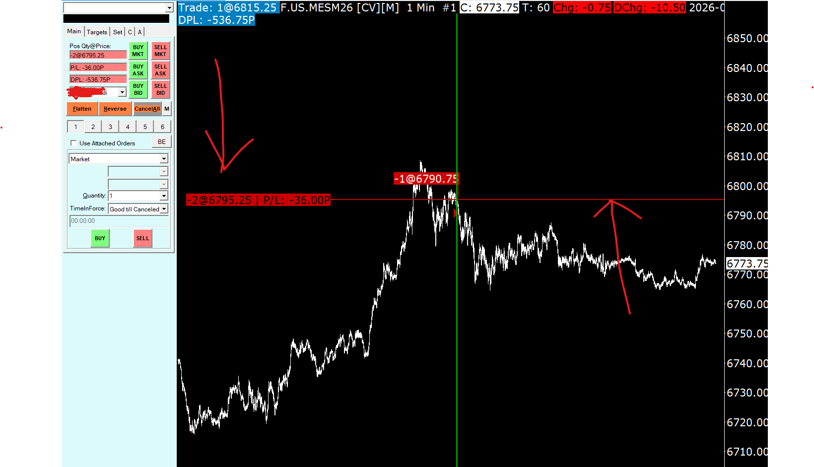

I still see -2 position that was opened under SIM MODE > "CQG ACCOUNT NAME" SIM MODE - not SIM1 etc
When I select Trade Simulation Mode On and scroll down to select "MY NAME ACCOUNT" (CQG live account shows my name not a #) then I see
-2 open trade and it carries from Mar 17. I can't close it or liquidate it.
I can only select not to show it by selecting Chart Settings>Order Fills Start Date> more recent date.
But how can I close it or delete it?
I checked with CQG and I am flat on the real account but somehow this -2 position keeps showing up on my TAL window along side my actual trades
even though it was opened on "ACCOUNT NAME" in SIM MODE.
I tried everything.
Maybe it was opened on the previous March contract symbol and I can't close it because SC forces me to click Rollover.
Thank you.
image-2 MES SIM PAST ORDER - I CAN NOT CLOSE.png / V - Attached On 2026-04-09 00:54:27 UTC - Size: 78.66 KB - 199 views

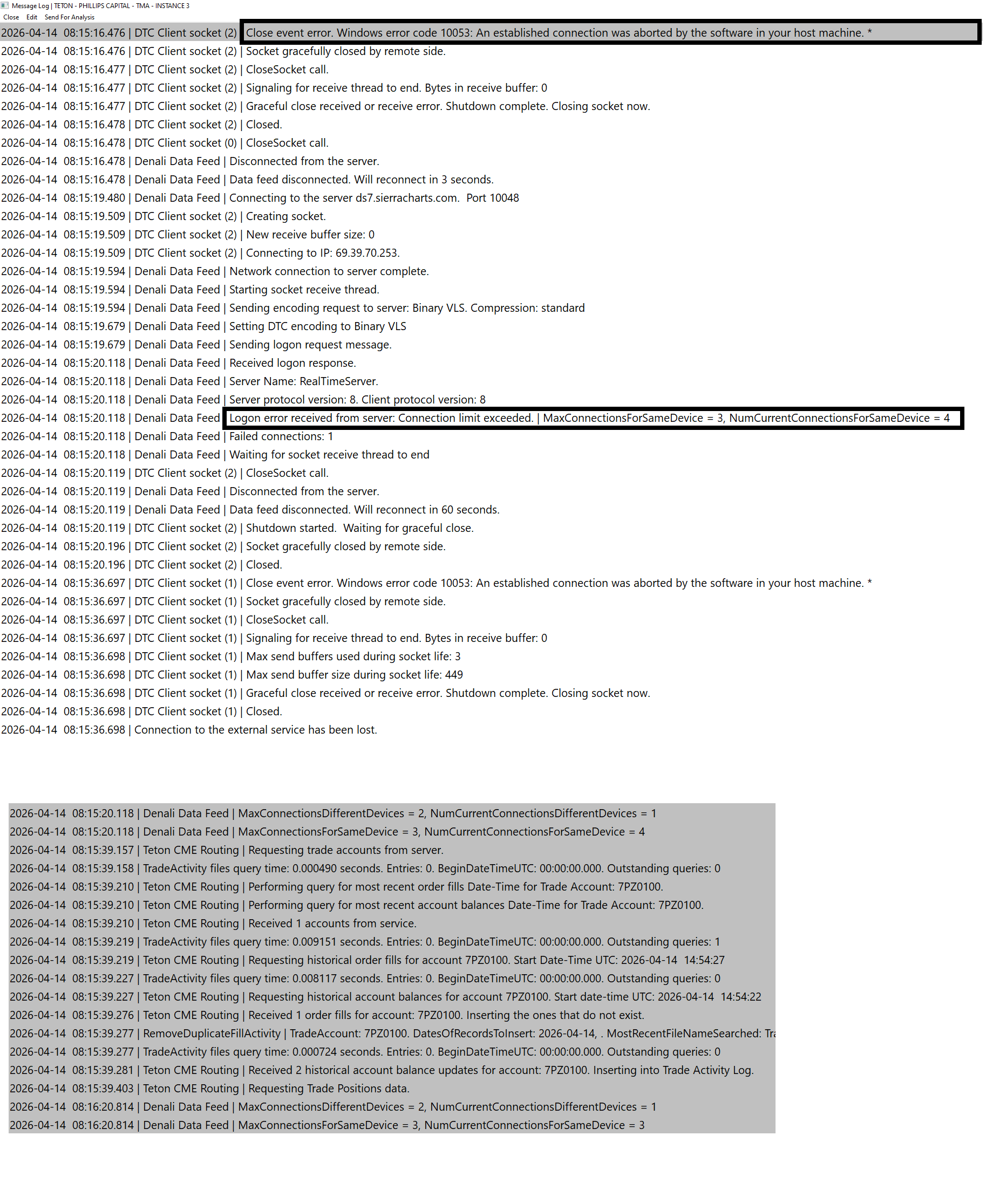

It also happened for me Teton connection on instance 3 today.
Knowing how stable Denali+Teton is, please double check the error I got in the Message Log.
It says:
"Close event error. Windows error code 10053. An established connection was aborted
by the software in your host machine" (see attached file)
Is that affirmative that it was my machine or internet connection and not Denali nor CQG/Teton
generated disconnects? I would like to isolate this issue and confirm the possible source so I can mitigate this.
Also, got the error that my NumCurrentConnectionsForSameDevice=4 (see attached)
I am only running 3 Instances on my machine:
Instance 1 Denali - All Sims (no execution)
Instance 2 Denali + CQG WebApi (RJO)
Instance 3 Denali + Teton (Phillip Capital)
Can my server disconnections at 10:15amCST be somehow causing these attempts to connect 4 times
which is 1 too many on my account or could this forced 4th connection attempt be causing one of the other instances to disconnect?
Please advise.
Thank you very much.
Date Time Of Last Edit: 2026-04-14 19:39:00
imageTeton - Disconnect from Server at 1015am CST - 4-14-2026.png / V - Attached On 2026-04-14 19:37:42 UTC - Size: 255.39 KB - 226 views
[2026-04-14 19:50:53]
If you are getting disconnects with both CQG and Teton, then this means that the issue you are having is due to connectivity with your Internet connection. We would recommend trying a different connection to see how it works for you.
With regards to the 4 connections, the system is definitely seeing the four connections somehow. In this case, exit from all your Sierra Chart instances and start them again. See if you have the same thing show up or not.

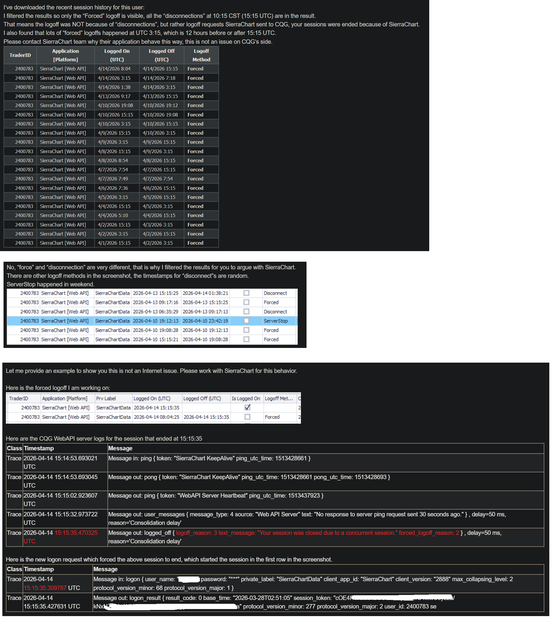

So I got a few more specific updates from CQG and although I understand you don't provide tech support for CQG,
it sounds like the issue is either with SC trying to force another login making it too many at the time or
my internet connection.
CQG tech shows these logs, hoping you can help me decode and pinpoint exactly what is the reason I am getting these forced logoffs.
It appears to be from SC side on my end.
1. I have shot down and restarted all 3 Instances of SC and will watch monitor for other forced logoff events
2. Do I need to make sure all 3 Instances are the same version/built of SC? Can I update the versions without loosing any data/settings/studies/spreadsheets if I changed all to newest version?
3. Based on the attached logs from CQG it looks to me like forced logoffs may be triggered by too many attempts to connect to a trading service
and this error: "Your session was closed due to a concurrent session." forced_logoff_reason: 2
I hope attached logs could help in isolating what exactly causes these disconnects.
Any help would be greatly appreciated.
Regards.
imageCQG Tech providing logs to show forced logoffs from Sierra S.png / V - Attached On 2026-04-15 03:03:09 UTC - Size: 553.56 KB - 174 views
[2026-04-15 07:03:25]
Sierra_Chart Engineering - Posts: 25370
You can only have one connection to CQG at a time. Which means you can only, use one instance of Sierra Chart connected to CQG at the same time. You can use sub instances though to work around this:
Using DTC Server for Data and Trading in Another Sierra Chart Instance
Why do you want to use CQG instead of Teton order routing?:
You are much better off using Teton order routing instead of CQG if you just plan to trade the CME Group of markets.
What exchanges do you want to trade on?

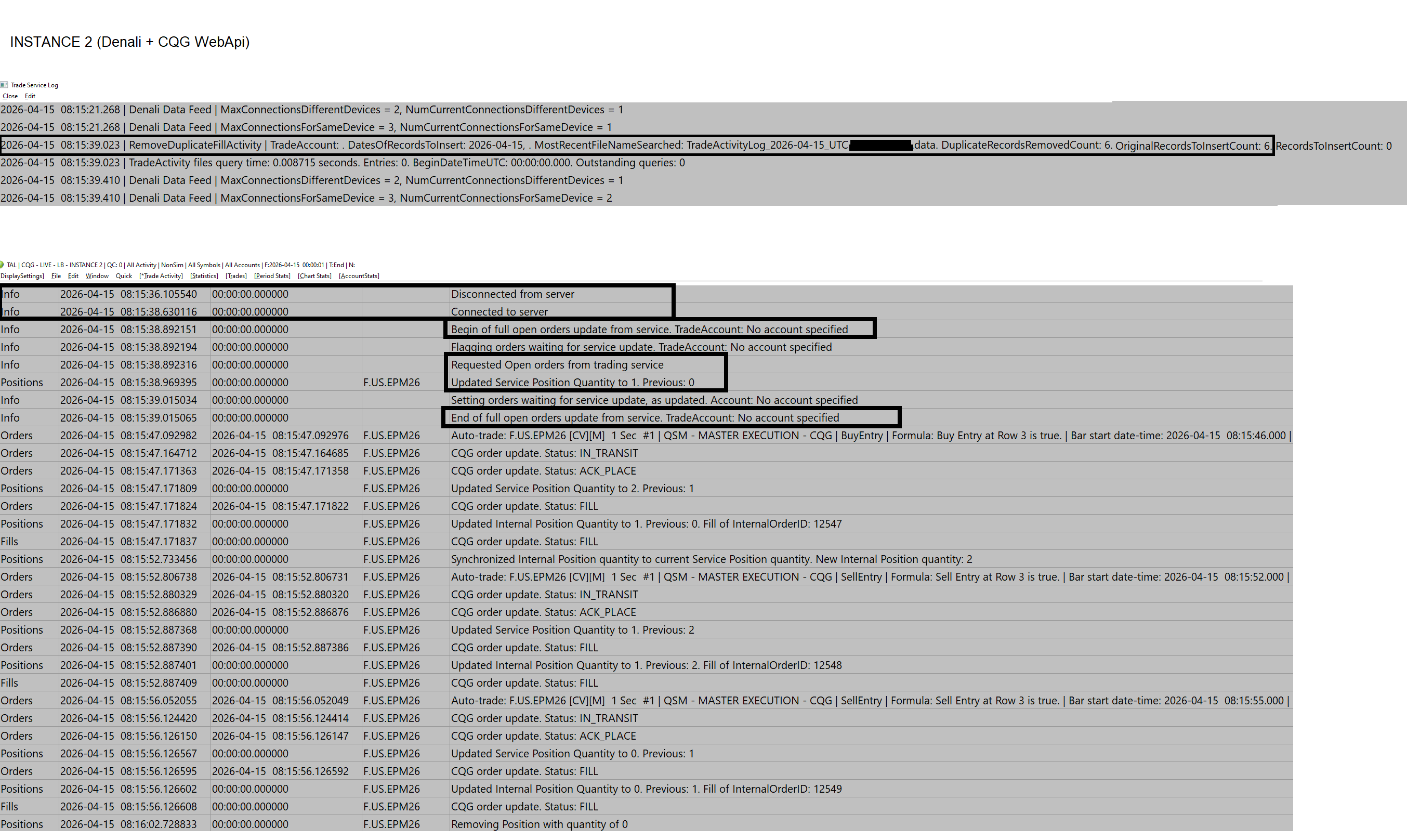

[2026-04-15 19:57:14]
Shores2021 - Posts: 59
I restarted the machine, and all 3 Instances fresh.
This is the loop that I am experiencing:
Again, today exactly at 08:15am PST I got a forced disconnect from the server.
Instance 1 - All live signals with Denali (it never dropped the connection at 08:15am PST). The strategy is +1.
Instance 2 - using ACSIL custom study keeps updating +1 From Instance 1 into Instance 2.
When Inst2 forced disconnect, somehow while it is reconnecting (under 1 minute) it sends live order +1 because it shows CQG server POS=0
(while disconnected), it fills +1 making new POS +2 (instead of desired +1).
Now it reconnected, CQG shows +2 so Inst2 sends another -1 to finally match back to original +1.
All this happens fast and everyday at 08:15am.
Inst1 (Denali Sims ) - Did not disconnect
Inst2 (Denali + CQG) - Forced disconnect - sending liver orders to match Inst1 strategy and overfills and then corrects with live orders.
Inst3 (Denali + Teton) - Did not disconnect
_
1. I only have one connection to CQG WebApi at any time using INSTANCE 2.
2. I am already using TETON for one of the accounts with Phillip Capital. No issues here.
3. I am using CQG because I have private managed accounts with RJO and they only offer CQG at this time.
4. Today I did not get "too many connections error" from my machine. Last time it was trying the 4th connection. Restart helped I guess.
I hope I can resolve this otherwise I would have to either:
- Try DTC Server
- Try running all 3 Instances on VPS
- Try using 2 separate machines (not most desirable)
- Execute via Phillip Cap and use giveups from Phillip to RJO accounts.
Which of these would you recommend?
Thank you again for your inputs.
Date Time Of Last Edit: 2026-04-15 20:06:59
image0815AM PST - another forced server disconnect.png / V - Attached On 2026-04-15 19:57:05 UTC - Size: 221.39 KB - 155 views
[2026-04-15 20:13:50]
The only thing we can state from what you have provided, is that if you saw a disconnect at 08:15 with only the connection to CQG, then this would imply an issue with the CQG connection.
As to how your studies work and what would work best for your setup, that is outside of our support.

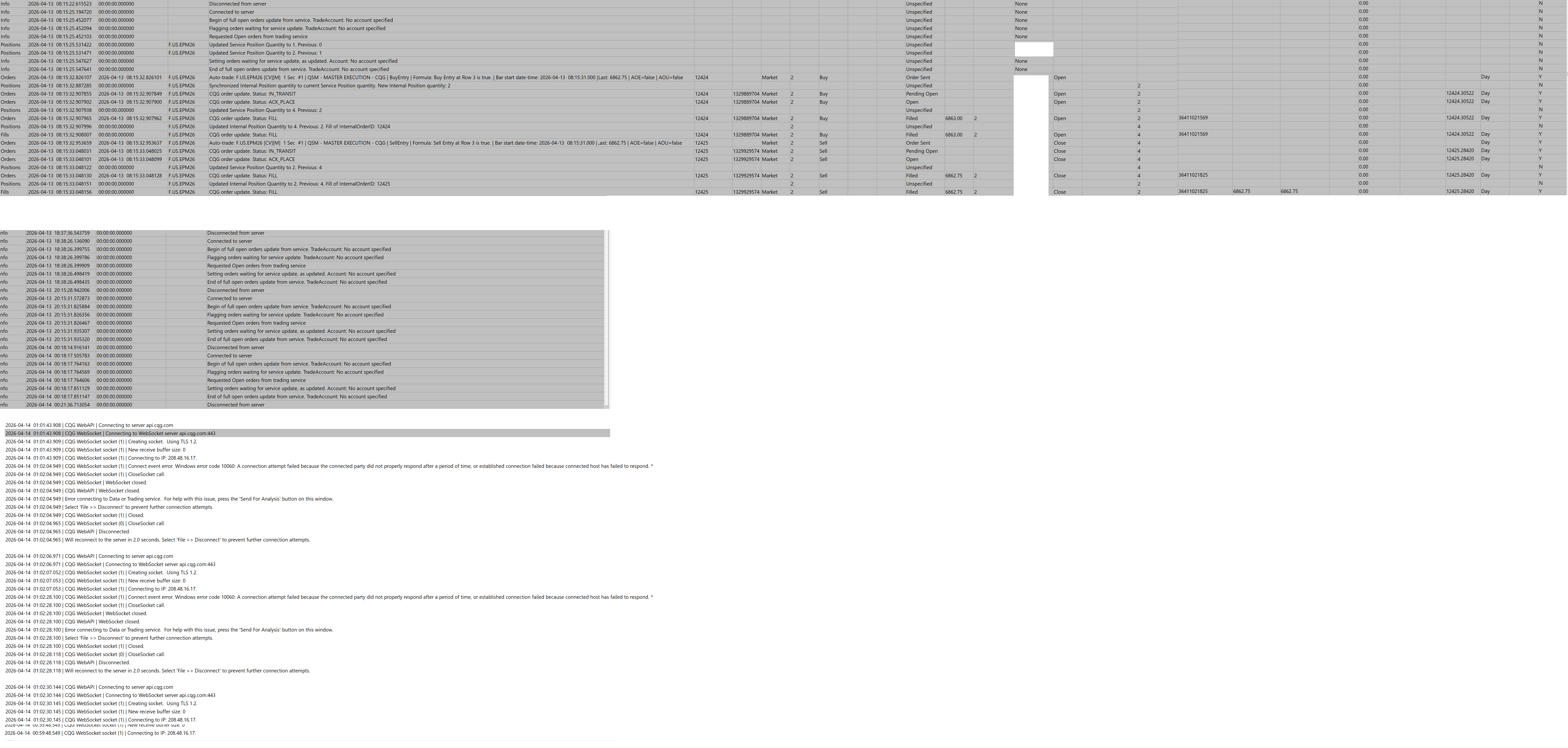

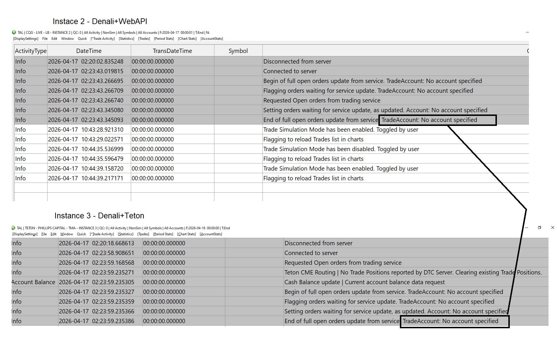

[2026-04-17 18:22:22]
Today both Instances disconnected. Here are the TAL logs (attached). So it may not be CQG after all.
1. Based on the TAL log messages, can you confirm that such disconnection could be triggered by an internet connection?
Also, can you confirm that the message log loop saying "No Account Specified" is normal?
Another words when the disconnect/connected to server loop is finished
the info from service log is connected even though TradeAccount account says: No Account specified.
2. Also, is it possible for Instance1 and Instance2 which communicates via Custom study can get disconnected and not auto reconnect
during these disconnects loops? Today, after the reconnect it seems like Inst1 <> Inst2 Custom Study bridge stopped communicating.
What do you recommend I can do to make sure custom Study refreshes or re-arms it-self after a reconnect loop if I am not by the machine to manually reset the ACSIL study or do I need to code something special for ACSCIL bridge to re-arm automatically?
3. If done correctly, shouldn't all Spreadsheets and all Custom Studies (ACSIL bridges) between all Instances
reconnect to pre-disconnect state after an unattended auto disconnect/reconnect loops automatically?
Date Time Of Last Edit: 2026-04-17 18:25:22
imageALL INSTANCES DISCONNECTED FROM SERVER - 2026-04-17 AT 02-.png / V - Attached On 2026-04-17 18:22:16 UTC - Size: 128.9 KB - 137 views

[2026-04-20 13:58:30]
1. The only thing we can tell from your Trade Activity Log is that there was a disconnection around 02:20 on April 17, 2026.
Some types of trading data requests and also depending upon the trading service, do not require a trade account identifier
2/3. These are questions about your studies that we can not answer. You have to determine who they function and what you need to do in regards to these situations.
