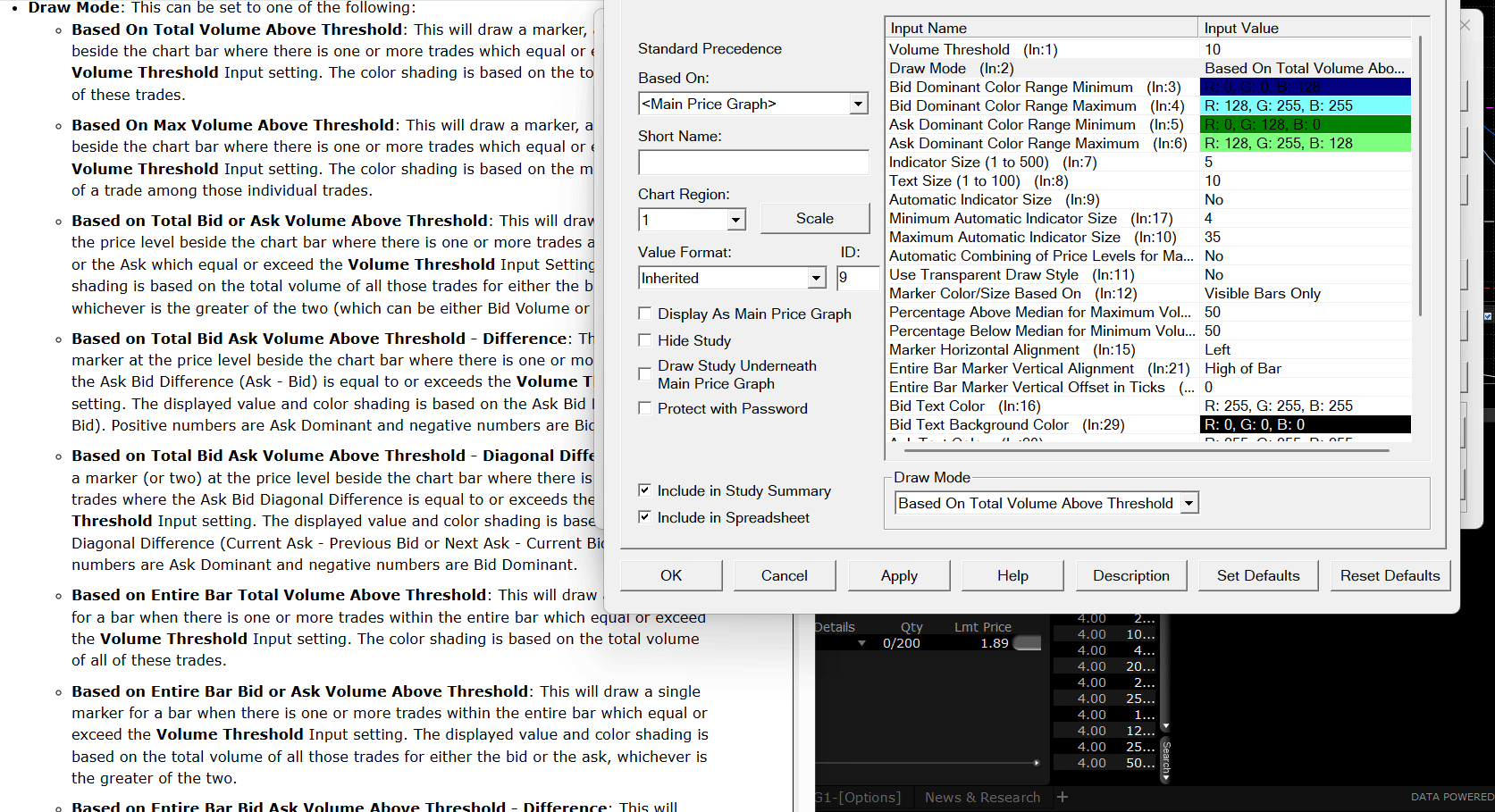

With regards to 'Large Volume Trade Indicator' study.
I want to set "Based on Total Bid Ask Volume Above Threshold - Diagonal Difference" which appears in the reference above.
However, inside SC Study Draw Mode In:2 does not have this option.
Could you check please?
imagetws_NeKyJFhFCM.gif / V - Attached On 2026-03-11 14:17:03 UTC - Size: 409.25 KB - 145 views
[2026-03-11 14:47:13]
It is there. We do not know how you missed it, but it is showing in the gif you provided. It is right under the option for "Based on Total Bid Ask Volume Above Threshold - Difference".
[2026-03-11 15:33:54]
GeeMan - Posts: 11
Hi
Do you mean I should use Ask Bid rather than Bid Ask?
[2026-03-11 16:28:19]
That was a transposition error on our part in the documentation. We have corrected it so that the documentation reflects what is in the software.
