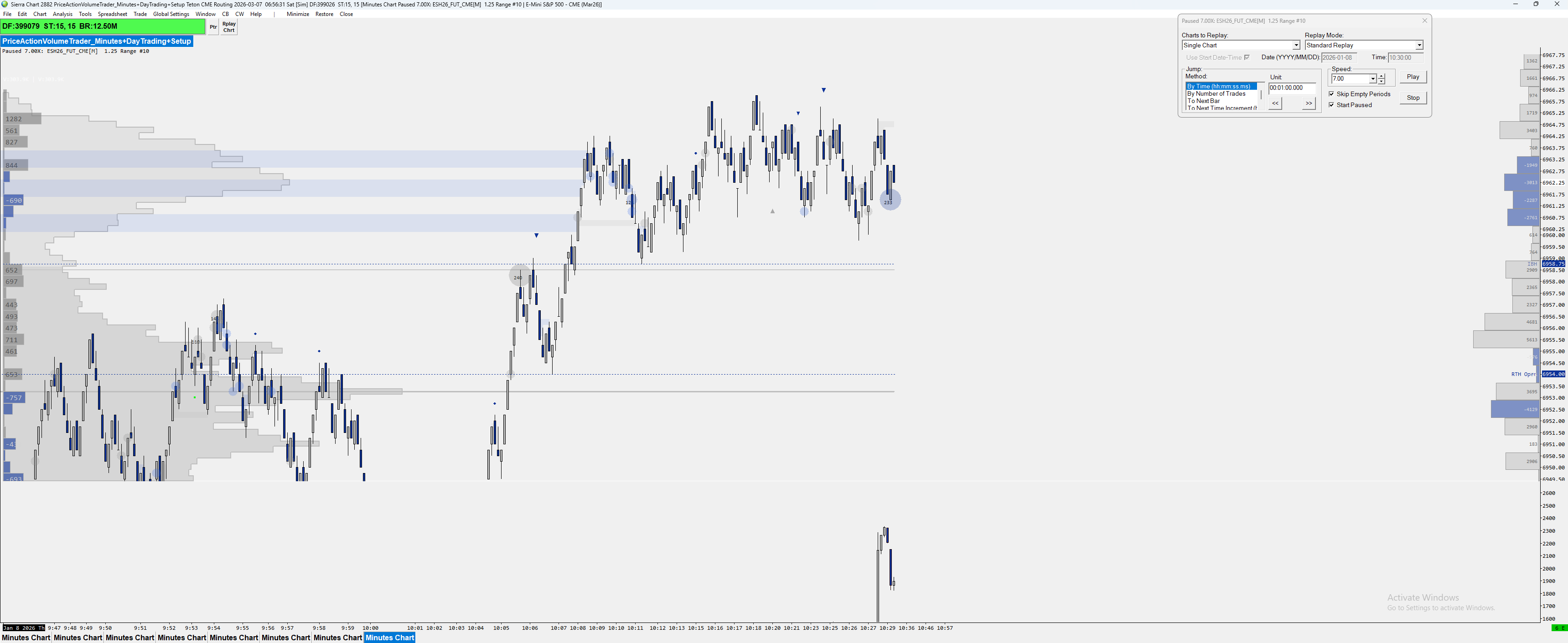

hi,
Tick per volume bar of volume profile study is set to 1.
And no doubt the volume profile remains the same reglardless the timeframe I am using. But if you look on first picture of ES chart, the VP isn't very SMOOTH, Its look more like blocks.

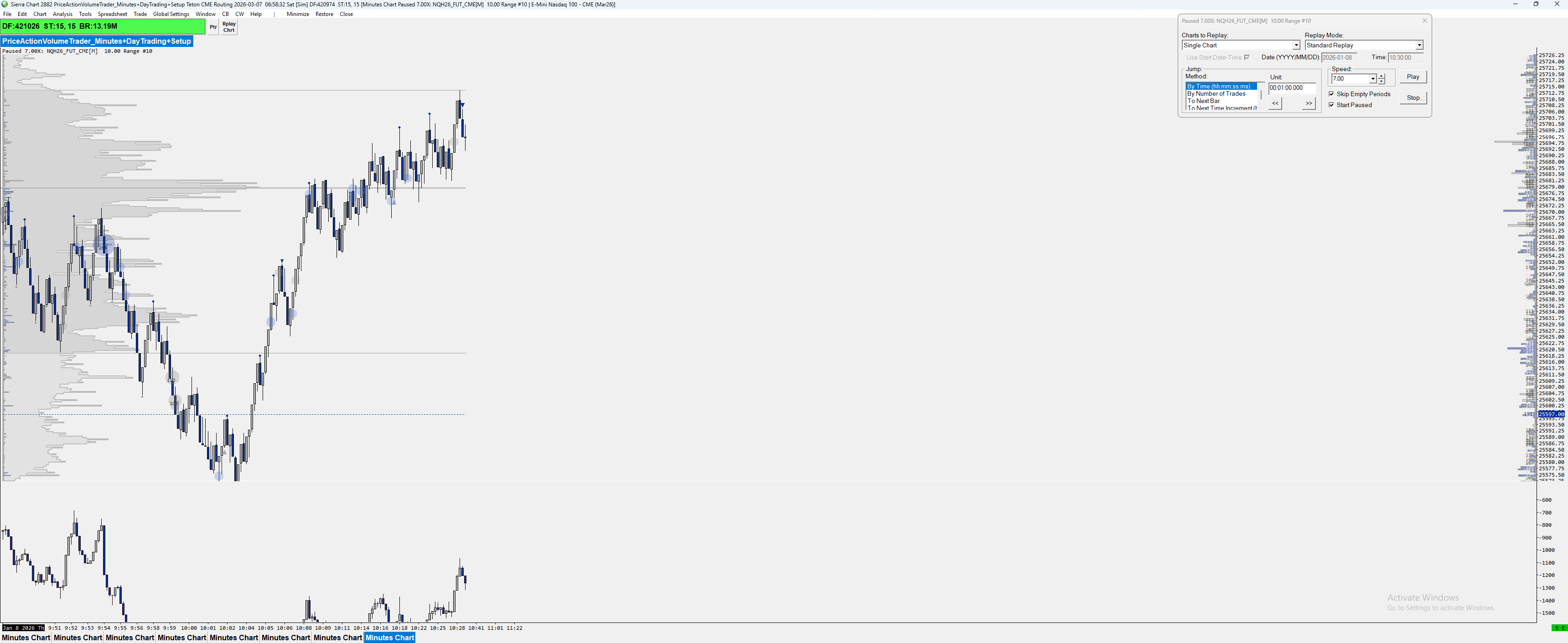

However if you look on second picture of NQ, the VP here is very smooth, and very clean
SO my REQUEST to you is that I want to make ES VP very very smooth, just like NQ one.
DO you able to understand, and again your help would be really helpful
imageScreenshot 2026-03-07 005635.png / V - Attached On 2026-03-07 06:59:11 UTC - Size: 149.43 KB - 161 views
imageScreenshot 2026-03-07 005835.png / V - Attached On 2026-03-07 06:59:22 UTC - Size: 194.93 KB - 162 views

For the ES chart, what is "Chart >> Chart Settings >> Symbol >> Tick Size" set to?
It looks like this is not set to 0.25, which is the actual tick size of that symbol. This would be a reason for the Volume by Price profiles to not be "smooth".

2 of your 3 profiles look fine and have the bars being drawn at every tick.
The one profile - VP Delta Daily (ID: 19) - is set to have a "Ticks per Volume Bar" of 2. So this one is going to be "blockier" than the others.
