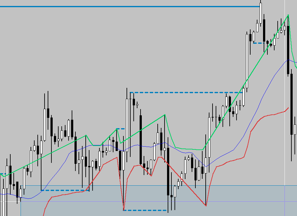

I have read the doc about DRAWSTYLE_LINE_SKIP_ZEROS and intend to use it to skip the zero values from drawing to see only non-zero values.
In the attached picture can be seen, the non-zero values being connected, but that is what I wanted to avoid, and the documentation says it should have been skip those points.
So what did I misunderstand?
HighVWMA.Name = "High SP VWMA";
HighVWMA.DrawStyle = DRAWSTYLE_LINE_SKIP_ZEROS;
HighVWMA.PrimaryColor = RGB(0, 210, 100);
HighVWMA.LineWidth = 2;
LowVWMA.Name = "Low SP VWMA";
LowVWMA.DrawStyle = DRAWSTYLE_LINE_SKIP_ZEROS;
LowVWMA.PrimaryColor = RGB(220, 60, 60);
LowVWMA.LineWidth = 2;
Thanks.

[2026-02-27 12:01:45]
User358514 - Posts: 16
the particular lines the green and red on the picture

ForgivingComputers.com - Posts: 1256
Have you tried this:
HighVWMA.DrawZeros = false;
LowVWMA.DrawZeros = false;
