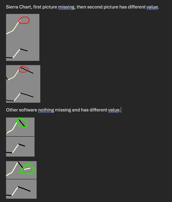

I notice sometimes (maybe once or twice a day) that the Stochastic Momentum Indicator (SMI) will not always create a line when a bar closes. I have attached a photo for this showing that with one type of settings it always forms the line when a bar closes, but then with the other settings (top settings) it usually finishes the line, but not always (though will complete it after the following bar closes, therefore doing two lines at once). I have compared the same settings to a different charting application and that charting application forms the line when Sierra doesn't. How can I fix this?

imageScreenshot 2026-02-26 082421.png / V - Attached On 2026-02-26 13:49:16 UTC - Size: 10.94 KB - 258 views

Sierra_Chart Engineering - Posts: 25489
We had a quick look at this. This would be the result of avoiding a division by zero condition. So the calculation does not take place. Not sure if anything can be done about this.
We implemented a solution for this. In the case of division by zero, the previous study value will be used.

Whiskers - Posts: 12
Can you please clarify what the solution was (how to implement)? Because I'm still seeing this as being an issue (the previous study value I don't think should be used, unless I'm misunderstanding), another screenshot attached with different bars. As I mentioned, comparing to another charting software, this temporary gap doesn't occur.

imageScreenshot 2026-02-28 195219.png / V - Attached On 2026-03-01 00:53:54 UTC - Size: 26.92 KB - 210 views
You need to update Sierra Chart to the latest release. Instructions:
Thank you! That works!
