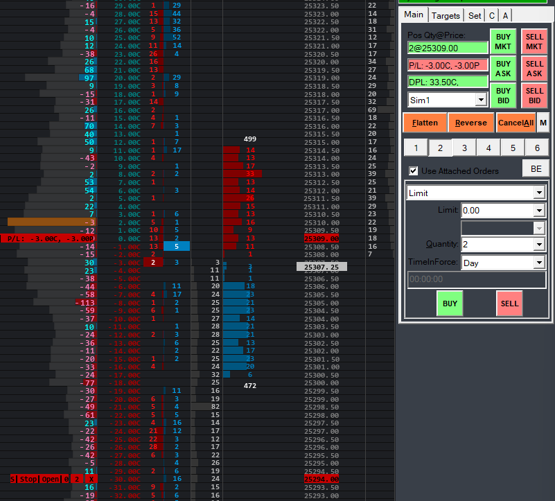

Haven't been able to figure this one out, but when I have an open position with multiple contracts, the P/L column and trade window are only reflecting the P/L for a 1 contract position (screenshot attached). (Chart setting > Trading > Profit/Loss Format is set to Currency Value (C) & Points (P) )
imageScreenshot 2026-02-25 231317.png / V - Attached On 2026-02-26 04:17:37 UTC - Size: 144.05 KB - 152 views

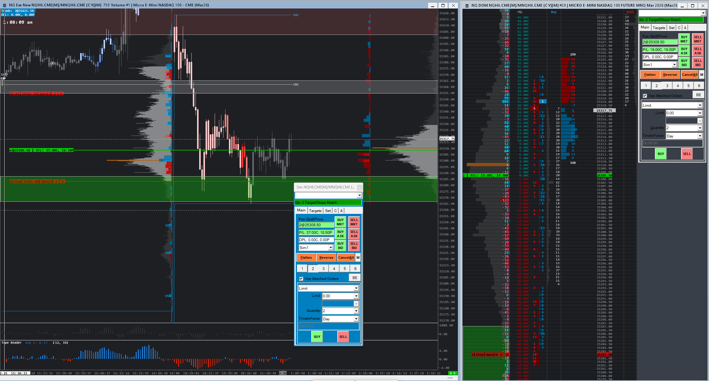

Here is another screenshot of my chart next to the DOM to better view the discrepancy.
imageScreenshot 2026-02-26 010815.png / V - Attached On 2026-02-26 06:08:45 UTC - Size: 364.24 KB - 135 views

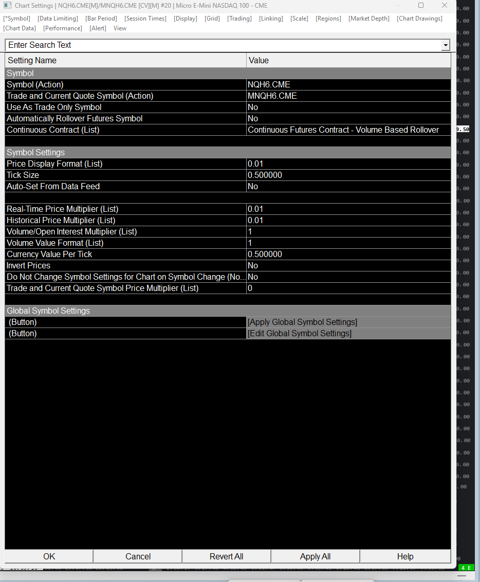

Ah....I adjusted my tick value to $0.5 (charting on NQ and executing on MNQ), but also adjusted the tick size to compress the DOM. I didn't realize I had to recalculate the tick value based on the tick compression.
All good now! Thank you again for your help!
imageScreenshot 2026-02-26 042441.png / V - Attached On 2026-02-26 09:26:56 UTC - Size: 87.88 KB - 155 views
