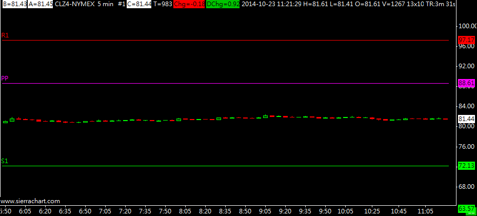

We need to see an image of the chart when you have the Pivot Points study on it.

Attached, please find this image.
http://www.sierrachart.com/image.php?l=1414084890383.png

[2014-10-23 19:09:56]
Go into the Scale settings for the Pivot Points study. Here are instructions:
http://www.sierrachart.com/index.php?page=doc/doc_Scaling.html#ScaleWindowStudy
Make sure the Scale Range is set to "Same As Region".
After this select Chart >> Reset Scales.

[2014-10-24 03:56:07]
We need to understand the nature of the problem.
After you follow our instructions, set the chart bars to 1 hour per bar and post an image of the chart by following these instructions:
