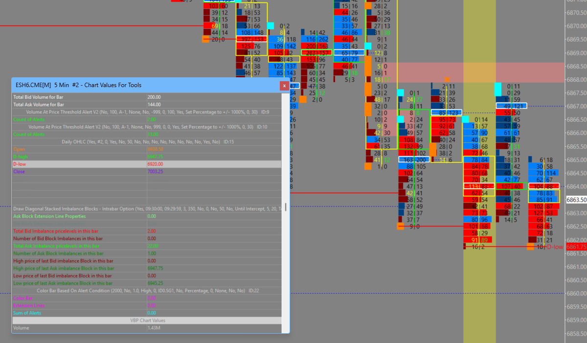

Sth is wrong here., see attached screenshot.
Even though the indicator paints correctly, it's values in the tool seem to be from the
preceding day, as clearly visible (value of line in the graph is smaller than the
"Daily low" in the tool window (highlighted). Any idea what is going on here? As you see in the tool config, the "reference days back" is set to 0,
as, I believe" it should. Very much puzzeled here.
https://www.sierrachart.com/image.php?Image=1771752854576.png
imageScreenshot 2026-02-22 102450.png / V - Attached On 2026-02-22 09:30:51 UTC - Size: 293.56 KB - 165 views

I am comparing the "D-low" ("low" value from daily OHLC study) in the
"chart value for tools" with the value in the chart.
The tool claims that the daily low is at 6920.00 (marked line), WHILE in the chart it is at
6181.75. So in some way, event though the tool is set to use the same day (reference days back=0),
the tool (and hence prob. my query) sees "sth different"

What is the Bar Period of the bars in that chart?
If they are 1 day bars, then you must have your crosshairs displayed on a different bar than the one you are referencing with the low of 6181.75.
[2026-02-25 14:52:39]
User138457 - Posts: 61
These are 5min bars. That is why I am so puzzled. This this all in the middle of 1 single day.

[2026-02-26 15:20:43]
We are not seeing any issues with the chart and with the Daily OHLC.
The one thing we want to point out is that you have the "Daily OHLC" set to "Graph High and Low Historically" to "Yes". As such, the value displayed in any particular bar will be the value of the low for that bar. From the original image you posted, the last bar to the right has a new low and the previous bars before it have values that are higher than it. We can not see what bar the crosshairs are set to in that particular image, but it must be a bar where the low happened to be at 6920.00.
