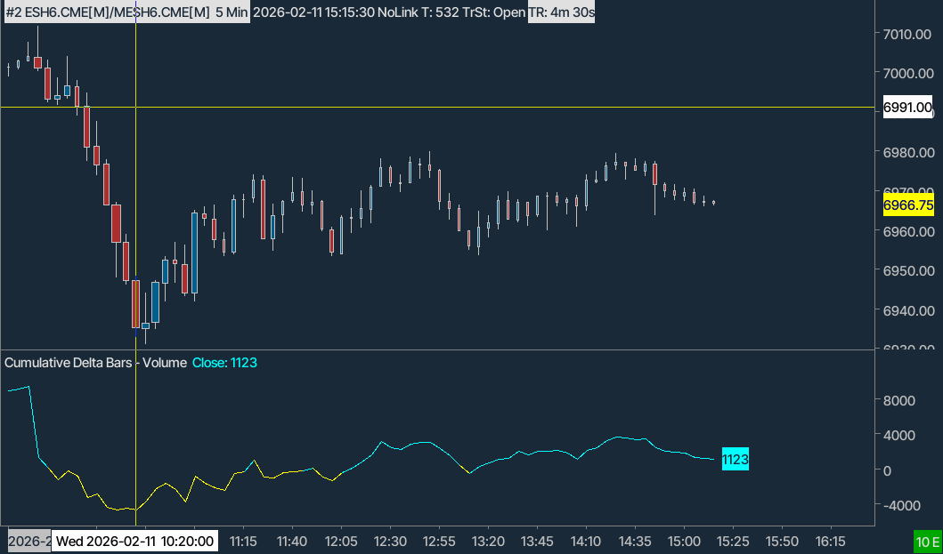

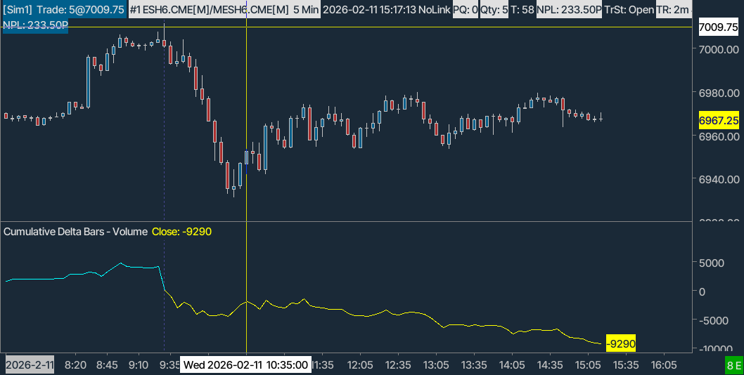

I have the 'Cumulative Delta Bars- Volume' study on a few different charts and instances.
Today I noticed that the one I was trading from did not match the others.
I double checked that the Chart Data was identical for each.
Oddly, the Chart Calculator tool also shows the ostensibly incorrect delta on the offending chart.
I removed all other indicators and duplicated a 'good' and 'bad' chart to a new chartbook where the problem persists.
Any idea what might be going on or what I may have overlooked?
https://www.sierrachart.com/image.php?Image=177084093150.png
https://www.sierrachart.com/image.php?Image=1770841034364.png

Check the settings on the Cumulative Delta Bars - Volume study. Do you have 'Reset at Start of Trading Day' or 'Reset at Both Session Start Times' set to yes on one of the charts and not the other? If these are both set to no, it'll give you cumulative delta for the number of days you have loaded on your chart.
[2026-02-12 12:53:35]
Brookwood - Posts: 45
Everything in the study is exactly the same.
But checking yet again all the chart parameters, in the Data Limiting section one chart had the Volume Filter set to >=10, a parameter I never used and have never messed with. Don't know how that changed-- #CatOnKeyboard effect...?
But it does give me an idea going forward about how I might implement this "happy" accident going forward.
Thanks for the reply.
