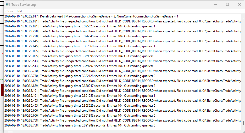

Please see the attached; popping up a lot when I start up the program

There is at least one Trade Activity Log file that is corrupted. You will need to delete the files that are called out in the Message Log.
You need to write down the list of the files that are in the Message Log and then exit from Sierra Chart. Then use the Operating System tools (File Explorer) to navigate to the Sierra Chart installation folder (typically C:\SierraChart, but may be different depending on where you specifically installed it). Then go to the "TradeActivityLogs" folder and remove the listed files (the full path to the files is given in the Message Log).
If you want to try to recover the corrupted files from backup, then refer to the following:
Trade Activity Log: Restoring Backups of Trade Activity Logs
