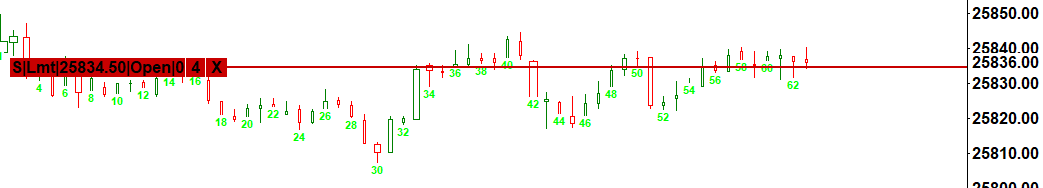

I'm submitting orders for multiple symbols from a single chart.
The chart for the 2nd symbol is open in the Chartbook.
Per the documentation, I am connected to the datafeed during the replay as the 2nd symbol's orders do no use the replay data.
However, I've noticed that orders for the 2nd symbol are not being filled despite the price oscillating around the order.

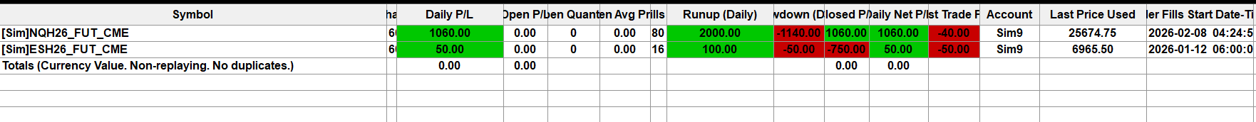

I've also noticed that the 2nd symbol's orders are not appearing in the TAL under the Trades tab but PnL is available for both symbols in the Chart Stats tab.
I've noticed that the Entry Time in the Trade Orders Window for the 2nd symbol is the current datetime vs the replay datetime which I assume is to be expected given that the 2nd symbol does not use replay data.
I'm using sc.AddMessageToLog but the Message Log is not updating. I do not have Disable Visible Message Logging enabled. However, I added sc.SetAlert with the same string as a test and alerts are being added to the Alert Manager.
I'm running tests over the weekend thus there is no live market data. Is the behavior I'm experiencing a result of needing to be connected to the live feed but doing so when the market is closed?
How can I receive trades and stats for both symbols in the TAL and ensure fills in the 2nd symbol when the price is crossed? I slowed the replay down multiple times but this behavior still persists.

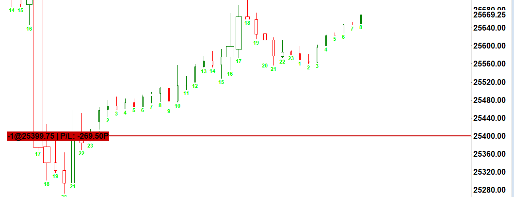

ISSUES:
1) The fill price for the 2nd symbol is incorrect. When using limit orders and submitting orders via BuyOrder or SellOrder for the Symbol of the 2nd Chart, the fills are away from the arrival price (see attached).
The example in the screenshot was just taken. The market is open but the fill price for the Symbol of the 2nd Chart is significantly away from the actual price during the replay. It's more in line with current prices not past prices.

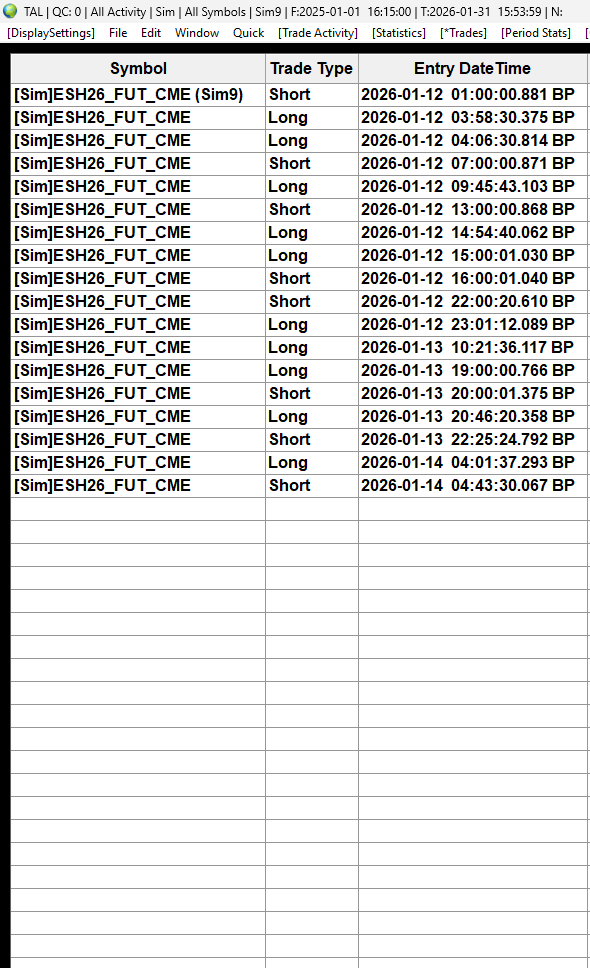

2) Chart 1 and Chart 2 are using the same trading account. Yet when checking the TAL for that account only orders for Chart 1 appear in the Statistics and Trades tab. However, PnL appears for both symbols in the Chart Stats tab.

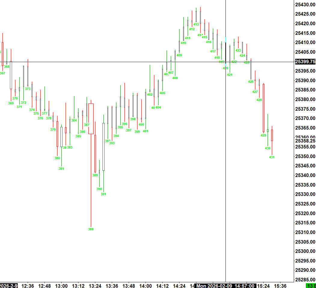

imageSierra 2nd Symbol Order Sent Away From Arrival Price.png / V - Attached On 2026-02-09 20:13:08 UTC - Size: 19.08 KB - 159 views

I checked the Trade Window for the Last Example where the fill price was significantly away from the arrival price.
I created a new chartbook and opened a 3min chart of today's current auction.
Per the Trade Window during the replay, the order for the symbol(i.e NQH26_FUT_CME) of the second chart was submitted at 15:01:12.402.
This was a market order.
The replay did not include today's date, thus the replay price was nowhere near the fill price.
Looking at the attached 3min chart of the current day's auction, we can see that the fill price during the replay for the second symbol was the actual market price at 15:01 today, despite today not being in the date range of the replay.
Bar number 421 on the 3min chart began at 15:00 and ended at 15:03.
The replay chart date was 1/6/26 and the market was trading 100pts higher but the fill was at today's price during the replay.
Yes this does make sense because when submitting an order, for a symbol other than the symbol of the chart, it will never use replay data. It is always going to use the current data received from the data feed.
Check the documentation for each of these windows/tabs. What they display is going to be based upon the documented settings for each of them. They are completely different with what they display.
