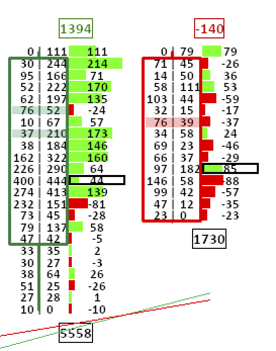

alright lads, looking at the attached footprint bars...
within each bar there is a transparent green coloured bar on one and a transparent red one on the other spanning both the ask and bid. i'd like to change this but i don't know how so the green only sits on the right not highlighting the left number and the red sits to the left not highlighting the right bar?

What are the following set to in that study:
- Column 1 Background Type
- Column 1 Background Coloring Method
[2026-02-02 20:54:02]
SafSaf - Posts: 160
full background
volume percentage
Date Time Of Last Edit: 2026-02-02 20:54:22
[2026-02-02 21:31:44]
There is no way to get the "Volume Percentage" to display only on one side of the Numbers Bars.
To get something like that, you would need to be using one of the coloring options that has a Bid and Ask side and then use a Background Type of "Background on Dominant Side".
