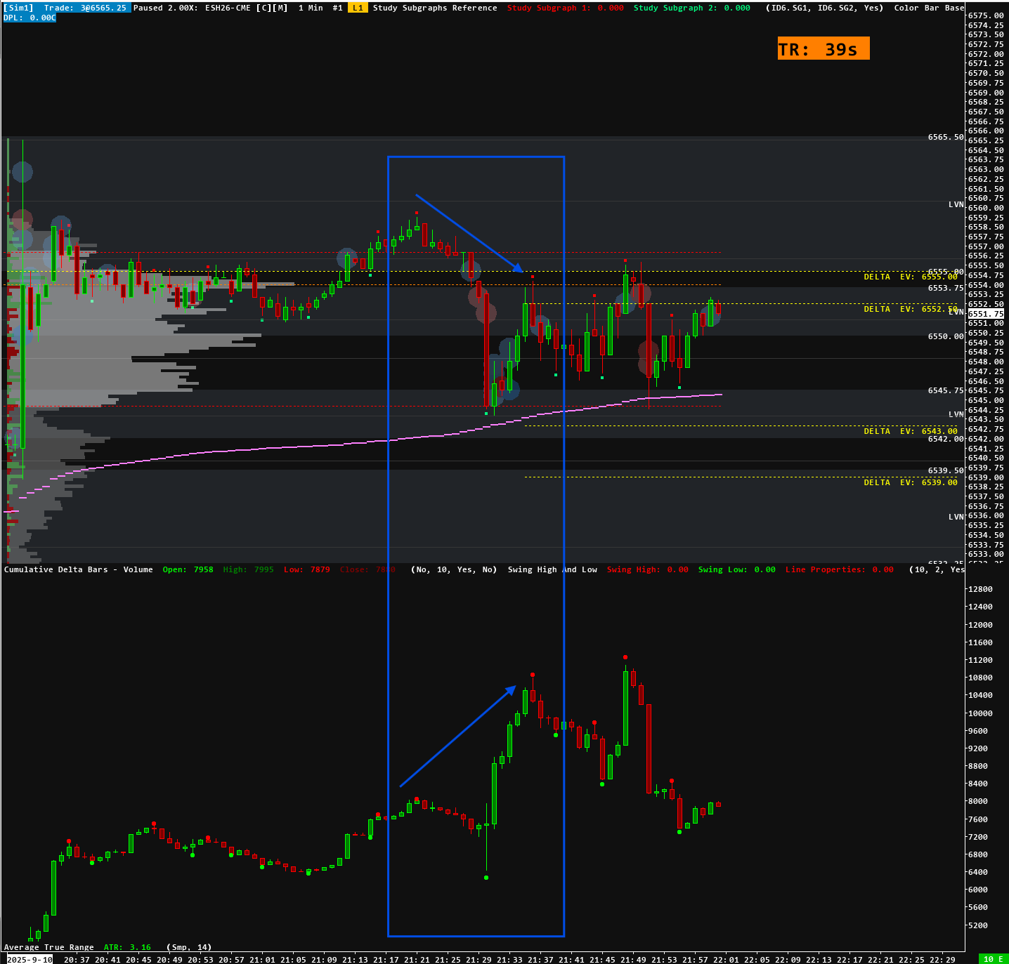

Good day,

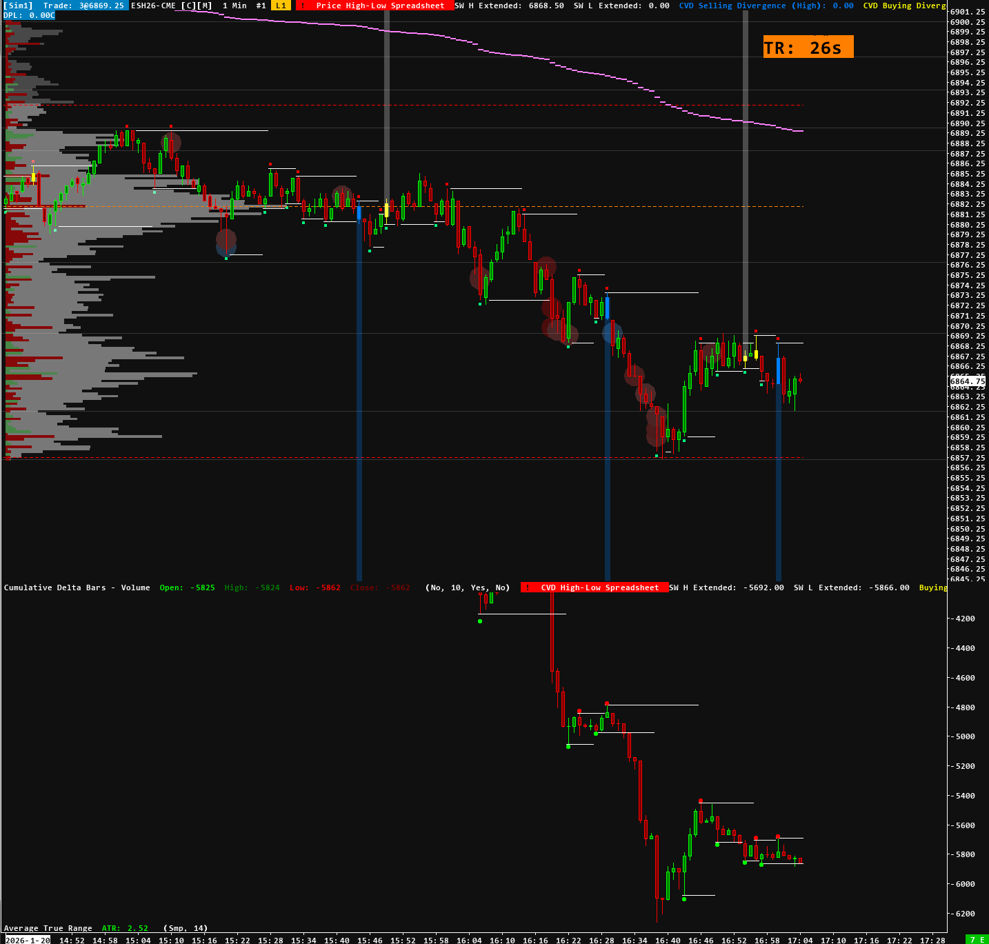

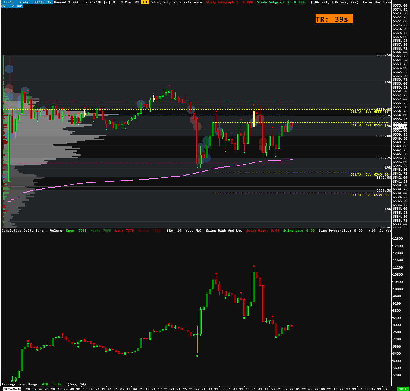

I am wondering how I could create a color bar alert condition for the divergence of a swing high/low study based on CVD and its study subgraph reference based on main graph. I am currently having trouble with referencing a range of [-3] bars and making the condition also reference the swing high on my CVD.
Here is my alert condition:
=OR( AND(
ID7.SG1 [-1] < 0,
ID6.SG1 [-1] > 0),
AND(
ID7.SG1 [-2] < 0,
ID6.SG1 [-2] > 0),
AND(
ID7.SG1 [-3] < 0,
ID6.SG1 [-3] > 0))
Where:
ID7 = Study Subgraph Reference
ID6 = Swing high and Low (On CVD)
SG1 = Swing High
SG2 = Swing Low
Date Time Of Last Edit: 2026-01-17 20:17:40
imageScreenshot 2026-01-18 041534.png / V - Attached On 2026-01-17 20:16:28 UTC - Size: 126.44 KB - 193 views
[2026-01-17 20:28:22]
jethrogou - Posts: 56
Updated Condition:
=OR( AND(
ID7.SG1 > ID6.SG1,
ID7.SG2 < ID6.SG2),
AND(
ID7.SG1 > ID6.SG1[-1],
ID7.SG2 < ID6.SG2[-1]),
AND(
ID7.SG1 > ID6.SG1[-2],
ID7.SG2 < ID6.SG2[-2]),
AND(
ID7.SG1 > ID6.SG1[-3],
ID7.SG2 < ID6.SG2[-3]))
Attached image is the result I want to get the color bar to appear in the previous post's attached image

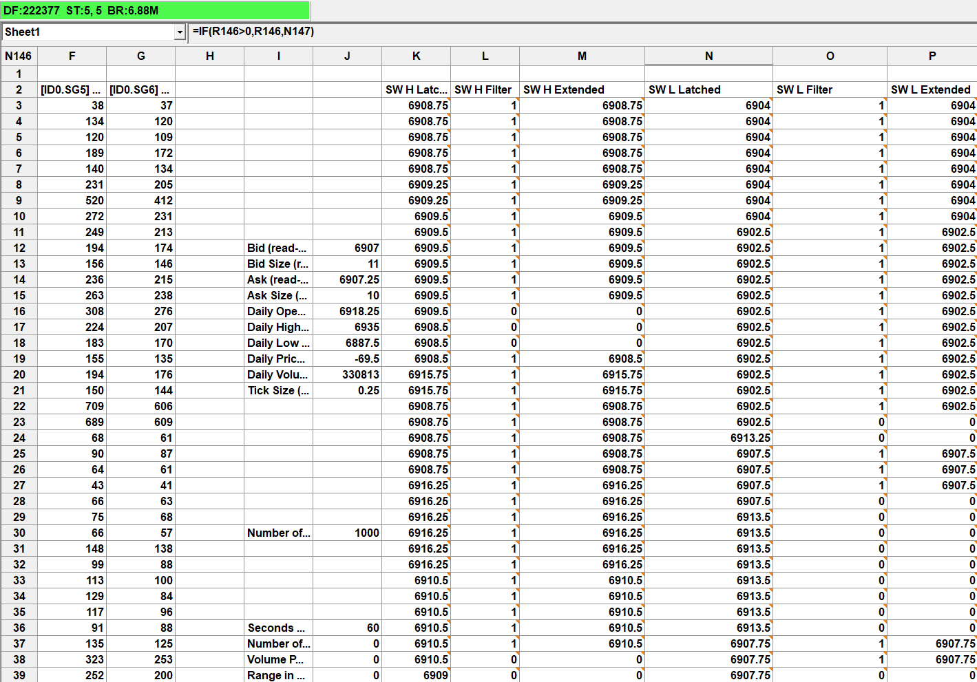

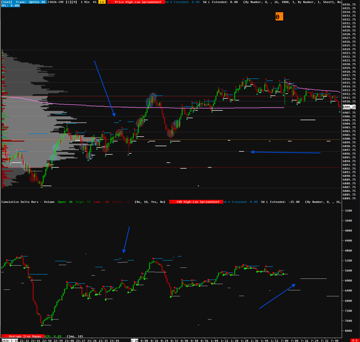

Good day,
I've recently discovered spreadsheet system/alert study to help me with my issue. But I encountered another issue when loading to current day's price. It was working the day I added the spreadsheet study but is now doing this. Its similar to Sawtooth's spreadsheet but I added some more conditions to a different cell which shouldn't cause an issue the original conditions.
Date Time Of Last Edit: 2026-01-20 04:57:06
imageScreenshot 2026-01-20 091743.png / V - Attached On 2026-01-20 01:18:17 UTC - Size: 122.11 KB - 158 views
imageScreenshot 2026-01-20 091924.png / V - Attached On 2026-01-20 01:19:45 UTC - Size: 101.47 KB - 190 views
[2026-01-20 03:56:45]
I was able to fix the issue by removing the spreadsheet study and adding it back again. Is there a way to not keep doing this?

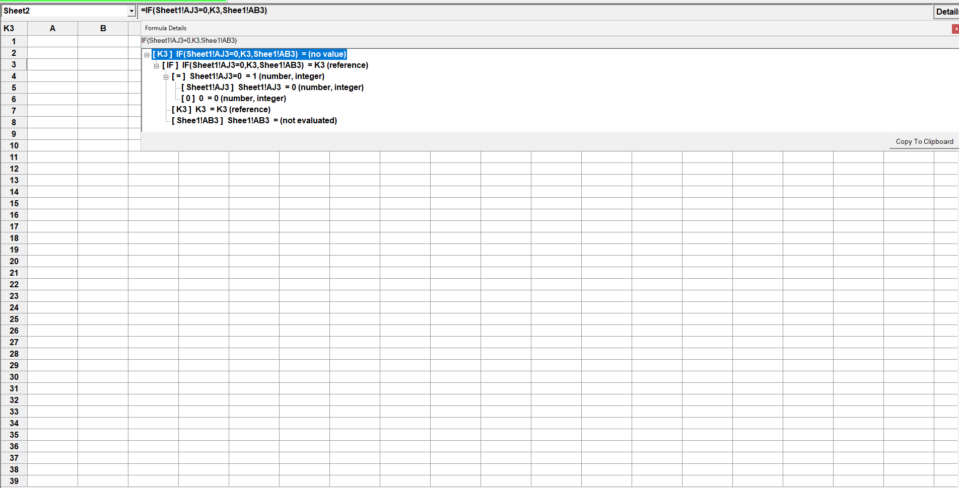

I'm also having trouble understanding how to pull data from sheet 1 into sheet 2 and having 1 formula cover a column similar to sheet 1.

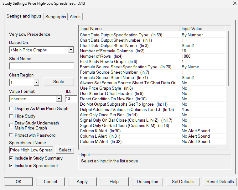

[2026-01-20 09:08:23]
All good now. I just decided to increase the cell formula and adjusted my conditions, but I'm still confused as to what the use of sheet2 is and how to configure it similar to sheet1. Overall happy with my work, didn't know you can do so much with the spreadsheet study.
imageScreenshot 2026-01-20 170440.png / V - Attached On 2026-01-20 09:06:06 UTC - Size: 109.34 KB - 176 views
[2026-01-20 14:03:58]
Sawtooth - Posts: 4361
By default, the Sheet# matches the Chart#, when adding a spreadsheet study to a chart.
However, if you go to Spreadsheet >> Add Sheet, it will add a blank sheet with the next available Sheet#.
This can be confusing, so best practice when adding a blank sheet is to rename it.
A blank sheet can be used when more complicated static conditions, or a matrix, need to be referenced by the chart's Sheet.
(You can also use Column H on the chart's sheet for simpler references, since it's a blank column.)
A blank sheet cannot be made to look nor function like a chart's sheet.
