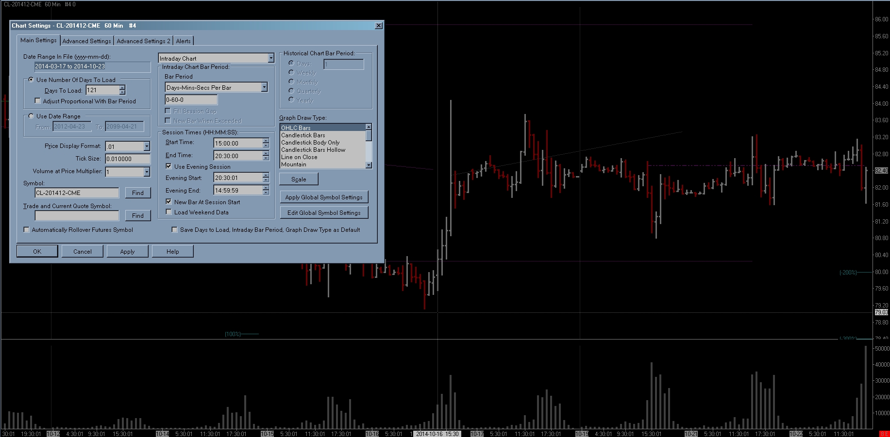

I assume this is broken since 1202.
Please refer to the picture attached.
For the CL (crude) Pit Session the bar should start 15:00 (CET) not 15:30
(see chart in the background with time at mouse cross-hair )
The evening/overnight session should start 20:30 (cet)
If I recall correctly, this worked before in sierra.
Date Time Of Last Edit: 2014-10-21 11:24:41
image2014-10-21_131207.jpg / V - Attached On 2014-10-21 11:19:04 UTC - Size: 450.41 KB - 593 views
[2014-10-22 00:32:57]
This only applies to the Evening Start Time and all bars are aligned to that time.
[2014-10-22 09:24:50]
Paul.M - Posts: 115
Do you plan to correct this in the future ?
"backward alignment" makes no sense for a trader.
From a traders perspective , the current handling creates a false picture of the Pit session.
The pit session is 15:00 - 20:30 cet
the overnight is the rest (20:30 - 15:00 cet)
Also, sierra generally has trouble with the weekend break in regard to session times.
I understand sierra works correctly for only the PIT session slice,
but CL is heavily traded overnight.
There are many markets with similar session breaks (Pit + overnight time),
but different start/end times (not at top of the hour).
So not only crude would benefit from this.
please give it a thought to optimize this in future versions.
TY

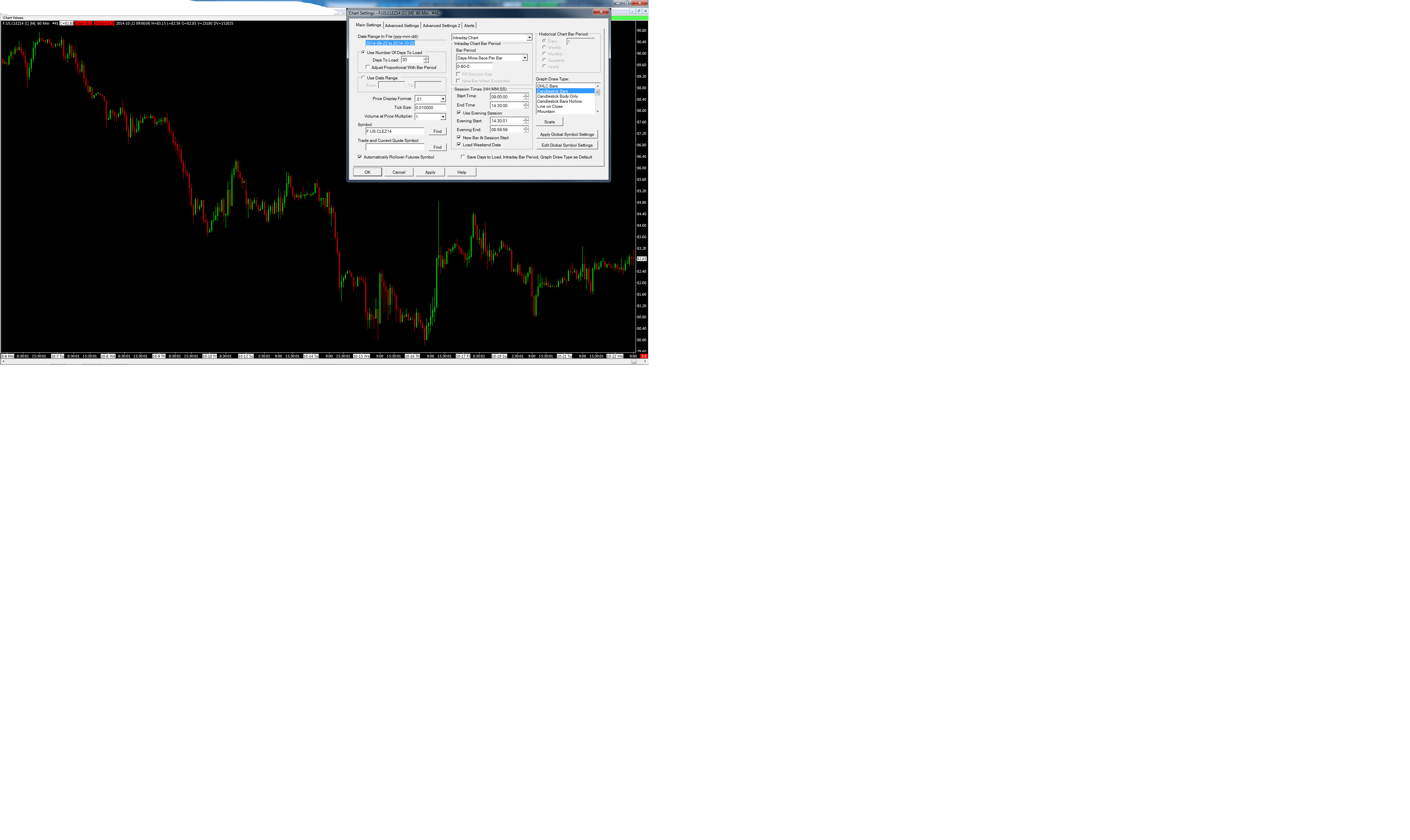

crazybears - Posts: 314
I'm on CET , but my pc clock is set to ET :)
did you noticed i started the evening session 1 sec after the close ?
imageCL.png / V - Attached On 2014-10-22 15:25:04 UTC - Size: 190.14 KB - 551 views

[2014-10-23 15:47:38]
yes see picture attached
did you try to click on some bars before the gap and select delete and download data ?
[2014-10-23 19:44:30]
Paul.M - Posts: 115
hi crazybears,
yes I did reload multiple times,
Please see my picture, my pit session starts NOT at the top of hour.
also, if you are right and your picture suggests so :) - the 1st reply from support seems to contradict this.
still waiting for their reply.
image2014-10-23_213429.jpg / V - Attached On 2014-10-23 19:44:03 UTC - Size: 453.75 KB - 561 views
