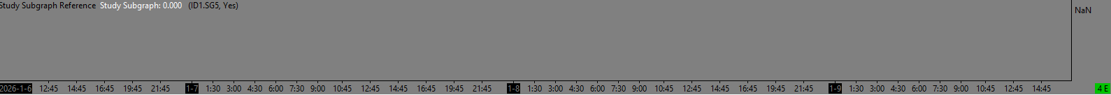

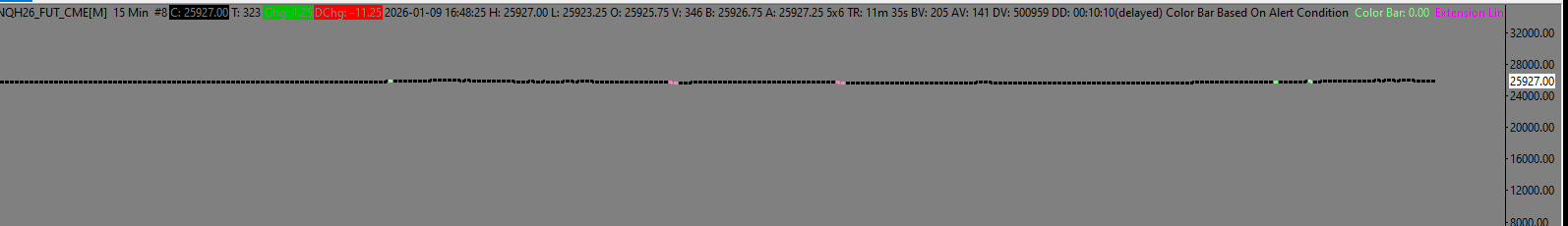

I'm trying to set up alerts ( triangle up/down) but I'm having the following issues. the subgraph is showing NaN and when I do and the chart is getting compressed. my formula is =IF(E3>Y4, 1, IF(E3<Z4, 0, " ")).

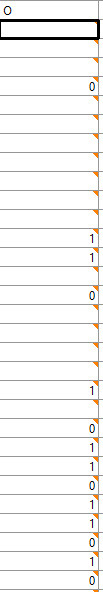

File attached
imageScreenshot 2026-01-09 165843.png / V - Attached On 2026-01-09 21:59:06 UTC - Size: 14.26 KB - 141 views
[2026-01-09 23:04:11]
A space is not a valid number. Your formula does not make any sense, as you are doing an initial test, but in your second test you are giving a value of "0" if true, but then nothing if not true.
Sierra Chart (and most programs) use a value of 1 (or non-zero) for True and a value of 0 for False.
We are not certain what exactly you are wanting to do with the formula you are using.
Also, if you want a triangle at a specific level, then you need to return the level at which you want the triangle. A zero value means do not display. Since you are in a spreadsheet, you can reference the Open/High/Low/Close of a candle for the result. For instance, you can have the following:
=IF(E3>Y4, ID0.SG2@3, IF(E3<Z4, ID0.SG3@3, 0))
Where ID0.SG2 is the High of the bar and ID0.SG3 is the Low of the bar. The @3 signifies to return the value at row 3 of the spreadsheet.

I'm trying to get buy and sell signals. so if the close is greater than the value of Y column , triangle up. If the close is less than value of z, triangle down. If neither condition is met, no signal

Try this:
Use two Formula Columns, one for each direction.
Triangle Up formula:
=IF(E3>Y4, C3, 0)
Then set the Draw Style to Triangle Up.
This will place the triangle at the bar High.
Triangle Down formula:
=IF(E3<Z4, D3, 0)
Then set the Draw Style to Triangle Down.
This will place the triangle at the bar Low.
[2026-01-12 17:34:35]
User411320 - Posts: 379
that worked thank you
