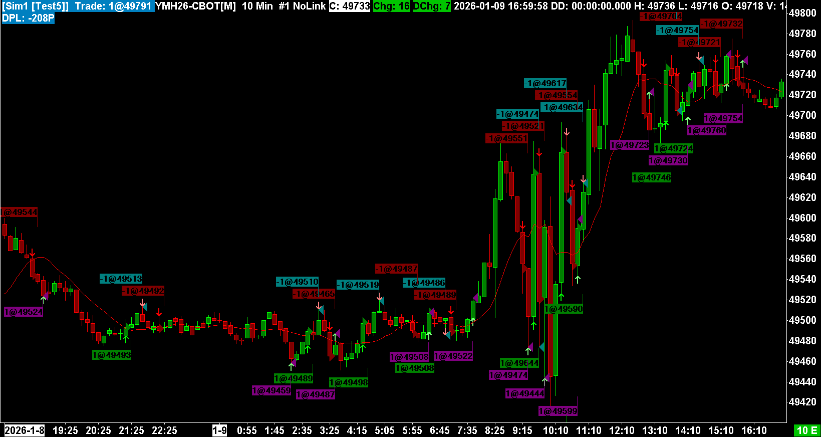

[2026-01-09 22:31:18]
Sierra_Chart Engineering - Posts: 25484
We ran a test using this trading system:
"Trading Example: Using Moving Average and Target and Stop"
Which you can find following the instructions here:
Automated Trading From an Advanced Custom Study: Example Trading Systems and Code
Trades occurred and you can see a large amount of them. See attachment.
So check your trading system code.
imageYMH26-CBOT[M] 10 Min #1 2026-01-09 17~30~21.418.png / V - Attached On 2026-01-09 22:30:52 UTC - Size: 35.92 KB - 220 views
