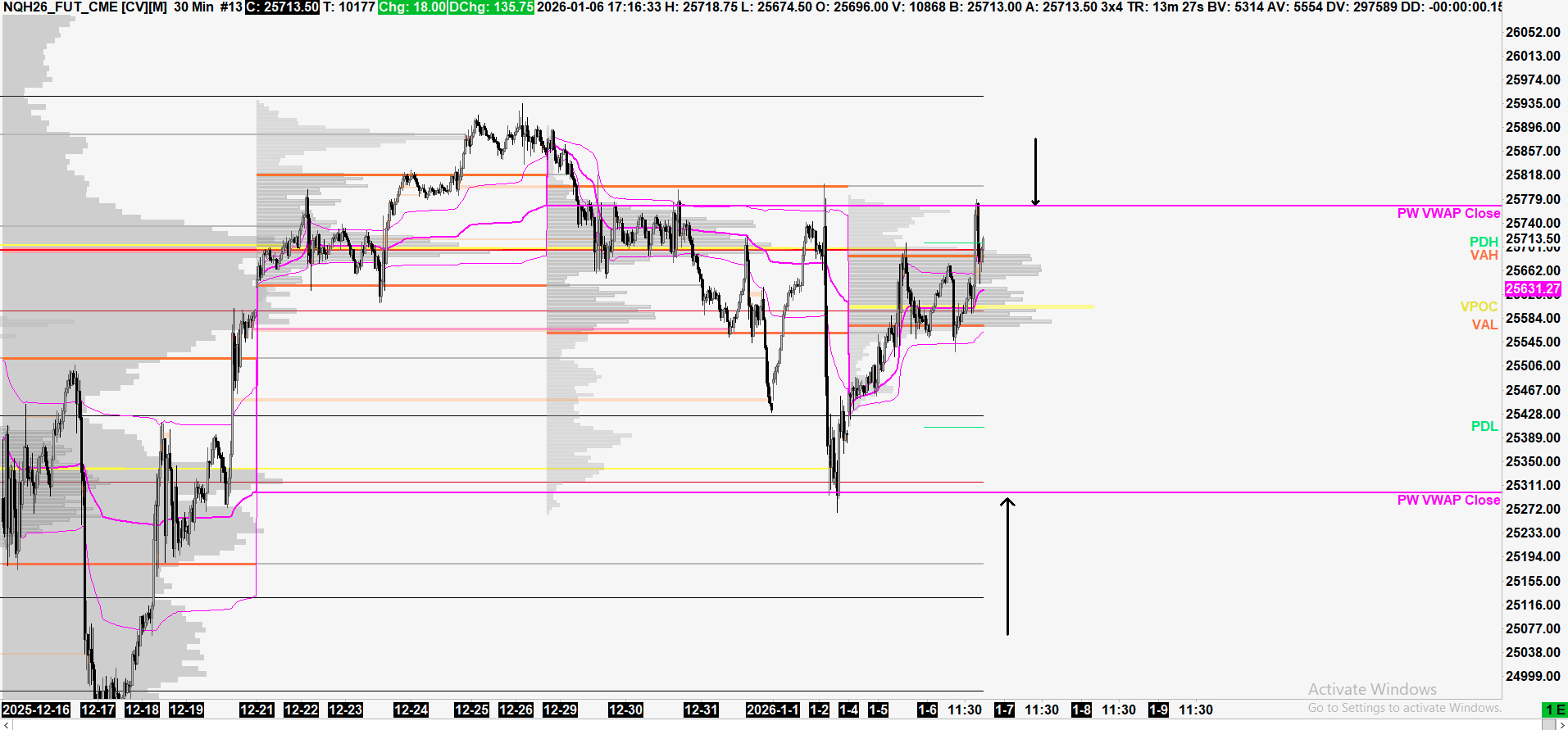

I have a chart that shows weekly volume profiles and VWAP. I would like my chart to label where the previous weekly VWAP's closed automatcally. Is this possible?
So far I cannot seem to fund any function that allows me to do this. Currently relying on manual mark ups. Any help would be greatly appreciated.
Example shows arrows with manual mark ups of previous week VWAP Closes
Thank you
imageScreenshot 2026-01-06 at 17.16.34.png / V - Attached On 2026-01-06 17:17:06 UTC - Size: 139.24 KB - 189 views

In order to have the Previous Weeks VWAP values displayed, you would need to add an additional Volume by Price study and set the following:
- Draw Mode: POC, VAH, VAL, VWAP Lines Only
- Number of Periods Back to Reference
- Volume Graph Period Type: Multiple Profiles Based on Fixed Time
- Time Period Type for 'Fixed Time': Weeks
- Time Period Length for 'Fixed Time': 1
Then in the Subgraphs tab set the following Draw Styles:
- Point of Control (SG2): Hidden
- Value Area High (SG3): Hidden
- Value Area Low (SG4): Hidden
- Volume Weighted Average Price (SG5): Line at Last Bar to Edge
For the Volume Weighted Average Price subgraph, turn on the "Value Label" to get the value displayed. Note that this will be displayed in the Price Ladder regardless of how you actually set it.

Only thing is it works for the current week VWAP but not for the previous week's. Is there something I am missing?
Thank you
[2026-01-06 18:28:48]
You should be getting the previous week's VWAP last value. The Input for "Number of Periods Back to Reference" being set to 1 specifies that you are wanting the previous period.
In order to do this, you need to have the items setup as we described. Another Volume Graph Period Type will not allow for the Number of Periods Back to Reference to be set to 1 (it will automatically be set back to 0).
[2026-01-06 18:38:20]
FXTWIN - Posts: 17
John, fantastic thank you so much.
That's done the trick!
Have a good day!
