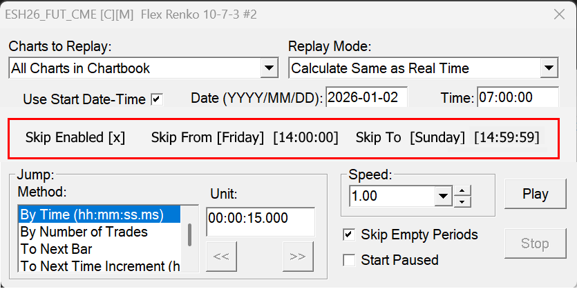

+1 for something like this suggestion.
Unsure how best to add a list of these using the current Dialog, but even a single Skip Enabled (checkbox), and Skip From [day of week] [time] and Skip To [day of week] [time] would be useful.
I might set that to
[x] and [Friday, 14:00:00 PT] and [Sunday, 14:59:59 PT]

imageSierraReplayMockUp.png / V - Attached On 2026-01-04 22:47:05 UTC - Size: 44.33 KB - 152 views
