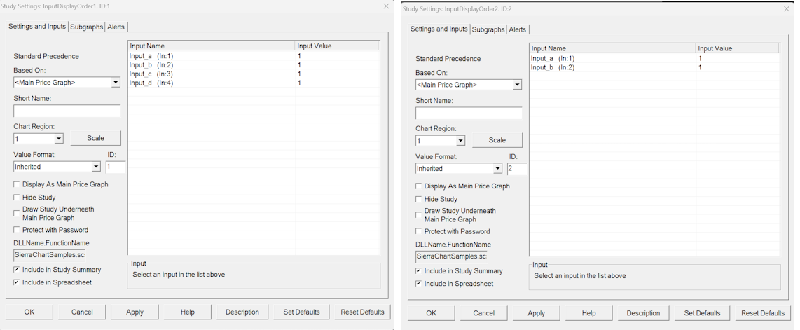

Hi Sierra Chart Engineering,
Use case is defining non-contiguous Inputs for internal use, turning some off between debug/release, dev/prod, and also saving room for new Inputs without having to make breaking changes and shift these into new IDs.
Code is below, and the screenshot attached that demonstrates the issue.
Expectation is both studies display all 4 inputs.

imageInputDisplayOrder.png / V - Attached On 2025-12-31 00:13:18 UTC - Size: 138.06 KB - 263 views

Yes we are aware of this. This is because there is a large skip of indexes at this point:
SCInputRef Input_b = sc.Input[1];
SCInputRef Input_c = sc.Input[58];
