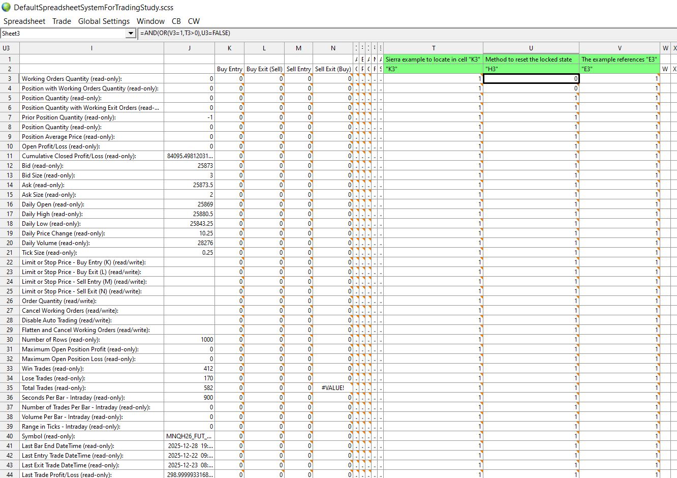

I have tried the information given here, Spreadsheet Studies Special Tasks: Locking the State of a One Time Condition
I already had some formulas in a spreadhseet, so I used different columns than what the example listed;
Sierra example "K3" is in Column T
Sierra example "H3" is in column U
Sierra example "E3" is in column V
I have transposed all column labels in all formulas as above.
After I enter the final command as listed in the example, I can sit here and watch Column U continuosly change from 1s to 0s in every visible row. Is that expected, and if so, I am a bit lost on which cell becomes my coondition-TRUE trigger. :)
The concept behind it is simple; If an indicator has a crossover, then I want the condition to become TRUE and remain TRUE until it is RESET by either a) a trade entry ( which will be at a later time via a different trade entry condition trigger), or b) until a different indicator returns TRUE (which would indicate that the TRUE state of the original latch cell was now FALSE).
See attached screenshot with the contents of cell "H3" displayed.
imageSierra screenshot.JPG / V - Attached On 2025-12-29 00:48:36 UTC - Size: 278.05 KB - 150 views

There are three cell references in the Sierra Chart example above. I have transposed those cells as follows;
Sierra Chart K3 = My spreadsheet's T3
Sierra Chart H3 = My spreadsheet's U3
Sierra Chart E3 = My spreadsheet's V3
There are two formulas in the Sierra Chart Example which I transposed to the columns I am using in my spreadsheet;
Formula #1
Sierra's version   =OR(E3=10,K3>0)
My version     =OR(V3=10,T3>0)
Formula #2
Sierra version   =AND(OR(E3=10,K3>0),H3=FALSE)
My version     =AND(OR(V3=10,T3>0),U3=FALSE)
There is one change that I made in my formula before I put it into my spreadsheet. Instead of using the number “10”, I am using the number “1”. Therefore, the actual formulas in my spreadsheet are as follows:
Formula #1
My version     =OR(V3=1,T3>0)
Formula #2
My version     =AND(OR(V3=1,T3>0),U3=FALSE)
In cell V3 I have entered “=1”. The column U in my spreasheet continuously turns from 1 to 0 to 1 to 0, over and over.
I have attached a PDF with colors showing the cell transposition, and a video that shows the cells going back and forth from 1 to 0.
Date Time Of Last Edit: 2025-12-29 21:04:34

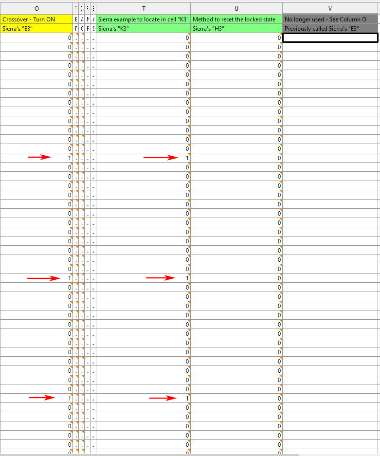

Sawtooth - "An easier way to do what you want is by creating a persistent TRUE variable in a Formula Column, using two IF statements, like this in W3:
=IF(IndicatorCrossover,1,IF(OR(TradeEntry,2ndIndicatorTRUE),0,W4))"
That is actually similar to how I started. When I could not get it to work as intended I went to the Sierra Help section.
I have changed my spreadsheet so that Sierra's "E3" reference has been now replaced with my crossover trigger column, which in my spreadsheet is Column O.
In this screenshot Sierra's "E3" is represented by my cell "O3". I have red arrows where there was a crossover event that produced a 1 in column O. Sierra's K3 does produce a 1 in that same row, but it is not staying as a 1. Attached is a screenshot of how Sierra's formulas are resulting. One of those two columns highlighted in green (presumed Sierra's K / my T) should stay as a "1" after the initial Crossover.
Column U in my spreadsheet is assumed to be the latch reset condition. I have it exactly as Sierra's example, but with the cell names changed. =AND(OR(O3=1,T3>0),U3=FALSE) . But even if I delete all content in cell U3, it does not change anything in Column T.
I will keep messing with it
imagecolumns.JPG / V - Attached On 2025-12-29 22:28:03 UTC - Size: 184.35 KB - 144 views

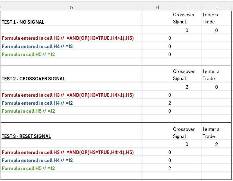

TraderGD - Posts: 19
Sawtooth,
I built a very simple test spreadsheet in Excel to try the first formula you suggested. I am uploading a screenshot. I used H3-H5 as the first of the three tests, the other two tests are transposed but identical function. The result in cell "H3" seems to remain 0 regardless of the other results.
imageTEST.JPG / V - Attached On 2025-12-30 15:34:41 UTC - Size: 74.07 KB - 180 views
[2025-12-30 16:55:49]
Sawtooth - Posts: 4362
To test this example, do these steps:
1. Put this formula in H3: =AND(OR(H3=TRUE,H4>1),H5)
2. Put 1 in H4.
3. Put 1 in H5.
4. Put 2 in H4. H3 goes from 0 to 1.
5. Put 1 in H4. H3 stays 1 after the locking condition is removed.
6. Put 0 in H5. H3 goes to 0, lock is released.
7. Put 1 in H5. H3 stays 0, ready for the next lock.
Note: This does not work in Excel. This only works in Sierra spreadsheets.
