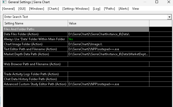

John - SC Support - Posts: 48273
In one of the sub-instances (if you can still open one of them) please tell us what the following is set to:
- Global Settings >> General Settings >> Paths >> Data Files Folder
[2026-01-02 19:37:41]
lovelivelaught - Posts: 95
Here it is. I attached the screenshot from my subinstance#6

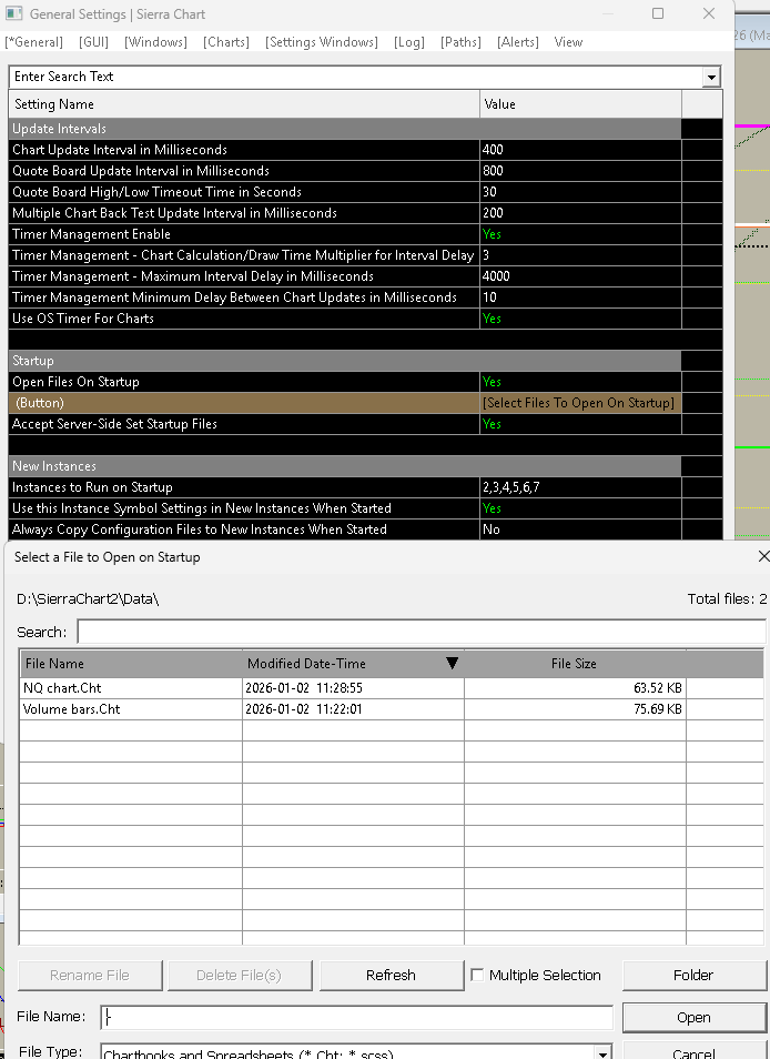

[2026-01-02 20:01:33]
In that same sub-instance, please get us an image of the window that comes up after you go to "Select Files to Open on Startup" and you select the "Add" button.
[2026-01-02 20:25:42]
These 2 files I added to main instance
I also tried to use the folder button and go to Subinstance#6 data folder but that data folder was not opening.
imageScreenshot 2026-01-02 132254.png / V - Attached On 2026-01-02 20:23:21 UTC - Size: 30.92 KB - 149 views
[2026-01-02 23:18:14]
This is the image of the General Settings and file selection for Sub-Instance #6? It looks like sub-instance #2.
Also, if this is from a Sub-Instance, then the entry for "Instances to Run on Startup" should be blank. We think this probably occurred due to a copy of the Main Instance settings to the sub-instances.
[2026-01-02 23:56:19]
Yes as i mentioned that i was moving files between all substances to re-arrange new chart books with my Teton Sierra.
At this point I set up to open files on start up from main instance. As long as it will not distract the function of sierra performance I am ok to use it as it is.
