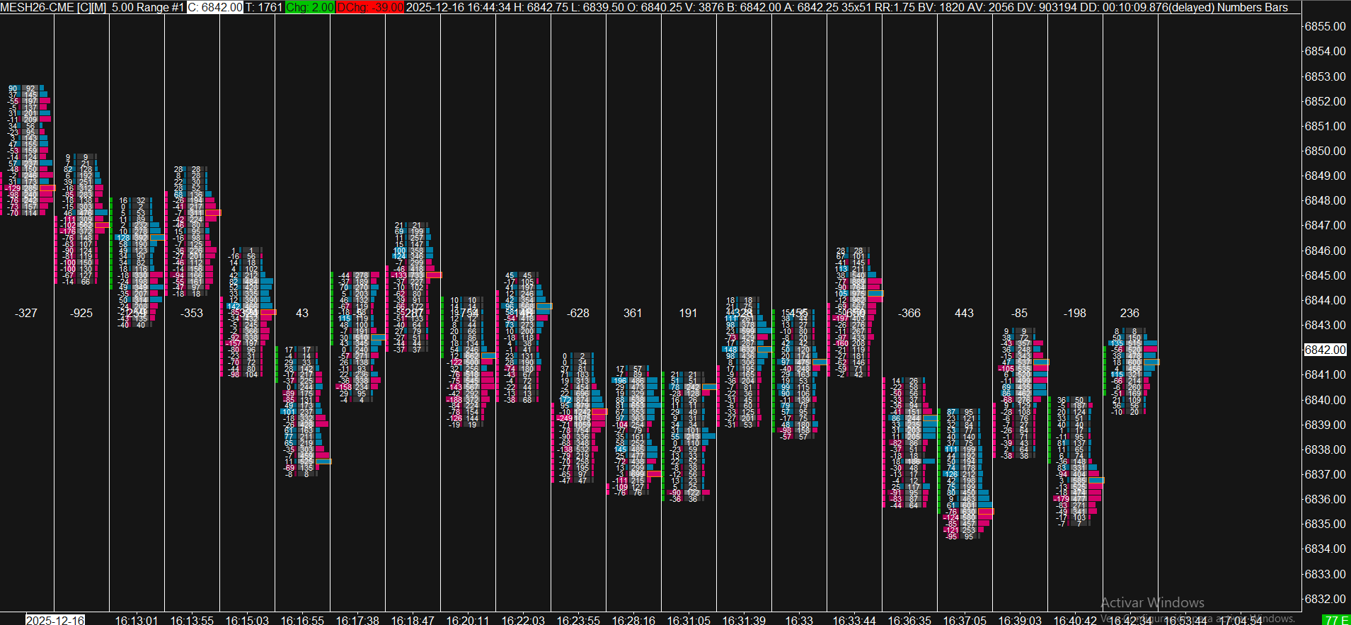

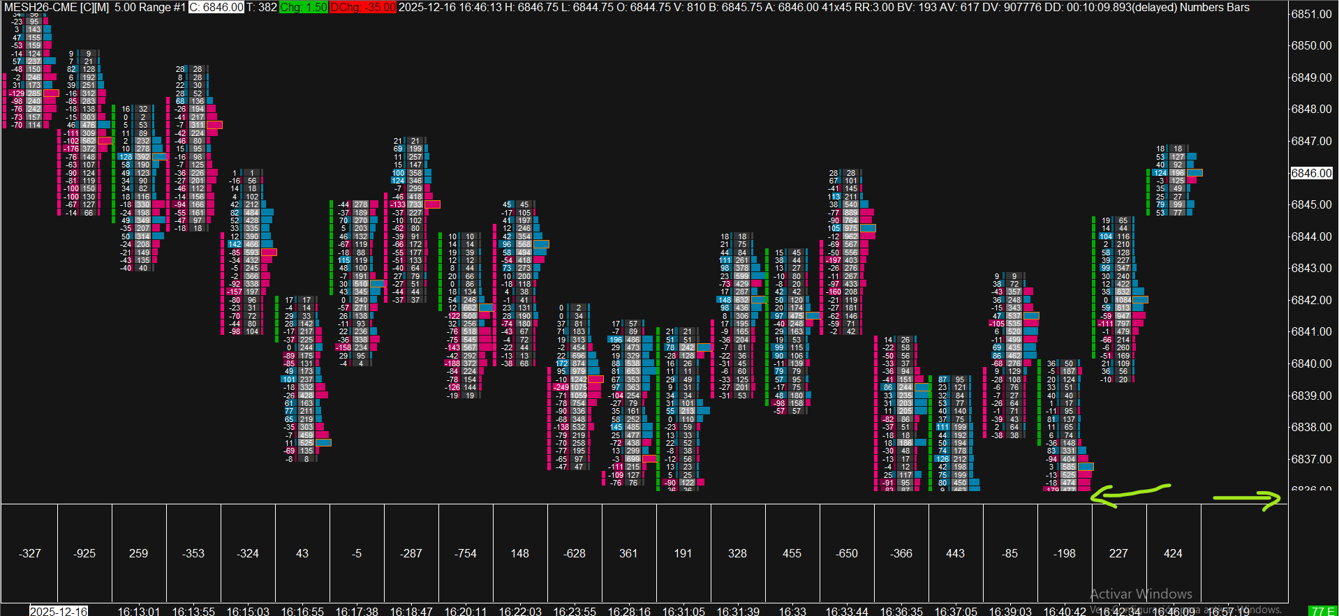

I was seting up my footprint chart and i have an issues with Numbers Bars Calculated Values settings. What i want to do, is to have my footprint and Calculated Values in the same region, so the price scale on the right and the footprint dont cut off like on the second screenshot when benig in different regions.
Moving Calculated Values to Region 1 fixes all of those problems, but then the numeric table extends to the top.
The perfect solution would be just to drag the top of the nummeric table lower to make it smaller but i am not able to do it.
Is there a fix for this ? Thank you in advance).

imageCaptura de pantalla 2025-12-16 175515.png / V - Attached On 2025-12-16 16:55:49 UTC - Size: 217.16 KB - 177 views
imageCaptura de pantalla 2025-12-16 175639.png / V - Attached On 2025-12-16 16:56:52 UTC - Size: 199.16 KB - 200 views

What you are specifically trying to do will not work. You can not have a "Numbers Bars Calculated Values" study displayed with the main chart, or another study.
The solution, however, is to display the data you want in the main region. For instance, in your image you have a single value being displayed in the Numbers Bars Calculated Values. You can display those values at the High or Low of each bar by using the "Study Subgraph Above/Below Bar as Text" study and reference the subgraph from the Numbers Bars Calculated Values. Refer to the following:
You can then hide the Numbers Bars Calculated Values if you do not need the table itself anymore.
