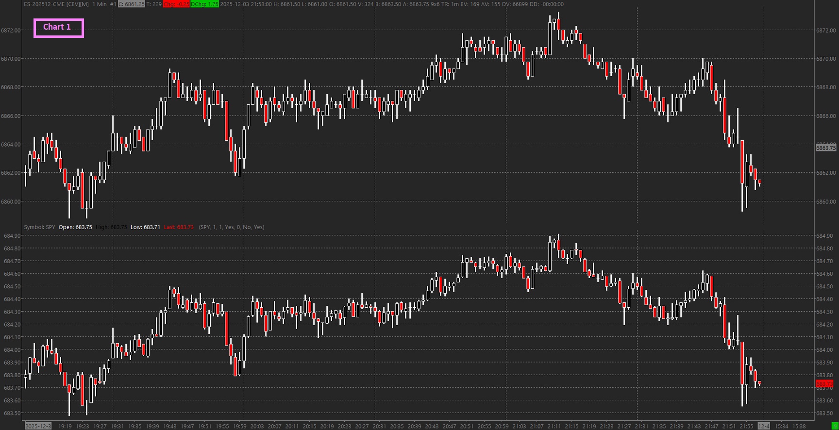

Chart 1:
Used “Add Additional Symbol” to insert the symbol ‘SPY’ into chart “ES.”
Chart 2:

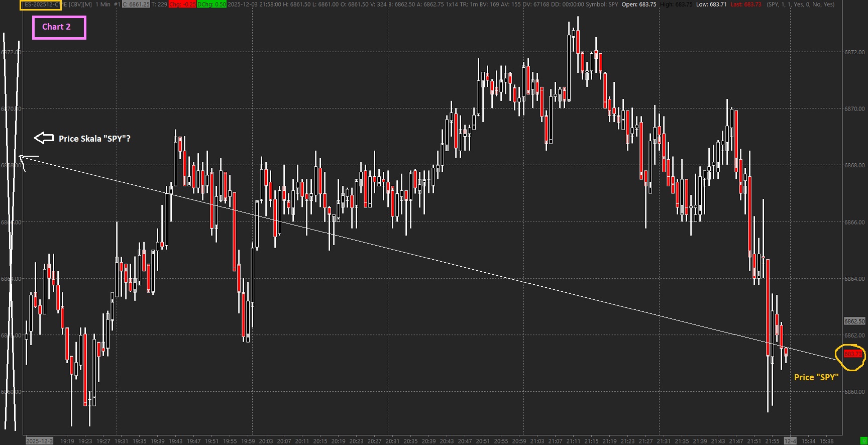

Inserted symbol “SPY” into chart region 1 for “ES.”
How can the prices for “SPY” be displayed on the left scale in Chart 2?
The right scale should continue to be the price scale for the symbol “ES.”
Thank you very much for your help.

imageChart 1.jpg / V - Attached On 2025-12-04 11:20:53 UTC - Size: 359.59 KB - 160 views
imageChart 2.jpg / V - Attached On 2025-12-04 11:21:00 UTC - Size: 261.33 KB - 156 views

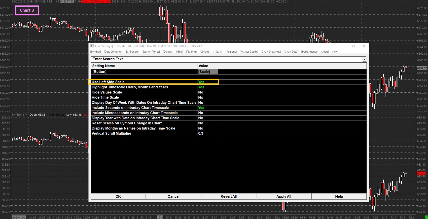

[2025-12-04 16:27:19]
User582870 - Posts: 28
This function is enabled. (see Chart 3)
In Chart 1, you can see the prices of ES & SPY on the left side of the chart.
Since SPY & ES are “running parallel,” I would like to see:
1. ES & SPY in one chart,
2. SPY prices on the left side,
3. ES prices on the right side.
Is that clearer?
Thank you.
imageChart 3.jpg / V - Attached On 2025-12-04 16:27:10 UTC - Size: 390.49 KB - 190 views

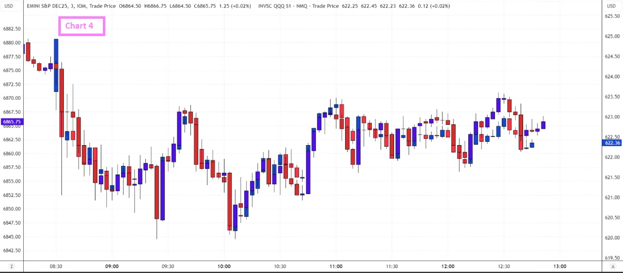

[2025-12-04 19:10:23]
I am trying to understand your instructions.
It should look like Chart 4.
imageChart 4.jpg / V - Attached On 2025-12-04 19:10:18 UTC - Size: 126.59 KB - 197 views

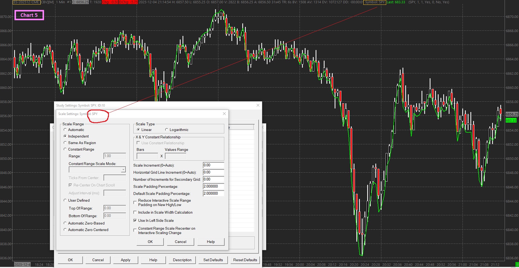

[2025-12-04 20:19:12]
These settings are available for the SPY symbol. (see Chart 5)
The left scale is not automatically adopted from the SPY prices.
It continues to show the prices from the ES-202512-CME symbol.
imageChart 5.jpg / V - Attached On 2025-12-04 20:19:06 UTC - Size: 389.32 KB - 180 views

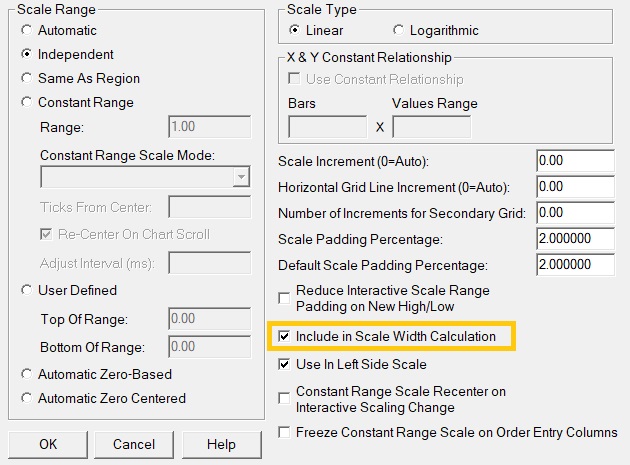

[2025-12-10 21:21:21]
Solution found
Checkbox in “include in Scale Width calculation” was missing
imageBild 1.jpg / V - Attached On 2025-12-10 21:21:08 UTC - Size: 103.29 KB - 165 views
[2025-12-10 22:19:03]
We tried that with your chart and it did not resolve it for us. But we are glad you got it working, as we have not had the time to delve into this yet.
