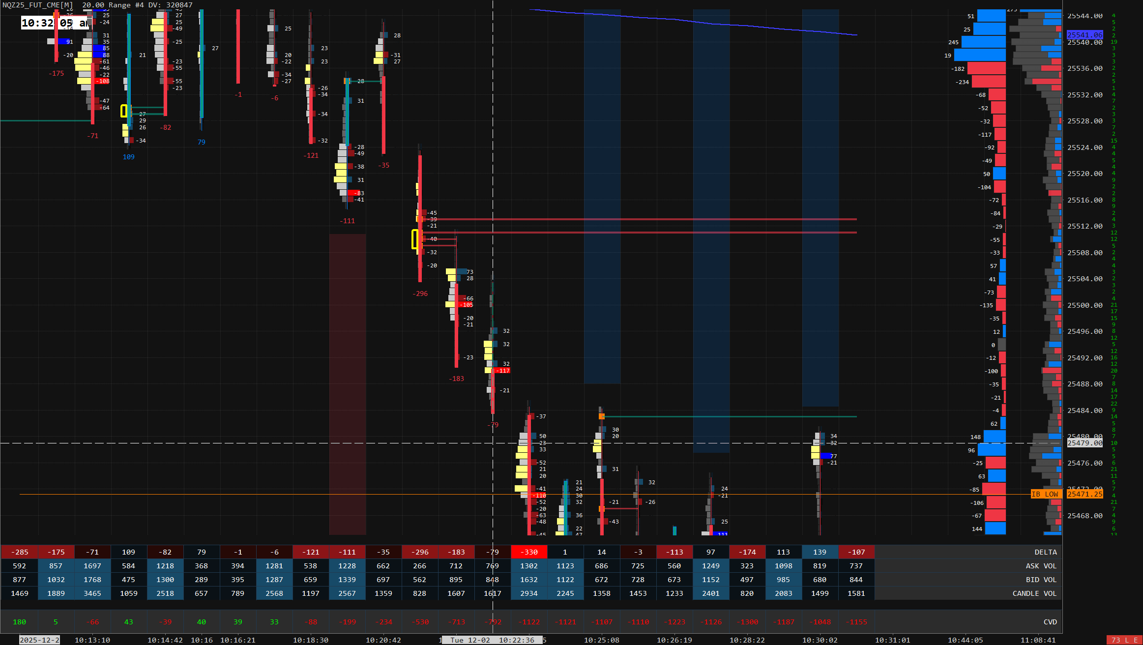

I am using stacked imbalances with a 4 tick multiplier. I have Draw Extension Lines to All Prices in Adjacent Alerts and also Transparent Range set to Yes.
I cannot get the extended lines to make a continuous box, it appears to only want to highlight each level as a solid line. Is that due to the multiplier? The yellow Adjacent Alert Highlight appears to highlight the entire contiguous levels but I cant get the extensions to do the same.
Any suggestions? Thanks so much!

John - SC Support - Posts: 48169
The issue is that you have a tick multiplier being applied, and the study does not see that this is the case and therefore does not know to set the extension lines to cover the entire range of this multiplier.
We have noted this as a Feature Request. We just can not say when we would get to any particular request.
We are not certain when it was added, but the "Volume at Price Threshold Alert V2" does respect the setting of the "Volume at Price Multiplier".
