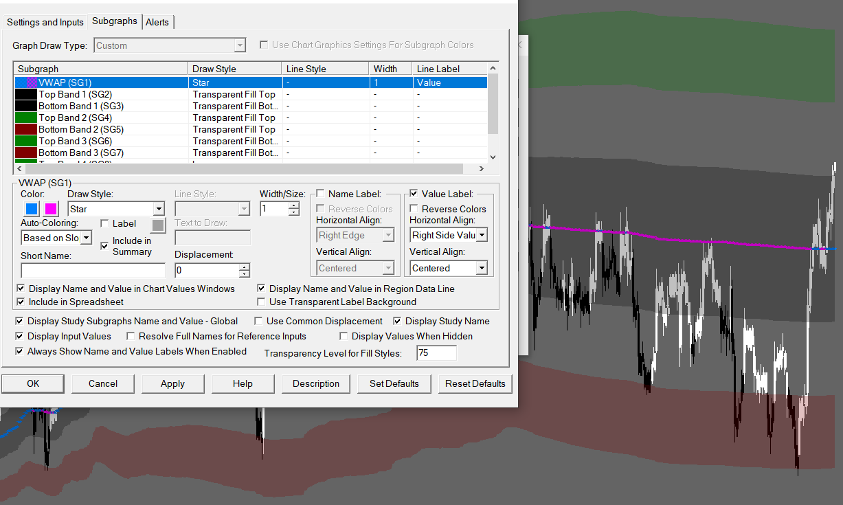

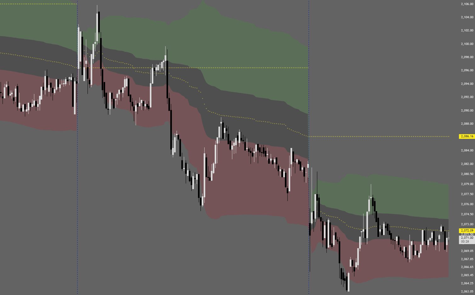

Hi - I am unable to replicate the VWAP bands as per the attached screenshot, named 'requirement'.
I tried using various combos in draw style, but failed to get desired result. Best result I could get is attached as screenshot named 'nearest result.'

imagerequirement.png / V - Attached On 2025-12-02 11:01:34 UTC - Size: 81.07 KB - 191 views
imagenearest result.png / V - Attached On 2025-12-02 11:01:42 UTC - Size: 71.21 KB - 142 views

We are not understanding what is different in the images that is the issue. You seem to have the bands colored as you want them. Please give us more information on exactly what is missing.

The 'requirement' image is of Tradingview, which I wanted to replicate in SC.

You do not need multiple copies of the VWAP study. But you would want to use multiple copies of the "Study Subgraphs Reference". Each copy will give you a single band as you want it. Refer to the following:
Note that the default scaling for the Study Subgraphs Reference is "Independent", you will want to set it to "Same as Region" to get everything to line up properly.
Also, once you have it setup, you can then hide the original VWAP study.
