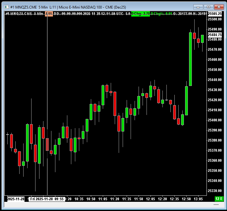

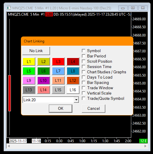

My chart link through Link number field on region data line is not working (attached pic 1). It's been working all the time. I usually just click the link number on the chart, the chart link window will appear (attached pic 2). I don't know what setting I did to lock it. I've searched all the information from the web and couldn't find any hind. Please kindly to help me. Thanks a lot.

I've found the cause. That was I enable the OpenGL for chart graphics on the Graphics Setting. Sorry for any inconvenience.
