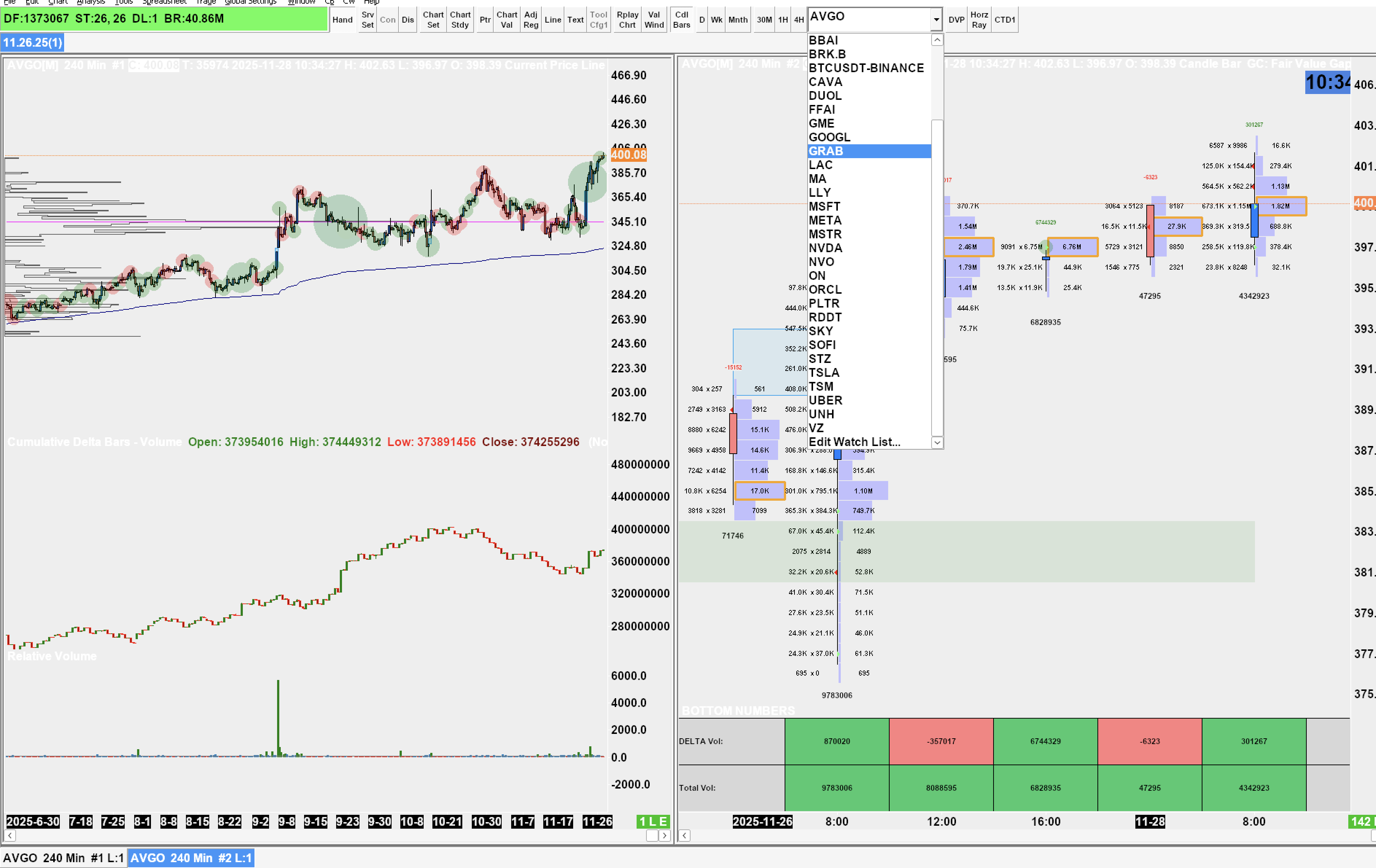

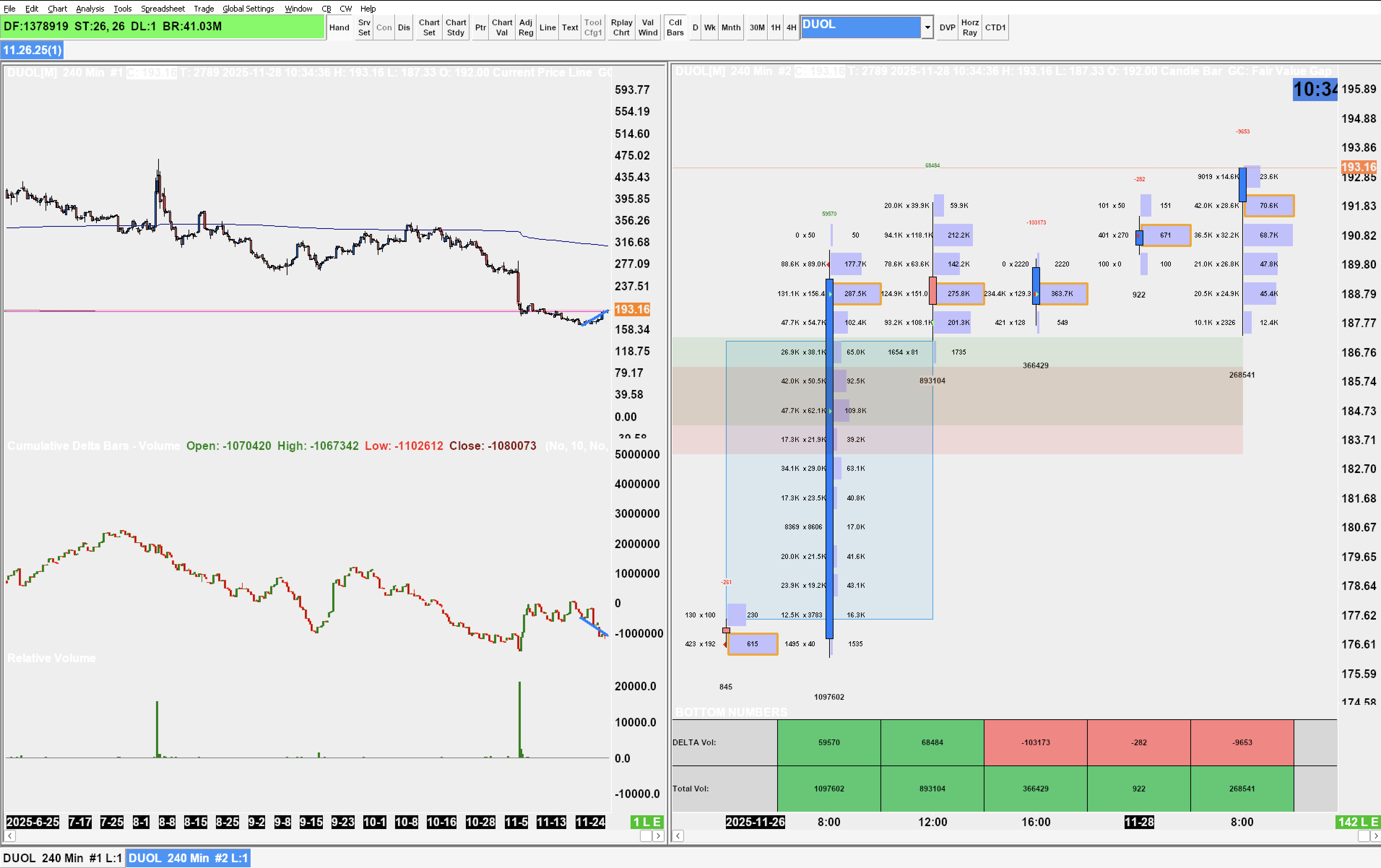

Hello. Every time i click on a stock listed in my watchlist, it opens up a stock listed 4 above the one i clicked on. I have shown it in the pictures attached. You can see the i put my cursor on GRAB stock and it opens the 4th stock above GRAB that is DUOL.

There should not be any need to re-create the list of symbols. We do not see how that would help. There should not be any malfunction of this list box. Is this problem consistently reproducible?
After you select the symbol, and the drop list closes, what is the symbol displayed at the top of the list box itself?
