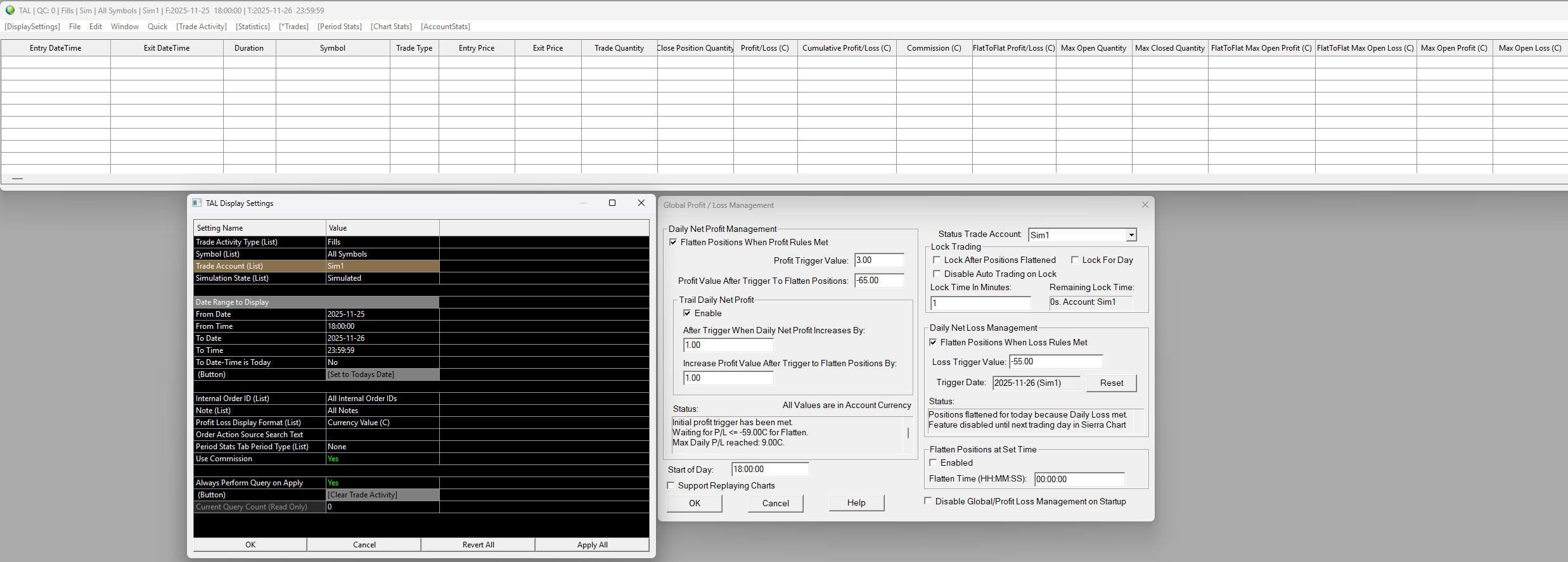

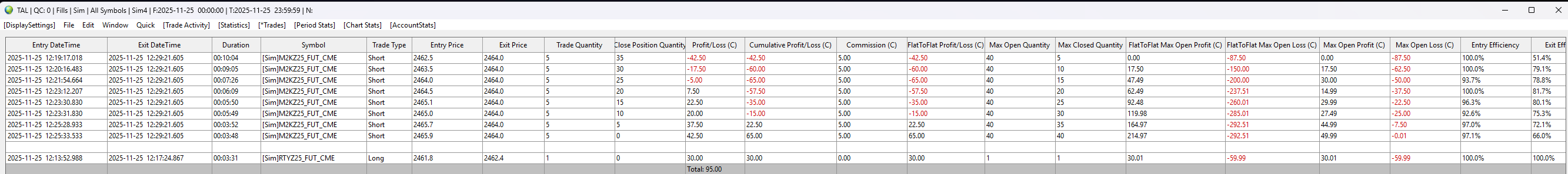

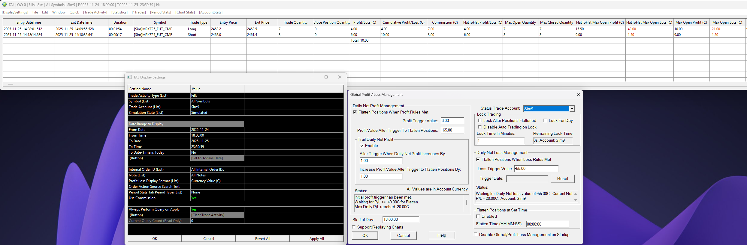

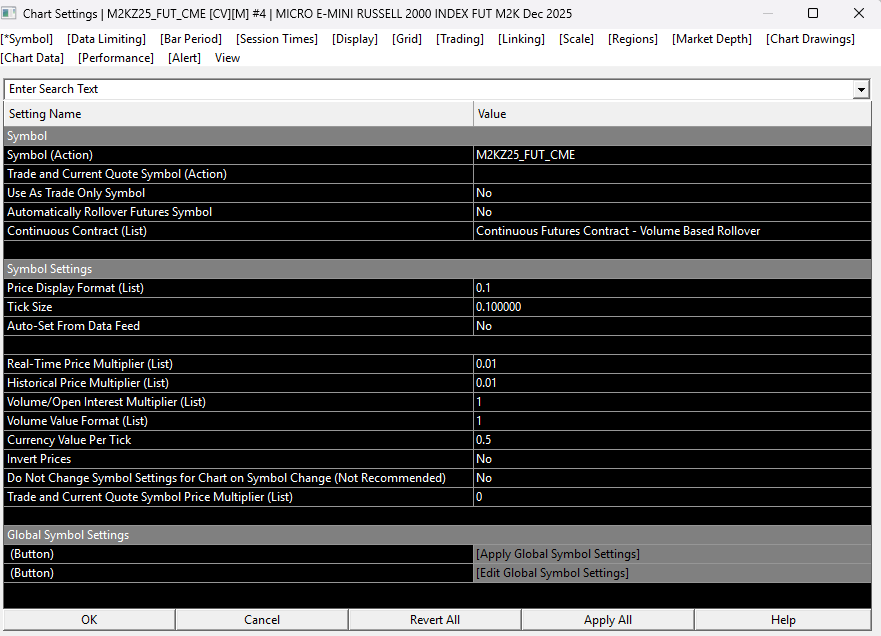

If I trade MNQ, the trade activity log and global profit/loss management correctly calculate at $0.50/tick ($2/point).
However if I trade M2K, the trade activity log correctly shows $0.50/tick but the global profit/loss management is calculating at RTY values of $5/tick not $0.50.
I can't see where/how global profit/loss is getting its values from.
How is it possible for Trade Activity Log to be correct but Global Profit/Loss be getting a different value.
imageScreenshot 2025-11-25 161444.png / V - Attached On 2025-11-25 15:25:32 UTC - Size: 140.14 KB - 104 views
imageScreenshot 2025-11-25 161508.png / V - Attached On 2025-11-25 15:25:53 UTC - Size: 43.26 KB - 105 views
[2025-11-25 15:38:56]
We would need to see the information as to why you are stating that this is occurring. There is no reason for it from what you show.
But, we do want to point out that the Tick Size for M2K (and RTY) is 0.1, so our first question is whether you are calculating this correctly or if you are using a Tick Size of 0.25.

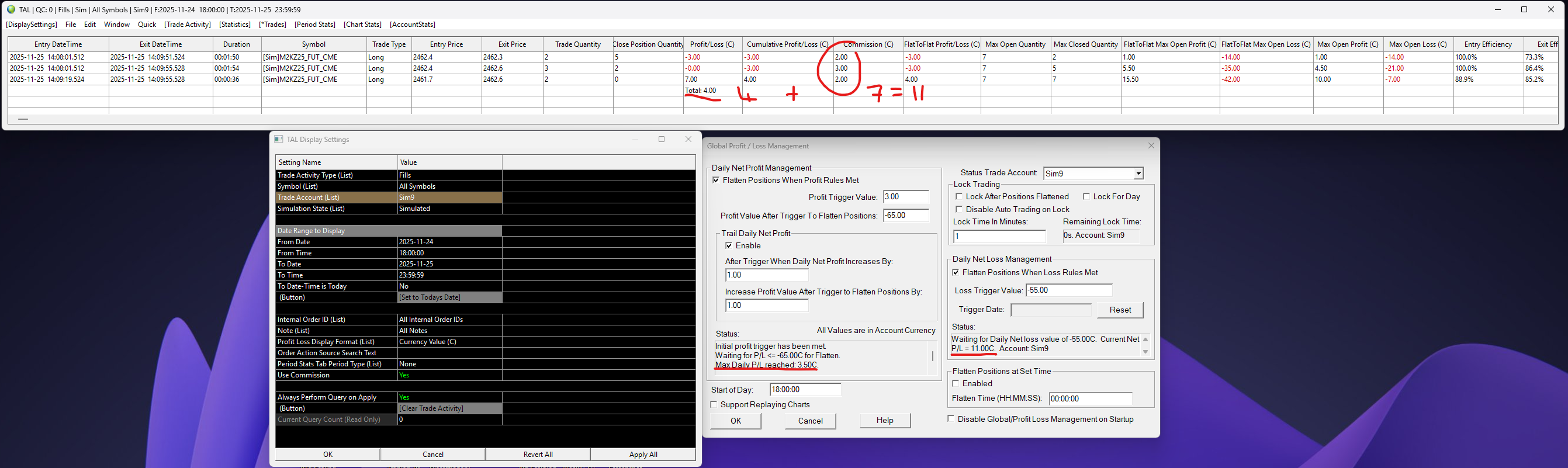

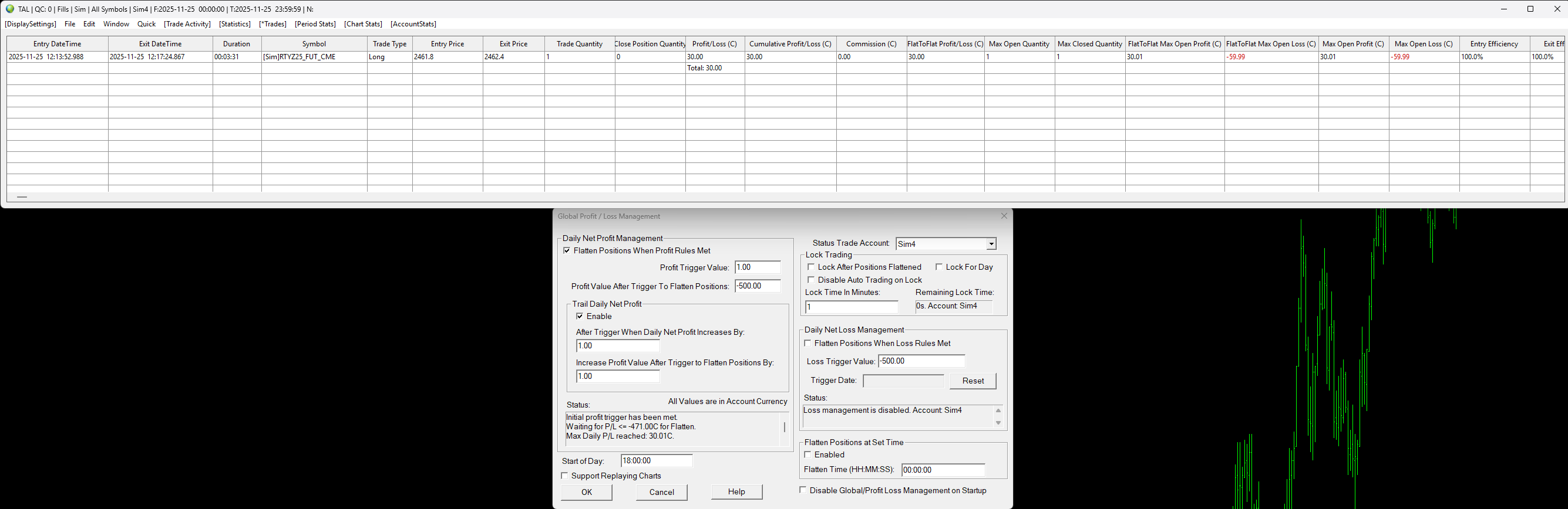

I created a new sim account (SIM4), made a trade in RTY and then M2K (micro RTY).
You can see from the 2 images that the trail PnL on Global Profit/Loss after the first trade looks correct,
but after the second its showing $65 which doesn't make sense to me.
The second trade I had to add to so I could get a profitable trade but all exits happened at the same time.
I'll post the non flat-to-flat display next.
Thanks.
imageScreenshot 2025-11-25 181756.png / V - Attached On 2025-11-25 17:36:20 UTC - Size: 87.93 KB - 111 views
imageScreenshot 2025-11-25 183012.png / V - Attached On 2025-11-25 17:36:31 UTC - Size: 94.03 KB - 110 views
[2025-11-25 17:47:49]
FuturesBod - Posts: 32

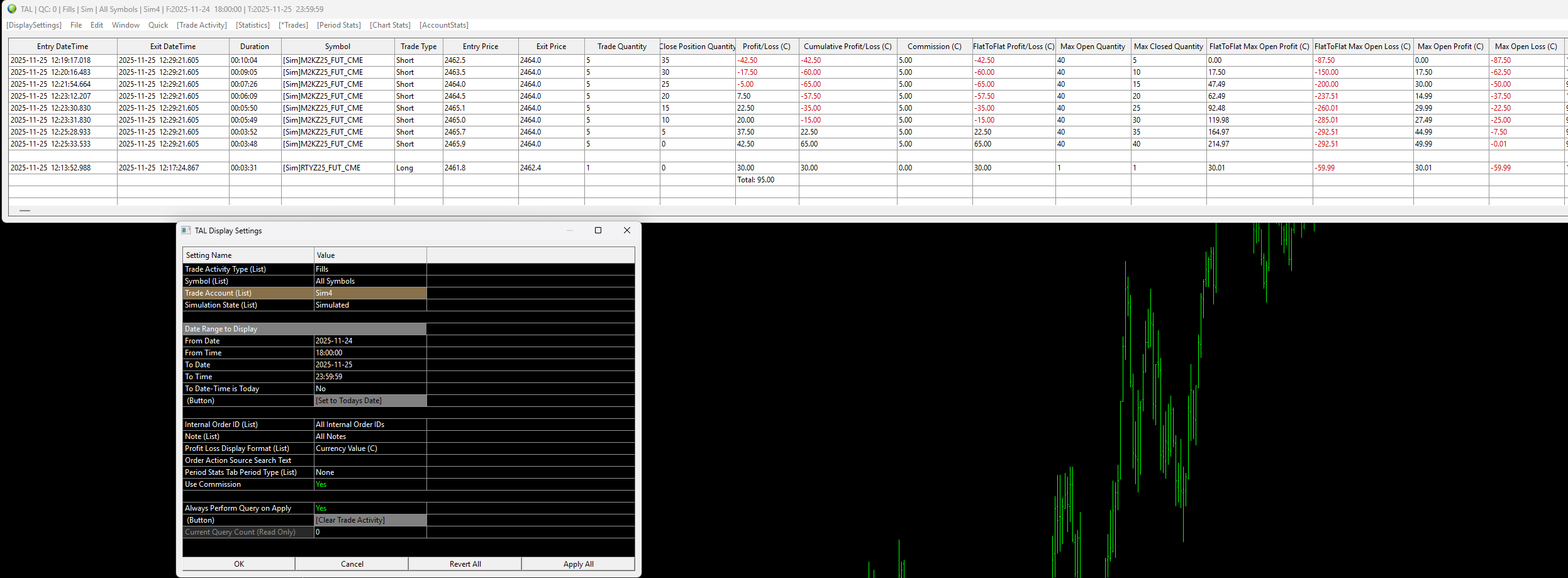

...and here's the trade by trade.
I just kept adding to the short until the average price came up so I could take it all of for a profit.
imageScreenshot 2025-11-25 184651.png / V - Attached On 2025-11-25 17:47:44 UTC - Size: 58.04 KB - 101 views

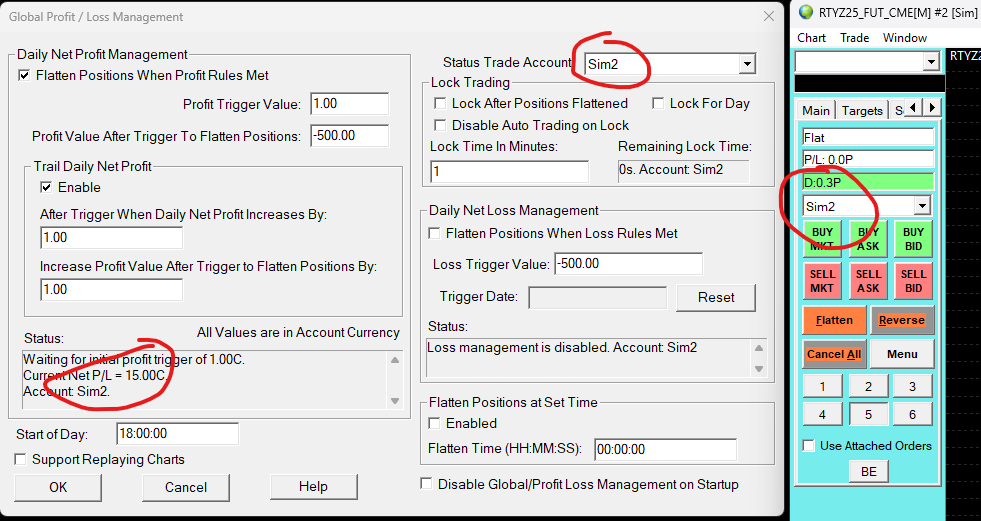

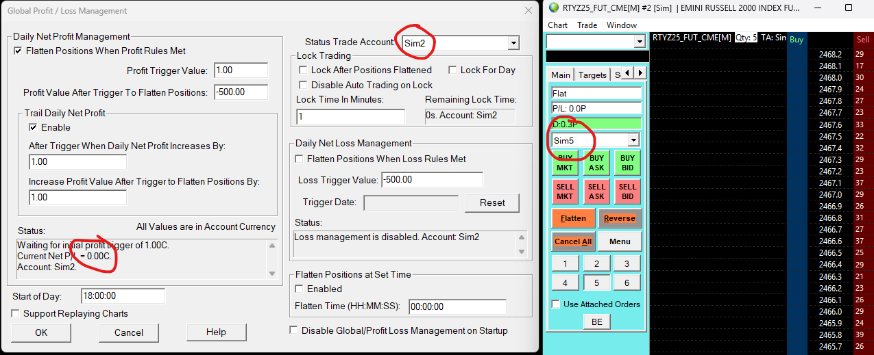

...and with these two images:
When I set the DOM to be Sim2 it shows PnL in the Global Profit/Loss to be $15.
But if I change only the DOM to Sim5, the value in Global Profit/Loss changes $0 even though Global is still showing Sim2.
I don't see why that should change. The $0 doesn't even apply to Sim5, so its not like its showing Sim5 but not updating a display.

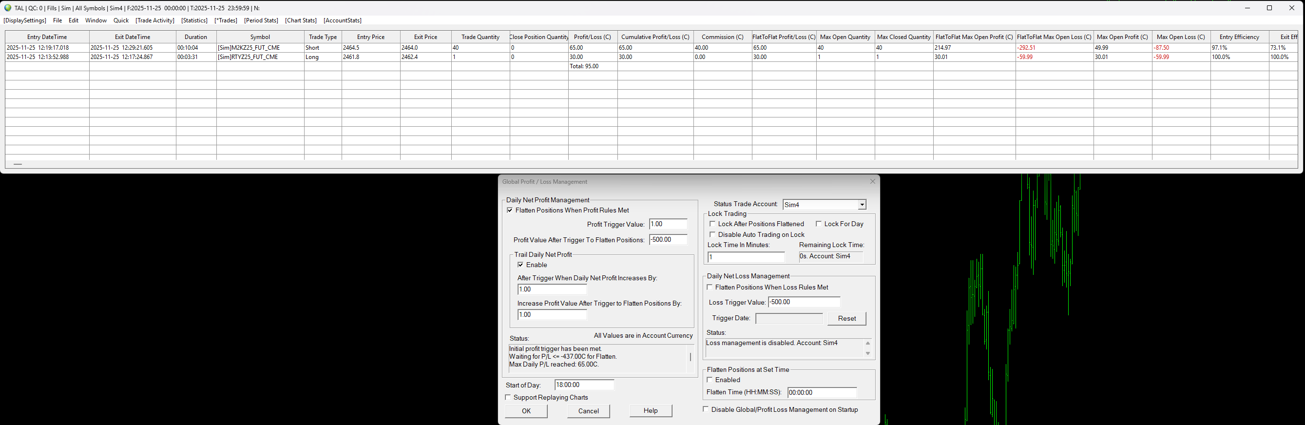

[2025-11-25 19:26:12]
I don't know if this helps but maybe its an update issue.
I did 2 trades, see each screenshot.
After the first trade, the right hand side Daily Loss Management updates correctly but the Trail on the left doesn't.
After the second trade they are back in alignment.
Related - it seems these numbers don't include comms which can add up for intraday traders.
Could we include comms or have an option to include comms since they are non-optional for us all?
Hope it helps and thanks for looking into this.
Date Time Of Last Edit: 2025-11-25 19:27:03

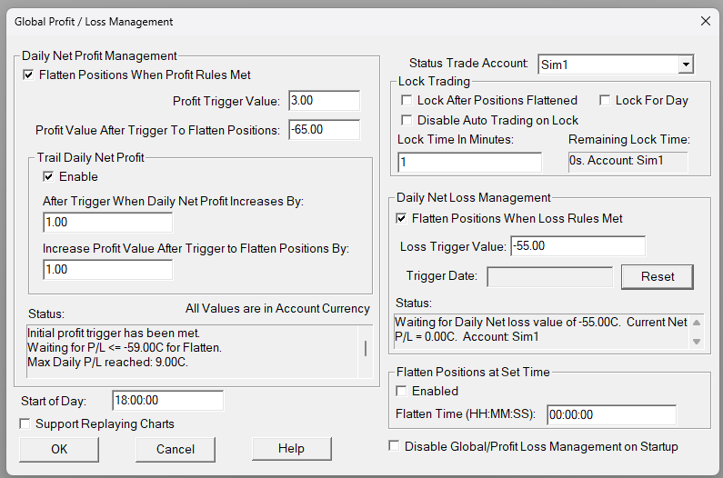

[2025-11-26 12:44:59]
So next day now (Nov 26th) and its not reset itself.
See attached image. No trades taken since 18:00 on the 25th.
If I hit Reset on the Daily Net Loss management then it does reset but the Daily Profit Management remains unchanged.
I think there is something broken here.
Let me know if you need anything further from me on this.
Thanks again.
