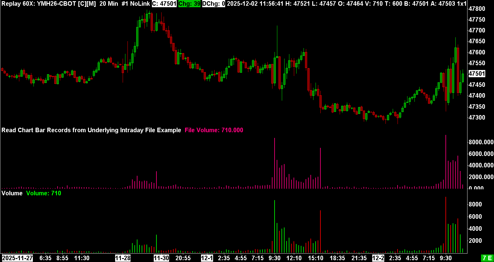

This test study, you can see in the second chart region shows no problems with this function, ReadIntradayFileRecordForBarIndexAndSubIndex, during a chart replay:
https://www.sierrachart.com/image.php?Image=1766879852880.png
It is reading, the correct file, and getting the correct volume. You can only read with that function historical futures contracts, during an active replay. Not when the chart is stopped and updating normally.

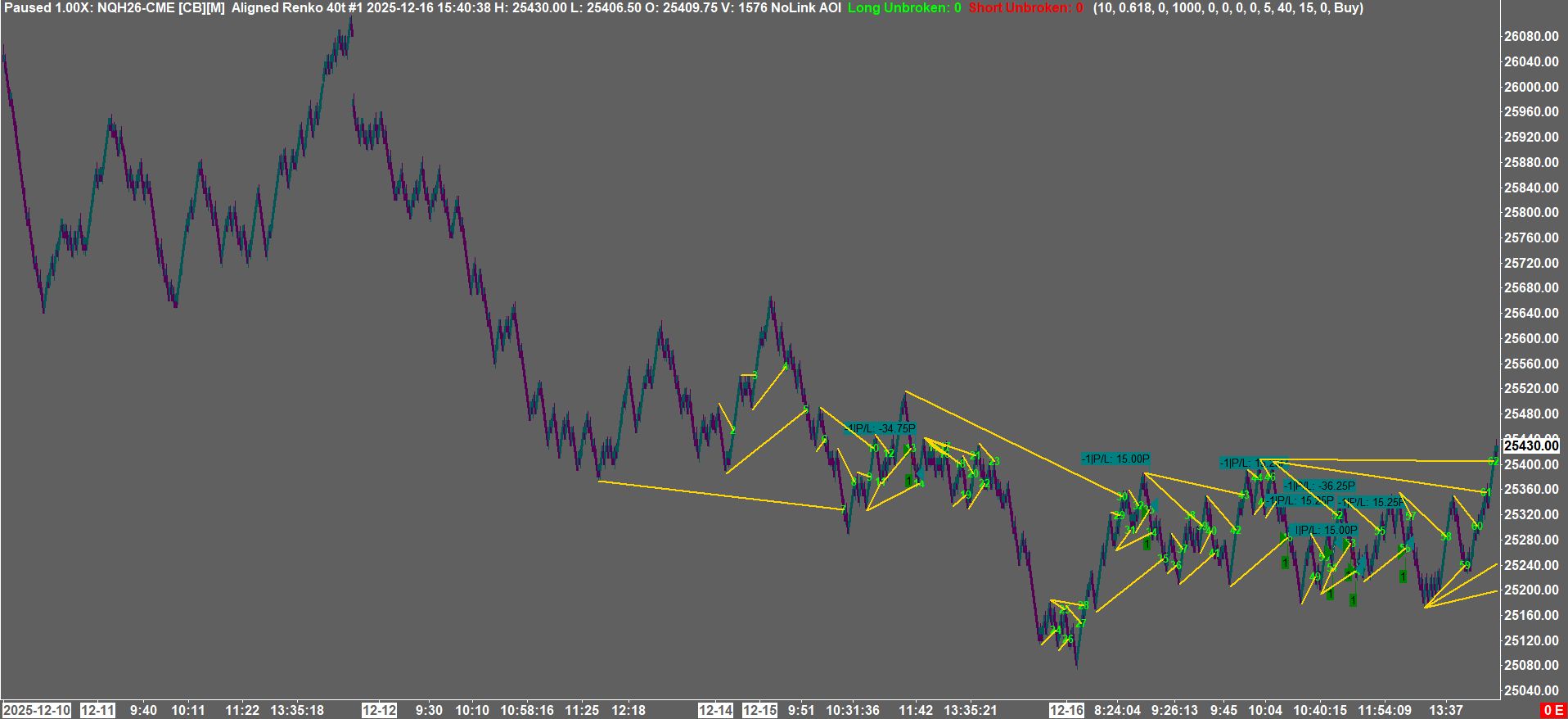

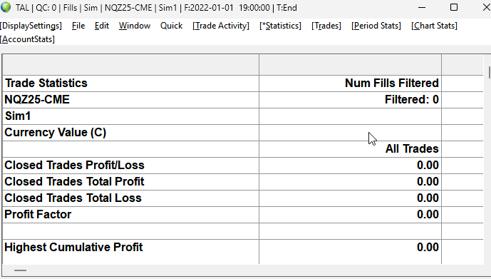

Hello, thanks. Ok then it must be the orders that are the problem. i just checked and bar based back test doesnt work. Neither does replay. No orders are placed. I enabled the order fills for multiple contracts in the Chart Settings. I checked the activity log - for Z25 contract there are 0 trades. Attached is the screenshot at the overlap of the NQZ25 and NQH26 - for both accurate replay and bar based backtest i get the same. i attached also the screenshot of the trade activity log for Z25 - i set the date range to display from 2022-01-01. for H26 there are trades since 15th of December in the activity log
