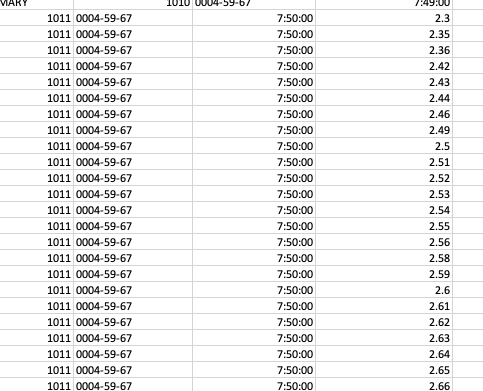

However, I can't get my system to "see" or "obtain" "seconds" values for VbP times (IOW's, I can get the system to see bar times in my 1-min candlestick bar chart and it can breakout VbP data (price and volume data) for every tick in the bar, but it is not pulling seconds in the time block for each tick level (HH-MM-SS per tick level - no "SS" being pulled)). Is there any specific setting I am missing here? I have the "Volume at Price Multiplier for Intraday and Historical Chart" set to "1". See the attached for explanation. The first column of numbers "1011" is the 1 minute bar being parsed, the next column is date (inaccurate so ignore for now), then time of the bar (no seconds values), then price for each tick of the bar)

How are you accessing this data:
Through this array?:
ACSIL Interface Members - Variables and Arrays: sc.BaseDateTimeIn[]
This will provide resolution to the microsecond.
