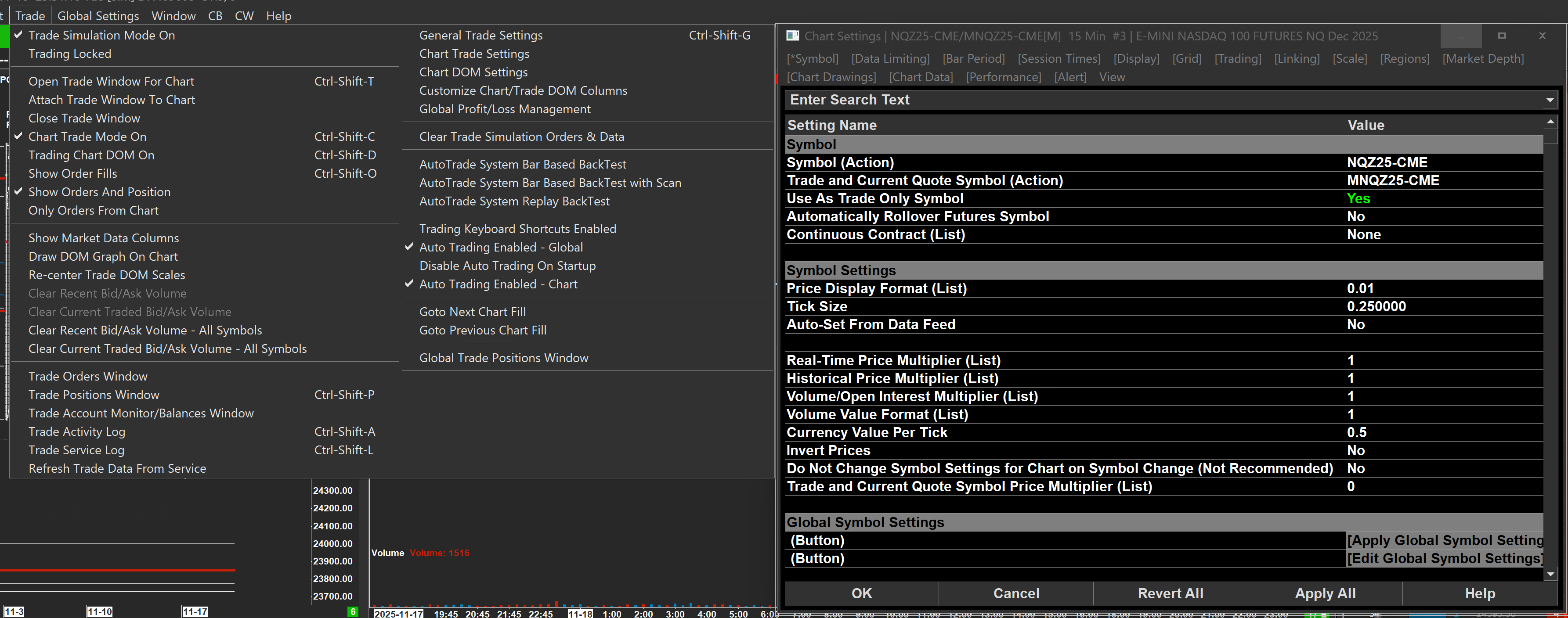

I'm experiencing an issue with sc.GetTradePosition() returning incorrect position data when using Trade Simulation Mode with symbol mapping (charting one symbol while trading another).
Setup:
- Trade Simulation Mode: ON (not using Trade Evaluator)
- Chart Symbol: NQZ25-CME/MNQZ25-CME[M] (charting NQ, trading MNQ)
- Trades are correctly being placed on [Sim]MNQZ25-CME as shown in Trade Activity Log
- Study using sc.SendOrdersToTradeService = !sc.GlobalTradeSimulationIsOn;
s_SCPositionData PositionData;
int result = sc.GetTradePosition(PositionData);
if (PositionData.PositionQuantity == 0)
sc.AddMessageToLog("No open position. Cannot add TP/SL.", 1);
sc.MenuEventID = 0;
return;

imageImage.png / V - Attached On 2025-11-18 23:51:38 UTC - Size: 574.16 KB - 161 views
