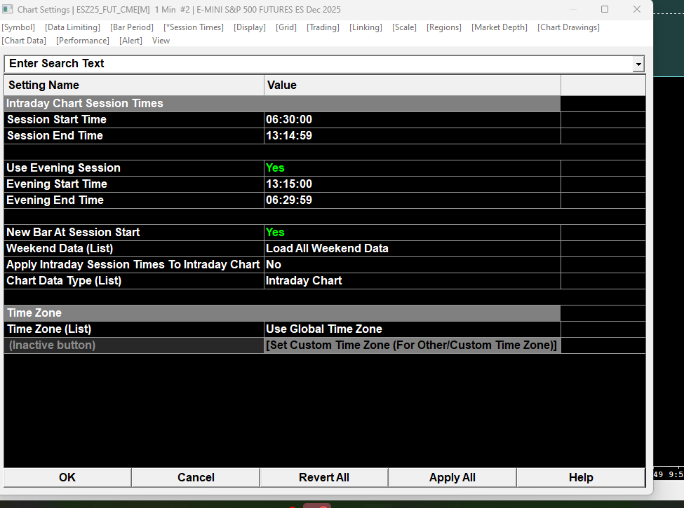

Adjusting my charts with the right start and end time for INtraday and evening session

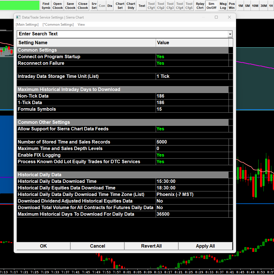

i messed things up because of the DLS, I messed with the start and end time with the intraday and evening session start and end times please i need help nothing is lining up with my other templates, this is causing me to miss my set ups and miss out developing my edge. Again I really need help if anyone can help me I would really appreciate it, thank you.
imageScreenshot 2025-11-18 092746.png / V - Attached On 2025-11-18 16:28:02 UTC - Size: 56.38 KB - 181 views
imageScreenshot 2025-11-18 092720.png / V - Attached On 2025-11-18 16:28:18 UTC - Size: 80.83 KB - 107 views

In the end, if you need the times in the chart to stay completely static and not have any changes to when things occur (i.e. the 1 hour break for the CME Group needs to occur from 16:00 to 17:00 every day all year long) then you need to set the time zone for your charts to be the time zone of the exchange itself. This way, the time is all relative to that location and you will not see changes in your charts.
