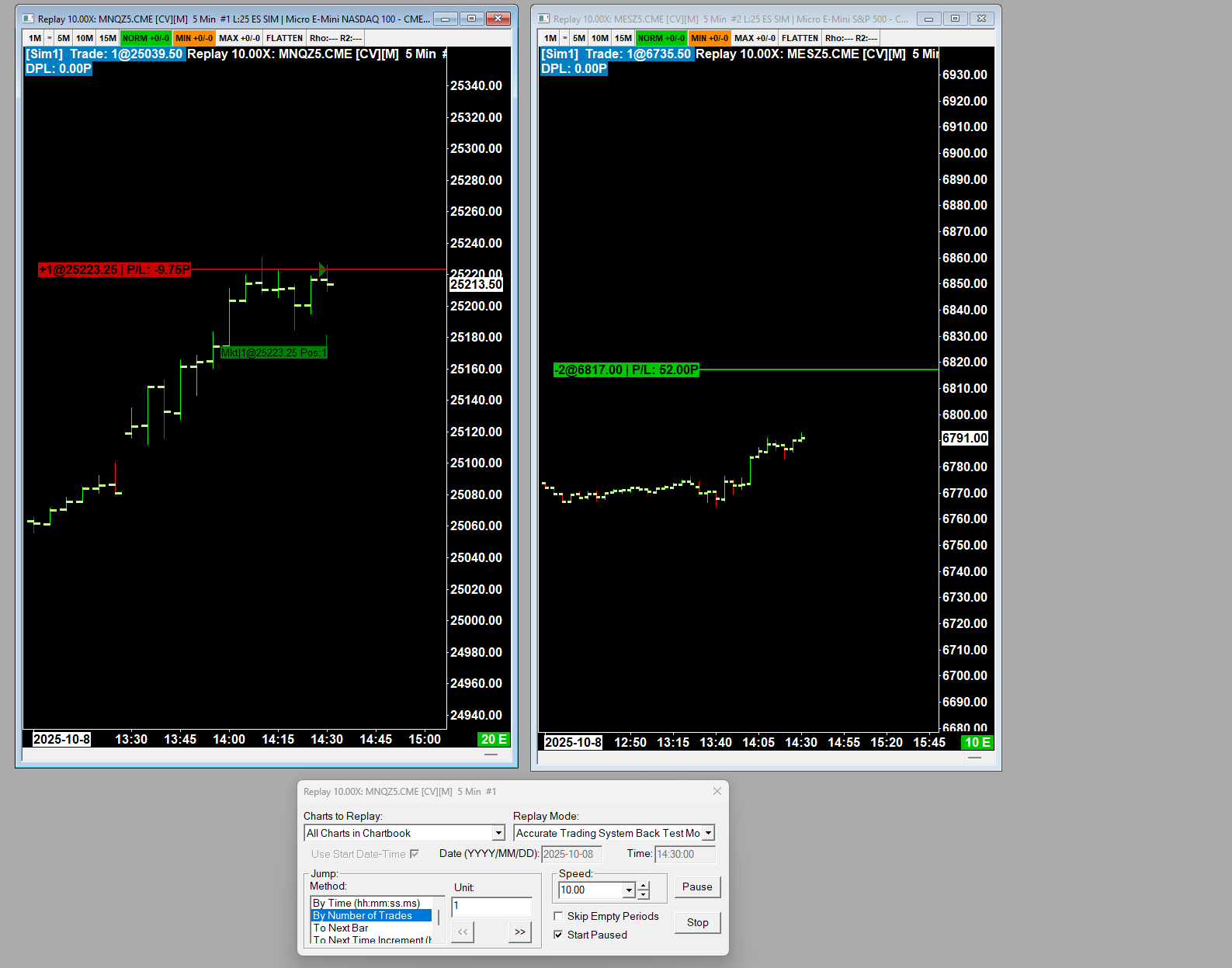

Summary
When running a replay involving two charts (for a spread or pair trade), orders submitted for the secondary chart (Leg X) are filled using the live feed price, even though the replay is active.
After the fill, the order’s PnL then tracks the replay feed, leading to a mismatch between entry price and subsequent price updates.
This makes backtesting unreliable because one leg follows the replay feed entirely, while the other uses a real-time price for entry.

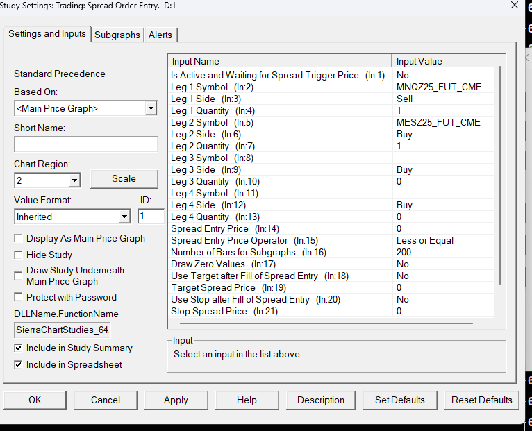

Setup
Leg Y (main chart): MNQZ5.CME
Leg X (secondary chart): MESZ5.CME
Study used: Trading: Spread Order Entry (built-in ACSIL study)
Replay Mode: Replay All Charts in Chartbook
Trade Simulation Mode: ON
Trade and Current Quote Symbol: not used
Behavior Observed
On Leg Y (the chart containing the study):
The market order is filled correctly at the replay price.
The PnL is tracked properly using the replay data. ✅
On Leg X (the secondary chart):
The market order is filled using the live-feed price, not the replay price. ❌
After the fill, the chart and PnL resume tracking the replay data.
Result: the two legs become desynchronized — Leg Y is replay-based from start to finish, while Leg X opens from a real-time tick and only then follows replay data.
Expected Behavior
Both legs should open and track entirely using the replay feed, without any dependency on the live connection.

Observed:
The SELL order on Leg Y fills correctly and tracks the replay feed.
The BUY order on Leg X is filled at a live-feed price, then continues under replay control.
Additional Test with Minimal Study
To isolate the issue, I built a minimal ACSIL test (attached documment).

What you see does make sense because when you are submitting an order for a symbol other than the chart the trading study is on, Sierra Chart cannot know exactly what other chart to use since there can be many charts replaying for that symbol.
So Sierra Chart simply uses the common data feed to fill the order. And on the fill, charts that are set to that particular symbol and trade account will receive the fill.
We are thinking if there is a solution.
