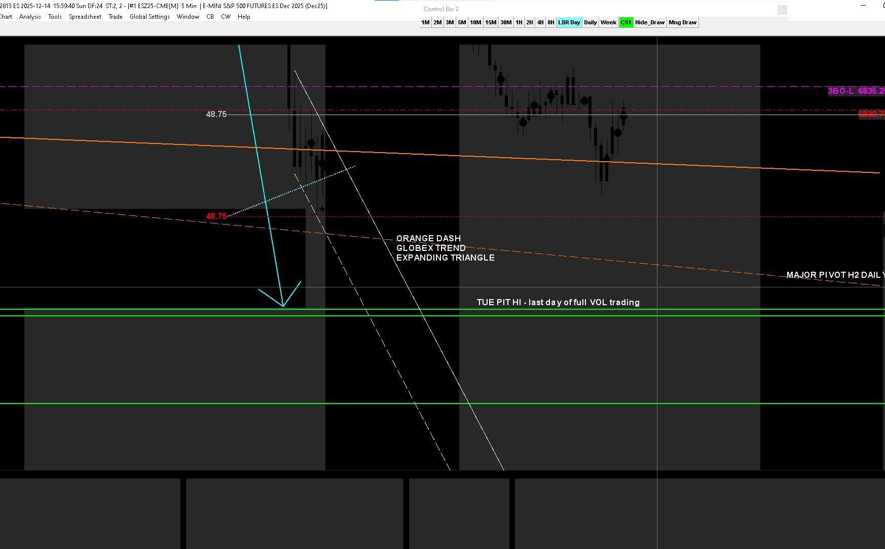

[2025-12-14 20:50:28]
Mike456039 - Posts: 54
2813 and latest quadro 582.08, this is all without chart trade mode enabled:
On my heavier graphics/studies chartbook:
without touching or moving mouse lots of these errors:
2025-12-14 15:42:25.716 | Graphics | OpenGL CALLBACK: ERROR type = 33356 (API), severity = 37190, message = GL_INVALID_VALUE error generated. Size and/or offset out of range.
once I move a rectangle the screen goes black (attached file) and then this error triggers
2025-12-14 15:45:22.152 | Graphics | OpenGL CALLBACK: PERFORMANCE type = 33360 (API), severity = 37191, message = Program/shader state performance warning: Vertex shader in program 20 is being recompiled based on GL state.
imageScreenshot 2025-12-14 204029.jpg / V - Attached On 2025-12-14 20:48:29 UTC - Size: 163.51 KB - 160 views
[2025-12-14 21:08:14]
ok sorry, ignoring the new MDI windows stuff then:
2833 and 582.08
OPengL - checked
Compatible Open GL Profile - checked
Enable OPen GL Debug - checked-
chart trade disabled
doing nothing
no OPEN GL errors
moving mouse around and panning charts around
-no visible erros blinking black etc but movement is very laggy
-no OPEN GL errors
rezising a rectangle/moving a text box
-screen goes black (attached file)
-but no OPENGL erros in log.
if chart trade mode enabled:
-Screen can be made to blink black -(exactly same as attached screenshot ) just by moving the mouse/cross hairs around
-but no OPENGL errors
Date Time Of Last Edit: 2025-12-14 21:17:05

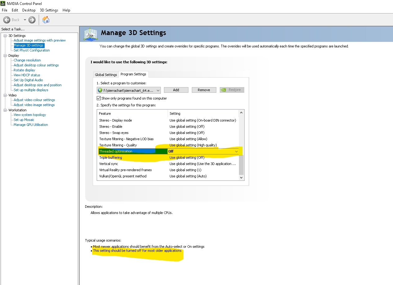

[2025-12-14 21:49:03]
Let us know the particular settings you are using that causes the issues, and do not cause the issues.
[2025-12-14 21:53:44]
BINGO!!!!
It is Threaded Optimisation in the Nvidia Quadro Control Panel 3d Settings
Default is AUTO
But when set to OFF - all the problems with blinking black screen are gone.
With threaded optimisation off, I cannot trigger the blinking/black screen problem no matter what I do, chart trade enabled, moving rectangles, loads of studies ete etc, nothing triggers the fault.
Problem totally solved, and its a configuration setting withing Nvidia Drivers/Control Panel. I'm assuming they changed default configuration after 572.60 - I will go check this now.

[2025-12-14 23:11:33]
We want to comment on the Threaded Optimization setting in the screenshot. It says:
"This setting should be turned off for most older applications"
Sierra Chart would not be considered an older application regarding OpenGL because it uses core-profile OpenGL version 3.3. Refer to:
https://learnopengl.com/Getting-started/OpenGL
An old application would be using:
In the old days, using OpenGL meant developing in immediate mode (often referred to as the fixed function pipeline) which was an easy-to-use method for drawing graphics.
We have to think about why that setting is causing a problem. We will do that.
