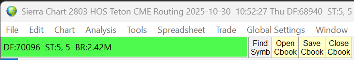

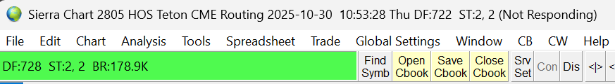

Installed v2805 and opened my chart book, 1 screen appeared to load...all others hanging on waiting for data. Not responding message on title bar.
No error messages I can see in the message log.
Roll back to v2803...all works as expected and charts load in timely manner.
imageScreenshot 2025-10-30 105239.png / V - Attached On 2025-10-30 17:57:55 UTC - Size: 15.44 KB - 193 views
imageScreenshot 2025-10-30 105355.png / V - Attached On 2025-10-30 17:58:04 UTC - Size: 17.71 KB - 215 views

My chartbook loads in about 20 seconds with v2803. Two charts loading 200 days of tick data seem to be the primary contributors.
Updated to v2804 and chartbook loads in ~20 seconds as well.
After repeated attempts, my chartbook did load with v2805 in just over 2 minutes.
I even saw a brief "Not Responsive" message from a chart I opened earlier this morning that had just 2 lightweight charts with 1 - 3 studies each and a DOM.
What I see on the screen with v2805 is one screen will partially draw, others are black and no price/time scales, bars, etc.
